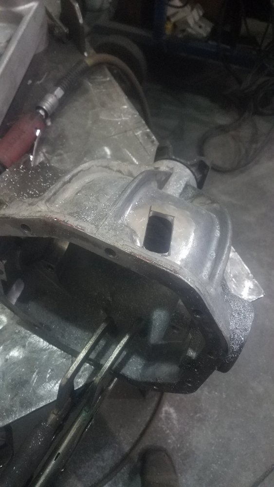

I have everything I need besides this pkg thrust washer to complete my rebuild of my dana 35 ttb off my 94 ranger. paint, new bearings, new bushings from dufftuff. new ring bolts(one was the culprit for causing the rebuild) and a fixed housing. wish I had the money to regear at the moment but coming up on Christmas an all. I would at the very least make sure its put back together properly. one diagram shows a thrust washer one shows just an axle shaft spacer followed by a thrust washer. I am assuming one is for man, and one is for auto locking hubs? does not specify. ( I have manual locking) any incite would be greatly appreciated.
Working outwards from the spindle, you should have the outer bearing, adjustment nut, washer with holes, lock nut, splined washer, snap ring on axle shaft. That's it for manual hubs. Auto hubs have a couple more pieces.
D28 axles have more parts as well - thrust washers and bearings, etc. I'm guessing that's what's in the picture you looked at but is not relevant for your truck.
thank you. yeah I found two different diagrams, so I wasn't sure. just welded up my housing today, haven't welded cast aluminum in a long time. but it turned out decent. held water for 20 minutes with no sign of leaking but I will still seal it with something

Nice weld job.
