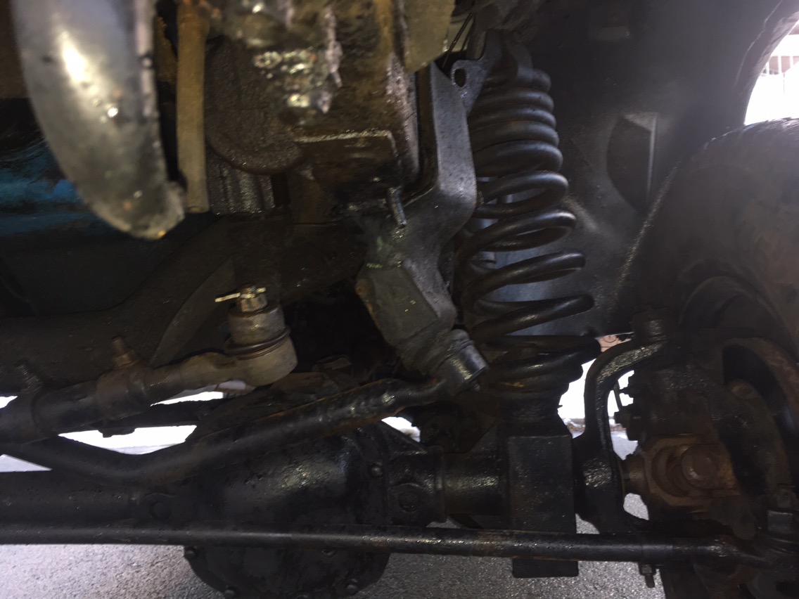

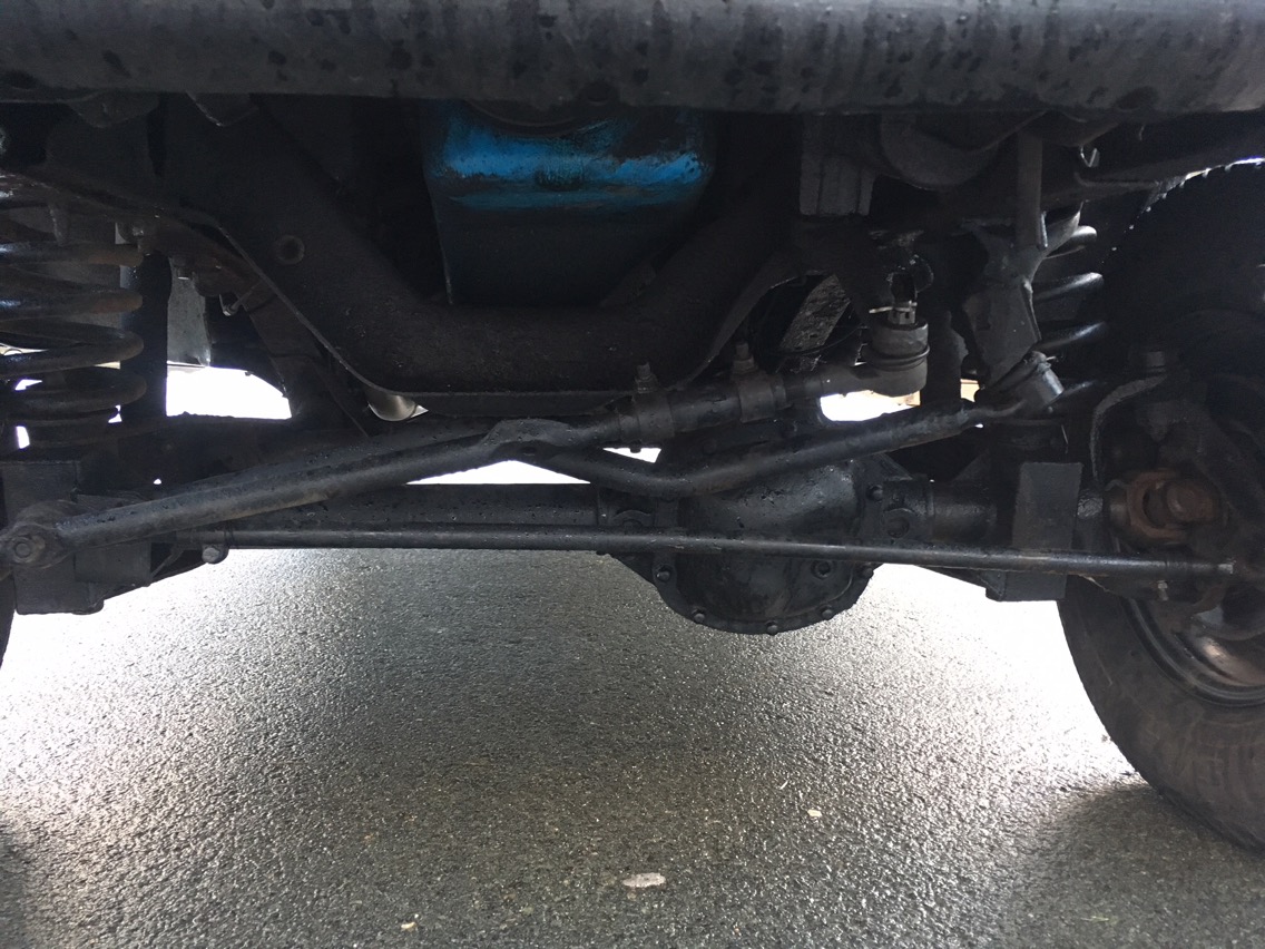

So I’ve got an 83 ranger, recently bought. The owner previous to me did an axel swap with the Dana 30 off a 97 Jeep. The track bar bracket is not welded square to the frame and is sitting quite off center, as I found out when I took it in for an alignment.
The old guy I brought it to says I need to find a new bracket off an old ranger, but I have the feeling the bracket I need to look for would be the one from a Jeep. Can anyone clear this up for me?

Hopefully this gives an idea of what’s going on. You can see how the track bar bracket isn’t welded flush to the frame, and is siding my coils to bend

What track bar and bracket would normally be used for a Dana 30 SAS?
that looks like a jeep unit to me.
ruff stuff sells a simple kit. I really like that place.
you could remove a section of lip from the k member and bolt some box to it and the lower frame rail, section out the box and use a standard bushing mount.
I use a regular ranger tie rod for a trac bar, but I built the brackets to use the tierod joint in the horizontal position and I put it behind the k.
but I also use a dana 60 and put the axle forward 3 inches.
with my style steering box I have more room to do stuff. with the factory ranger steering box and the underslung axle the trac bar is tight.

looks like it has oem radius arms hard mounted to the axle.
that's a potentially bigger problem then the janked up tracbar
Well that’s not what I want to hear bobby. Do I want to start looking for radius arms off a Jeep?

get pictures of the arms where they interface.
"potentially"
keep an eye on them and watch for cracks...damn thing may be just fine forever....or you may want to do some iron man arms or something with a better axle....
if I was running a jeep axle I would be dealing with iron man stuff or at least that style.
