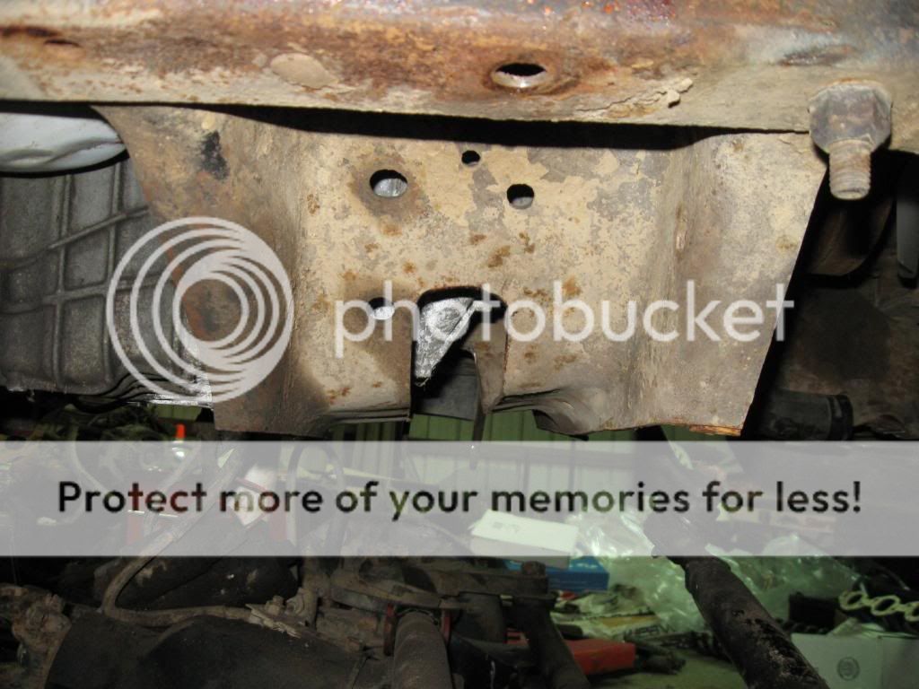

Made good progress this weekend. Got the rolled Ex stripped. Engine, trans, and t-case are out.
It'll probably take a day to mock in the engine and build motor mounts, massage the TTB crossmember, get my coil buckets re-installed, etc. Then hopefully install for good the next work day and fire some life into it.

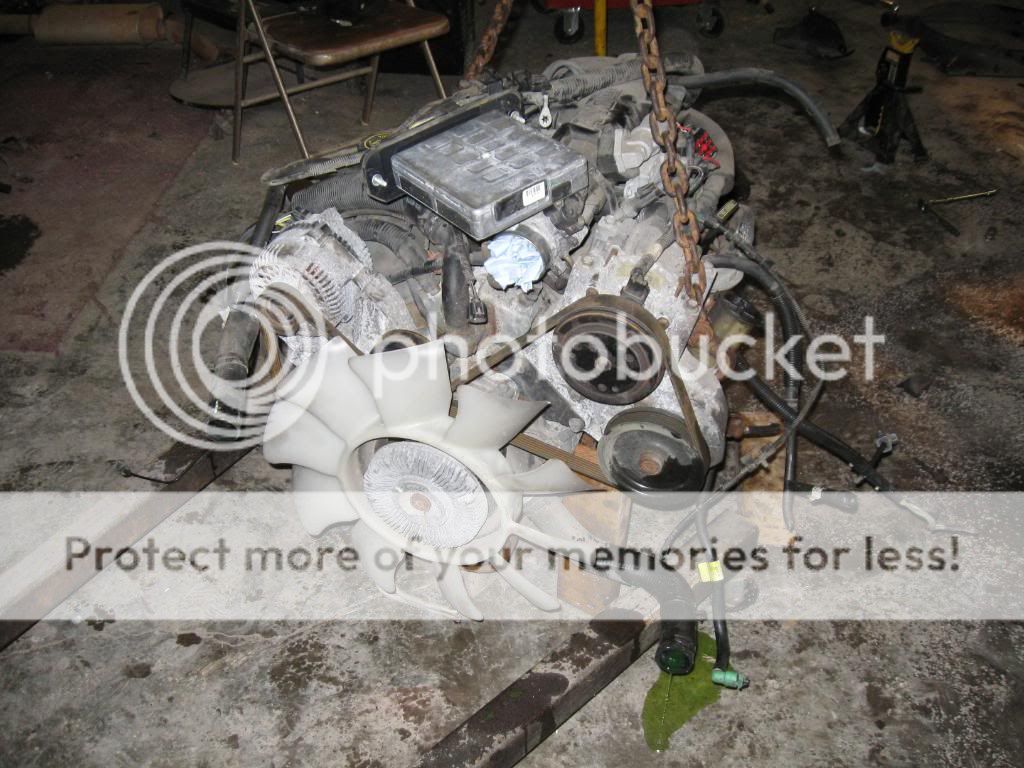

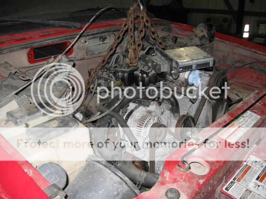

The 4.0 out of the exploder

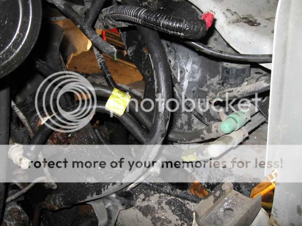

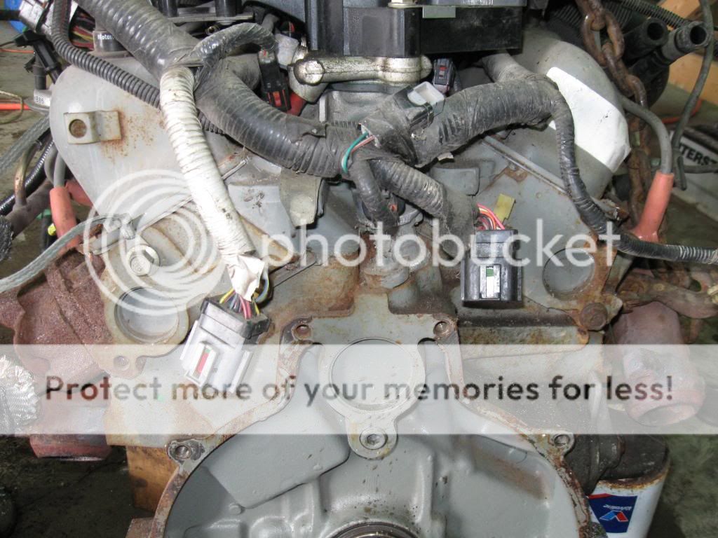

Everything seems pretty straight forward, except for a couple things. Vacuum lines. There's one that runs from the bottom of the throttle body to a deal just below the drivers side headlight.

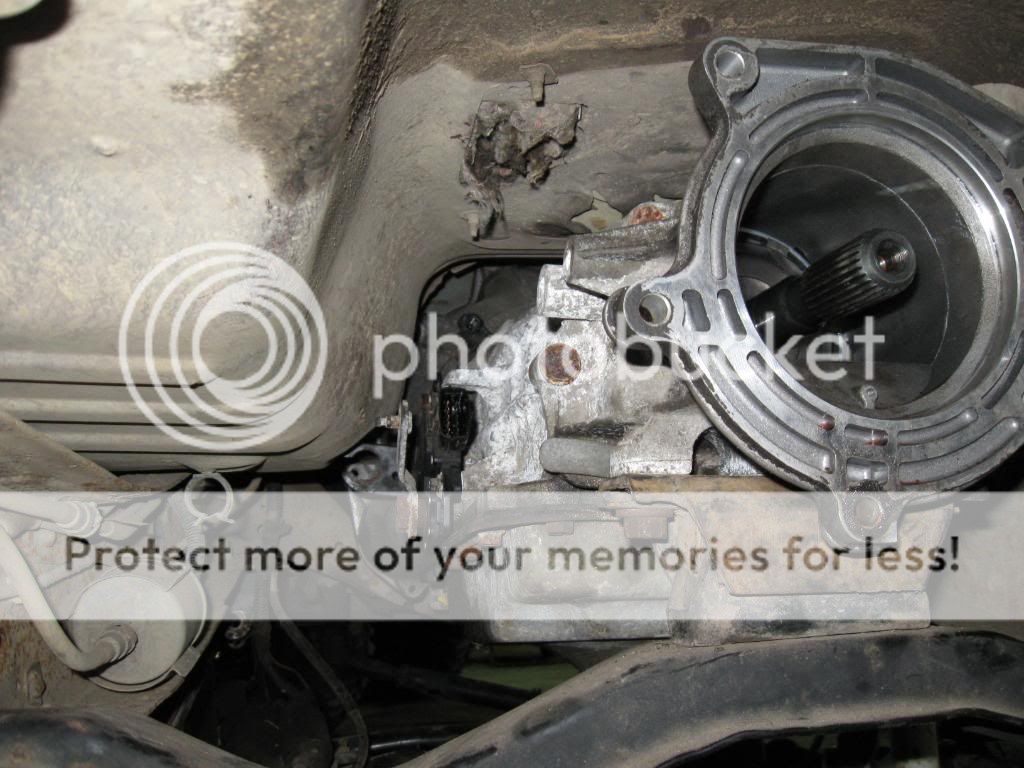

Its the one with the green clip. This is under/behind the driver's headlight.
Where that white one runs to, in case that helps anyone figure out what its for.

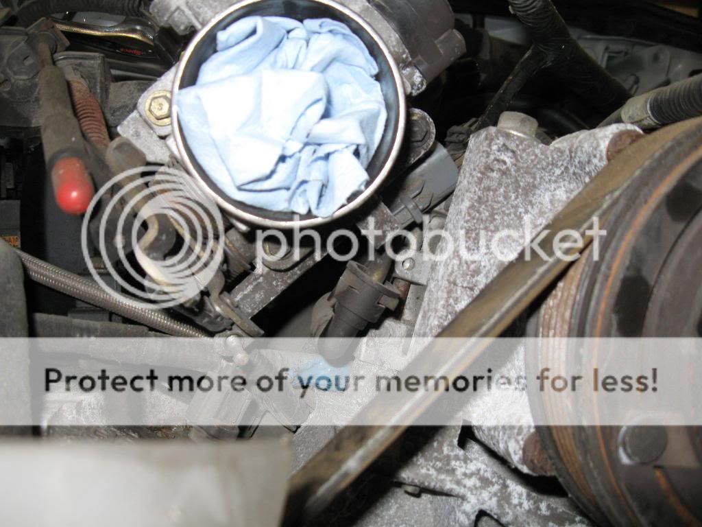

The one with the green clip runs up under the throttle body, and attaches with the black clip.
There was also another vacuum line that ran under the pass. side headlight, but I don't remember where it went on the engine. I'll have to check again tomorrow.
Also, my m5od trans harness plugs into the black plug fine. Won't fit into the gray plug. There's a gray plug on the auto's trans harness. Do I just plug the m5od harness into the black plug and leave the gray one as is?

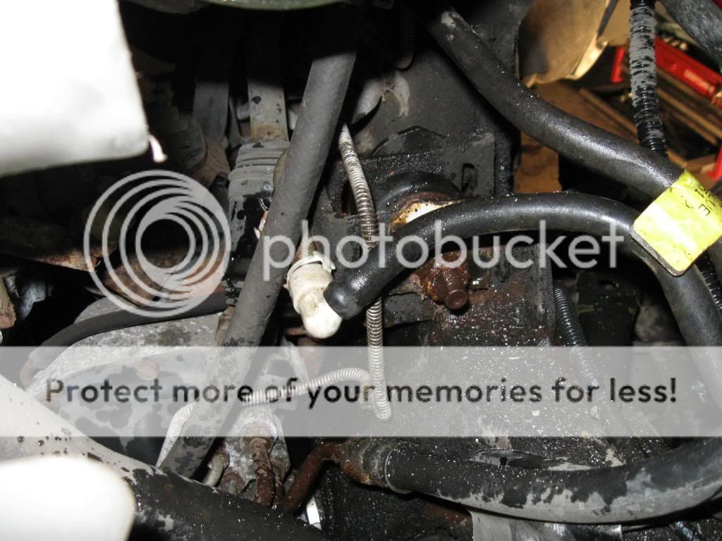

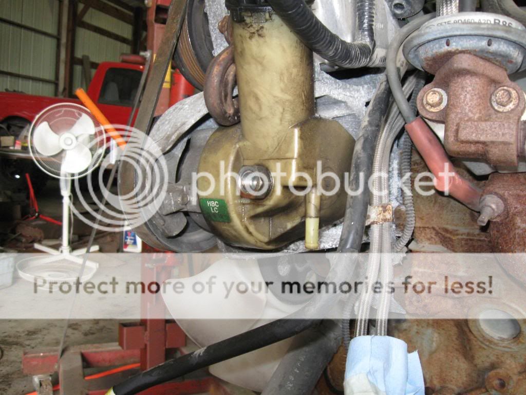

There's also a line that ran off of the bottom of the PS pump. You can see the fitting where it was on the bottom of the reservoir.
I'm pretty sure it ran to a cooler. Can I just plug that sucker? Don't want to have to find a place to mount the cooler/lines/etc.

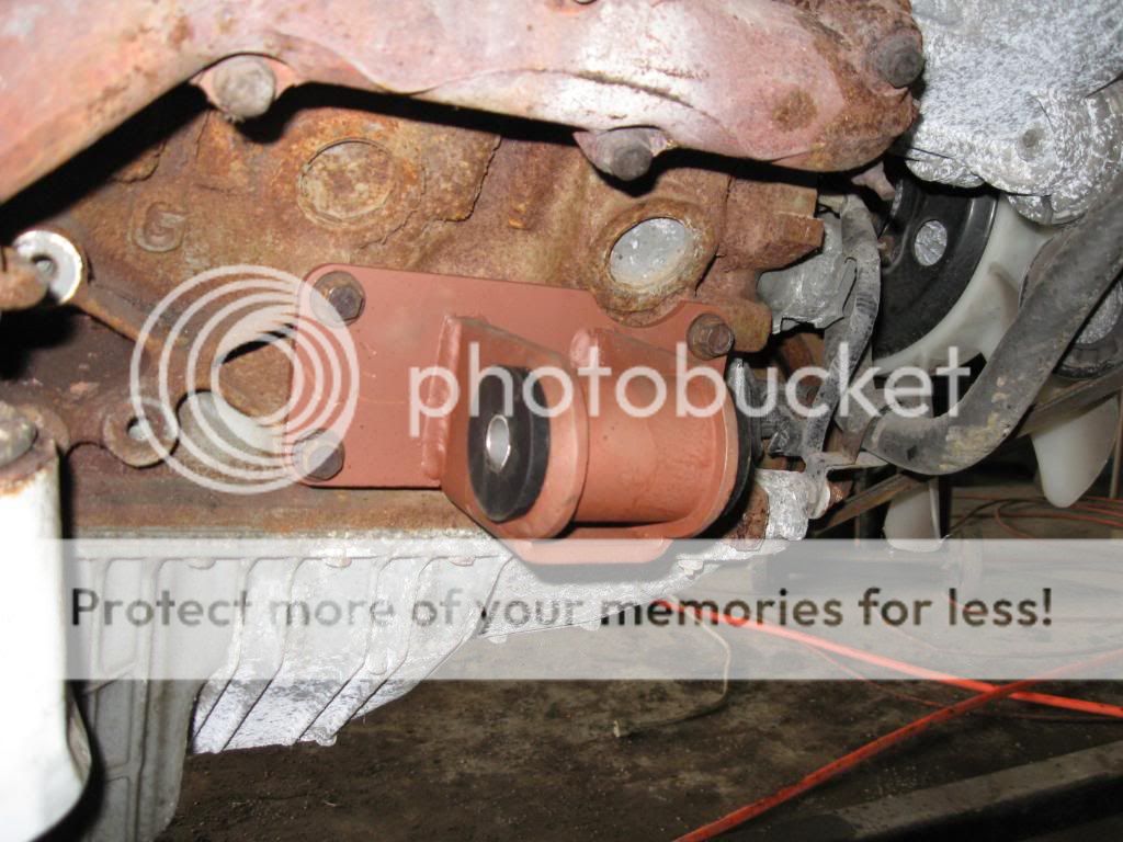

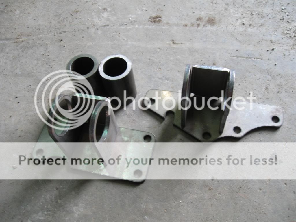

Here's the Ruff Stuff 4.0 mounts unwelded

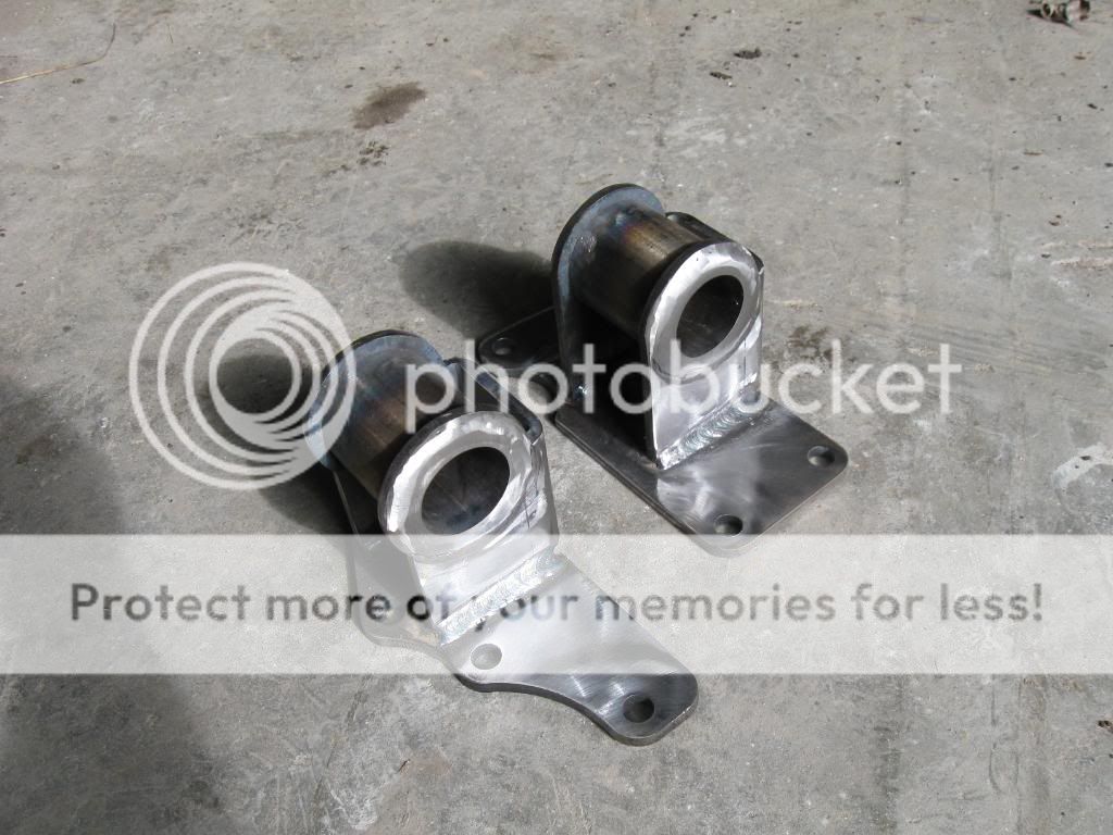

Thankfully I still remember how to weld. Its been a while haha. Like riding a bike.
Primed and bolted up

Any ideas on what to do with the vacuum lines, rear gray plug, and PS pump?
Those look to be EVAP lines. The nipple on the bottom of the PS pump is where the return line from the box goes to.
Holy shit, you posted pictures! And there is some great progress!
Yeah, the nipple on the bottom of the pump is the steering box return line, you need it.
The vacuum line are just emission stuff, I would plug em, it will run fine, but you might get a code. My truck didn't have those.
The plugs, I think one is for the rear lights, fuel pump, ect and one is for the interior stuff. I will go look at mine and check it out if you want.
Kyle, your truck is a different year and will have a different harness (OBDI vs OBDII)... That extra plug should be the harness for the electrical solenoids of the trans..Take the harness from the auto trans and dissect it to verify which wires you will need...

PS pump nipple is def the return line. I'm a dumbass.

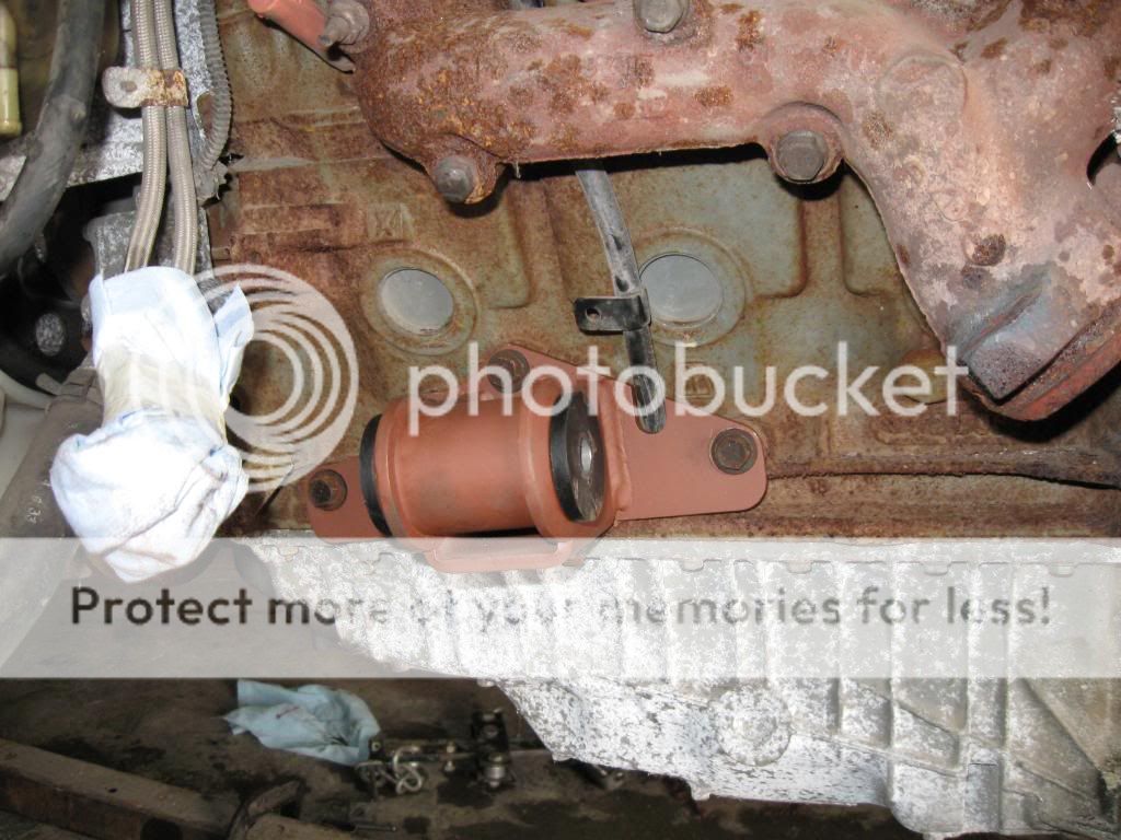

I mounted up the auto trans (will have my m5od back next weekend) to located the engine so I could build the mounts

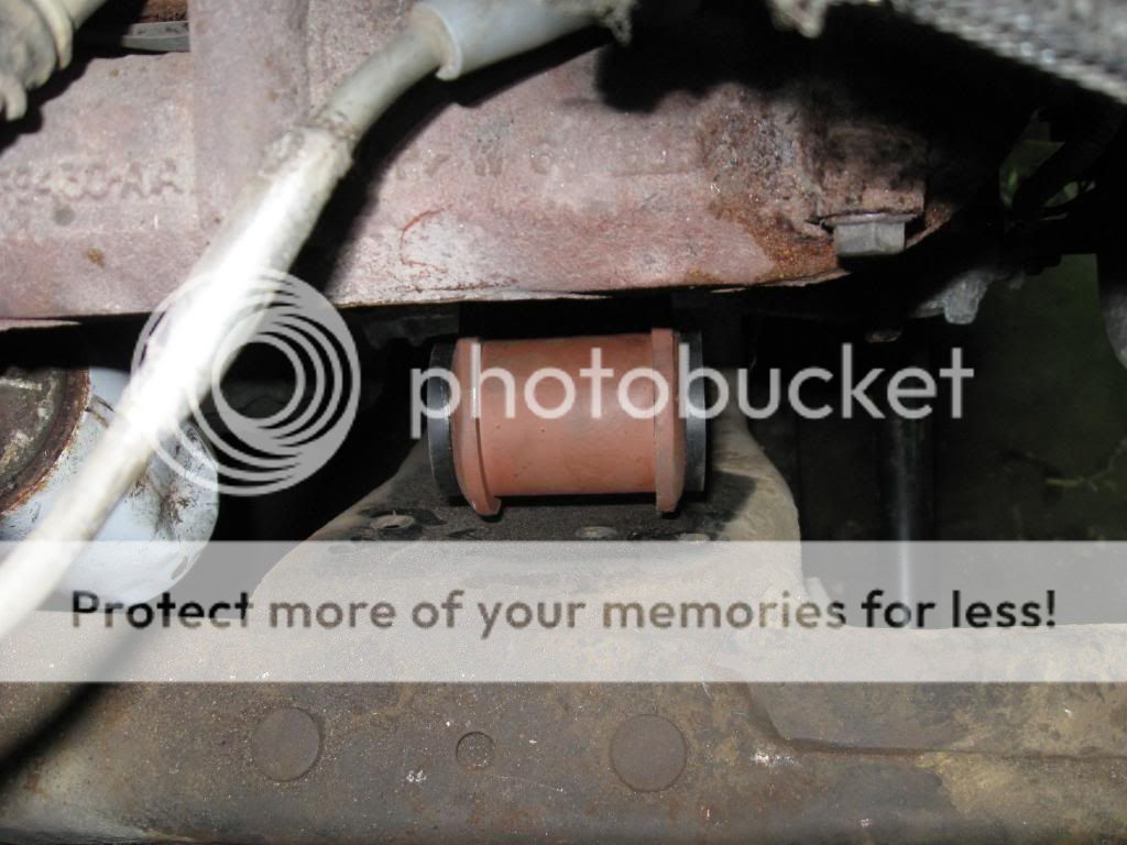

Passenger side mount location. Fairly centered on the engine crossmember. Looks good.

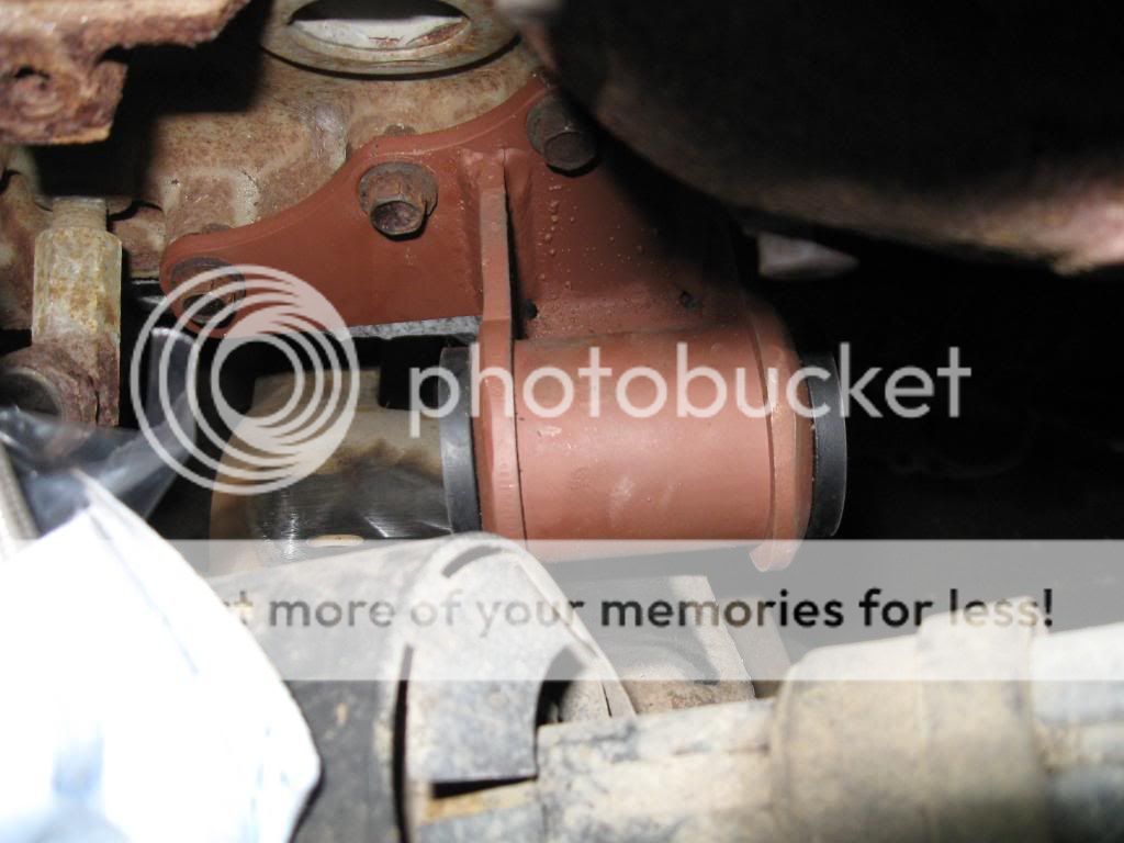

Driver's side mount location. Not so good. WTF. How does that happen. Its like 1/2 way off of the crossmember.
Plus I find this. This space is reserved for my track bar when my axle is under full compression. This is a problem.
So after finding that, I decided I'd better get the stock motor mounts to make sure the engine is in the correct location. Went to Oreilly's, had to order em. With the mounts, I can at least locate the engine in the correct position. May still use the Ruff Stuff motor mounts, I dunno.
If the engine is that far forward in the stock location (with the factory motor mounts), I'm going to have to build a new frame side track bar bracket and a new track bar. Damnit. 3.0 would've been too easy.
