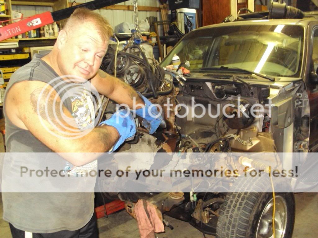

Yes. That looks attractive. :D
Here are a couple more....don't mind Jay's ugly mug:D

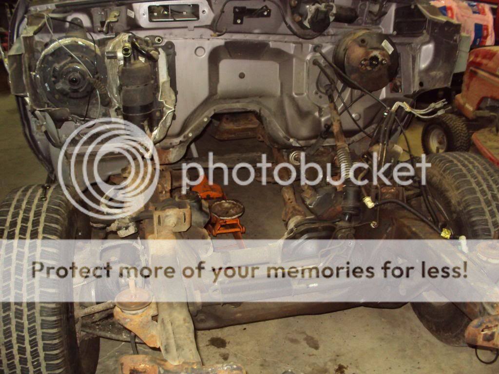

I need a bigger shop....
