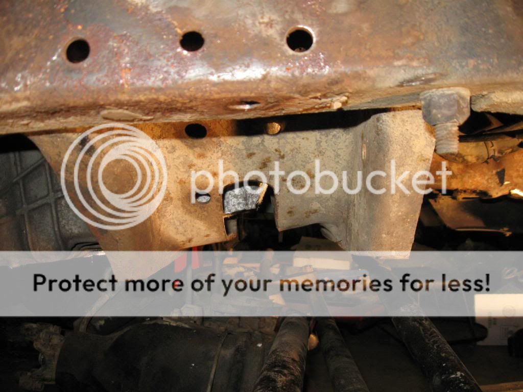

edit: just so its all on the same page, here's the pic of the oil pan/engine crossmember.

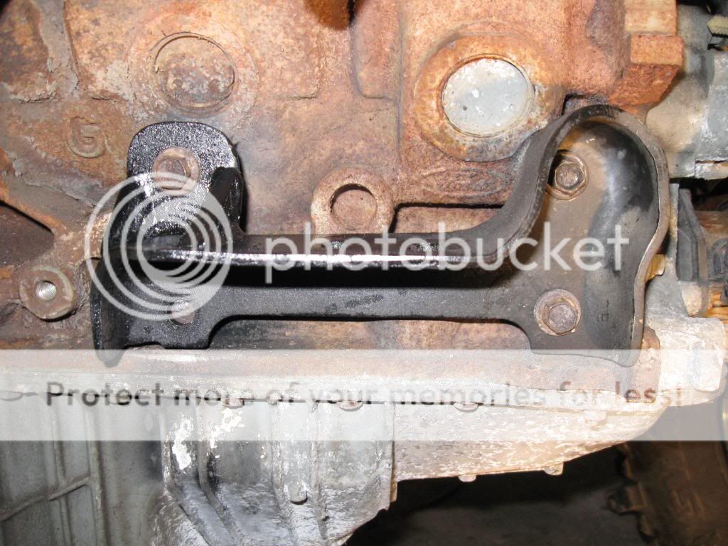

I picked up the factory motor mounts. I ordered ones for a 96 ranger with a 4.0. I figured that way they would fit my engine crossmember for sure, and a 4.0 is a 4.0 so they'd fit the engine as well. Turns out the explorers without ttb have different plates that go in between the engine and the motor mounts. I mounted the MM to my engine crossmember, then put the engine in with the ex. plates on it. Didn't work.
It dawned on me that the older donor I had before had ttb, and a 4.0, so I dug through my parts pile and found the plates that were on that engine. Went to remove the plates on the ex. engine, and broke a bolt off inside the block. Tried the 'weld on nut' trick like 6 times. fail. tried to drill it. fail. So I just decided to mod the plate so it bolted to another hole on the block instead. Fabbed that up (looks like shit - whatever) and bolted it on.

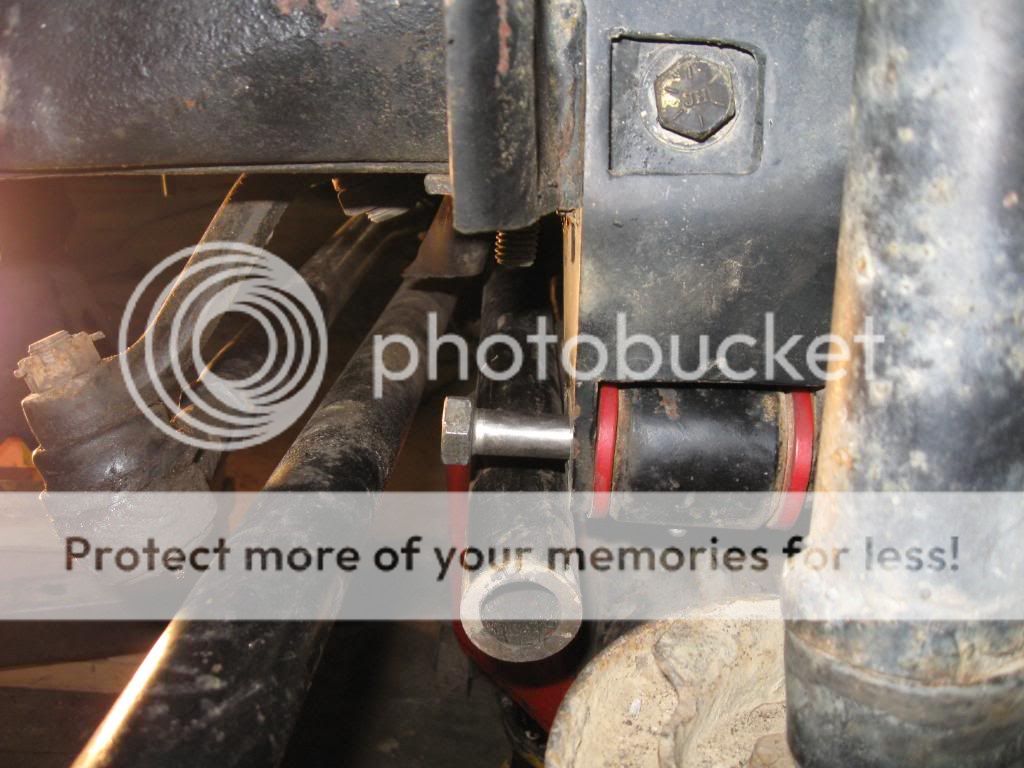

Then lowered the engine in again and checked trac bar clearances. Engine placement sitting on factory MM's.

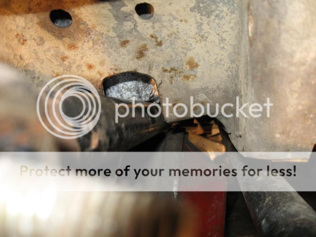

Straightened out trac bar. Hits both the engine and the top of the diff at the same time.
