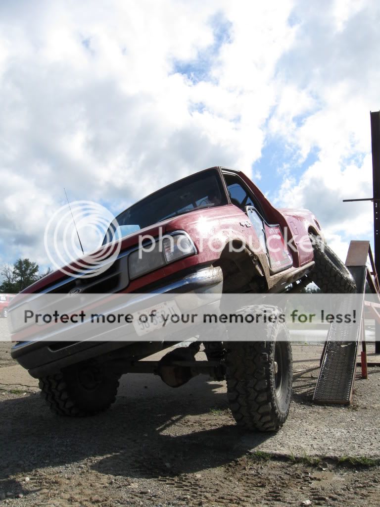

Updates, yeah. Added a tab off my shock mount that runs to the top of my frame rail, and added a verticle gusset that runs the length of the shock mount to the upper tab - if you follow that haha. aannddd did some wheelin. Went to Chubfest last weekend with a couple buddies.

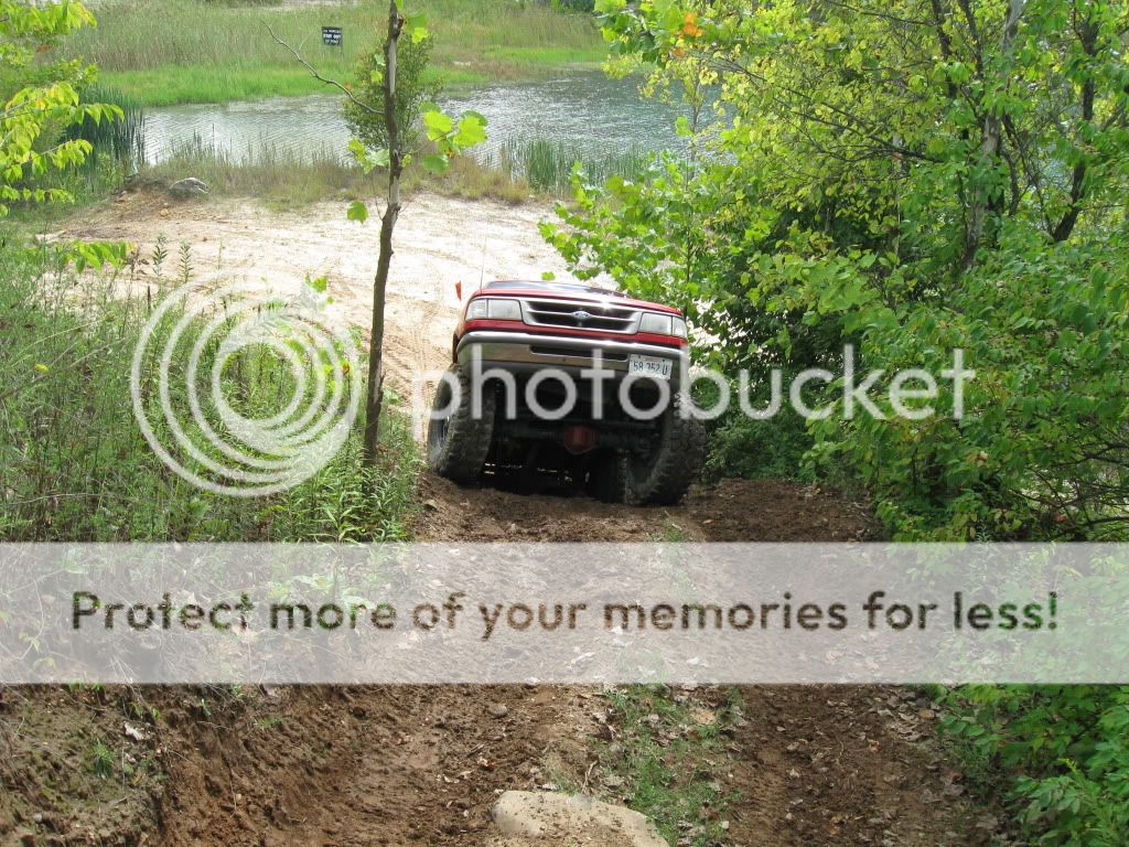

Thanks guys, its getting there. There's still a couple things I'd like to tweak with the SAS, but it does well on the trails. Its a great feeling when you all convoy there and you're the only one not on a trailer, then you convoy home you're the only one not broke :D

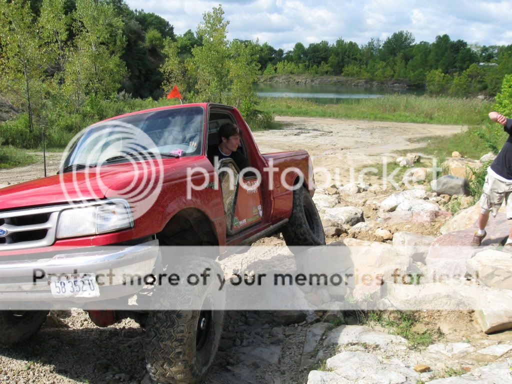

No brakes, the camera man wanted me to have my parking lights on for some reason. Watch the 3rd brake light. I do ride the brake coming off of larger rocks sometimes though, so the drop isn't as harsh.
Bray I would like to meet up with you one of these days and look at your doors. I need to finish my SAS on my 88 and then I want to be able to take the doors off. I just want to see how you did it and go from there.
Thanks!

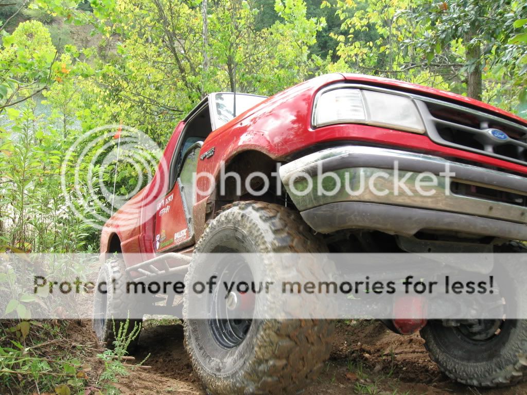

Brett - its super simple. I just cut the pins that the door hinges on, and drilled out the holes so they accept a bolt (the holes on the door side of the hinge are a different size than those on the truck side of the hinge). I cut the threads off the bolts and turned alittle groove in em to accept a c-clip. Easy on/off. just pull the clip, unplug the wire harness behind the kick panel, and slide the pins out. I can swap doors in ~15 minutes. You can check em out at the bog sept 26th if you plan to be there, if not I come through Pekin everyday. Not at the woodshop anymore so we'll have to set up a time.
