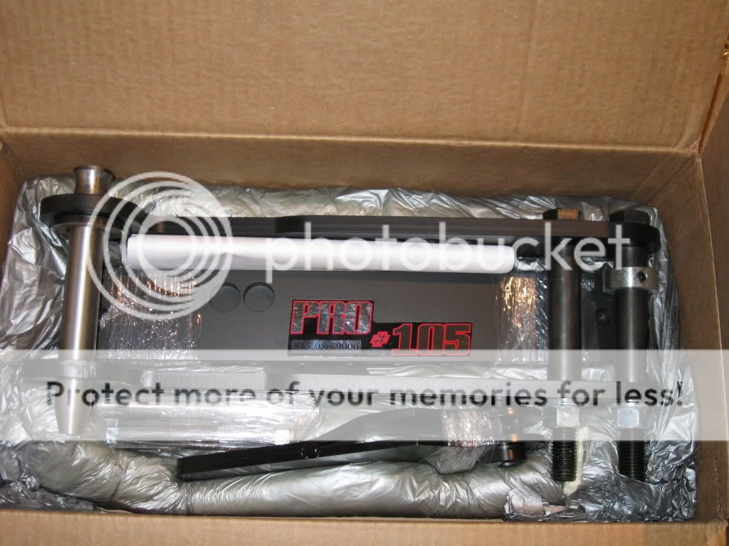

Pro Tools 105 with a 1.75" x 6" CLR 240* die, degree ring, stand, and extended handle.
Can't wait to bend some real tooooob!
