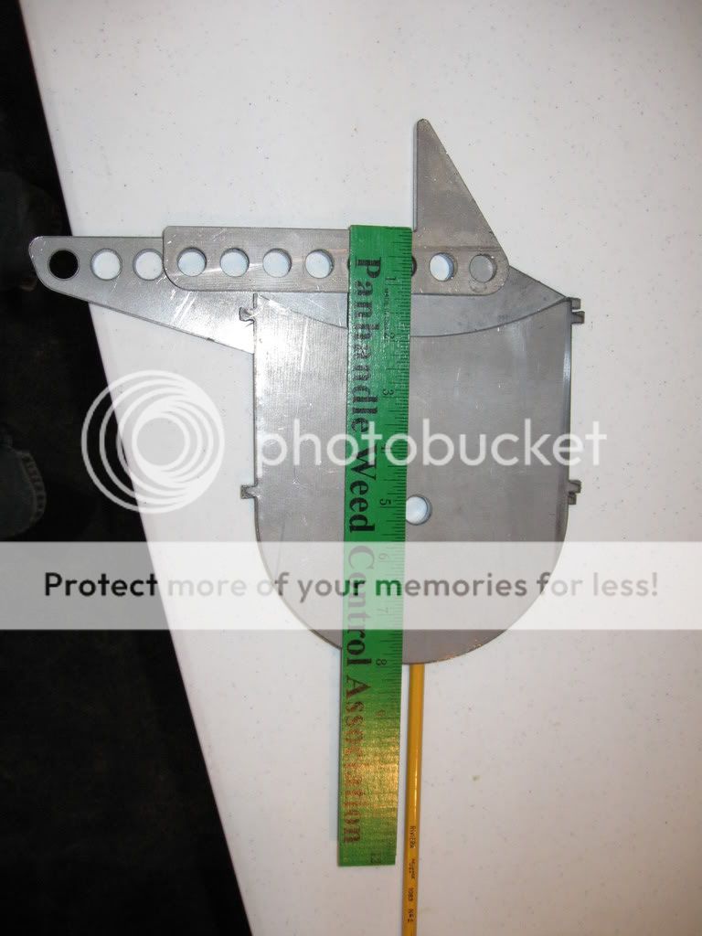

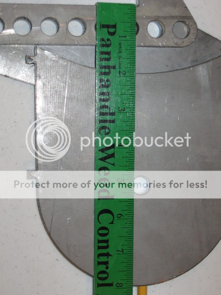

The center of the spring (the bolt hole for the retainer bolt) on those Ballistic upper spring mounts. I'm thinking that might be what I need to upgrade to in order to use a longer free-length spring. I just don't want to push it out away from the frame any farther than it is now so I wont have to change the lower mounts.

Can do my man. I'll go measure it now. The parts are "keyed" for allignment during assembly of the spring tower. I haven't welded em up yet. I'm going to measure my lower pad width (pad to pad), then weld up the brackets accordingly.

The pencil is for balancing purposes. They're damn near right on 5 1/8" from the center of the hole to the edge of the plate that mounts to the frame. It looks a little off due to the hole not being in the center of the picture (see aligning tabs at the top, they were aligned perfectly for the pic).
Thank you very much Sir. Looks like about 2" larger offset than what I'm using now. Right now, the frame is tangent to the 6" tube used for the coil bucket. So 3" radial offset. Back to the drawing board....
