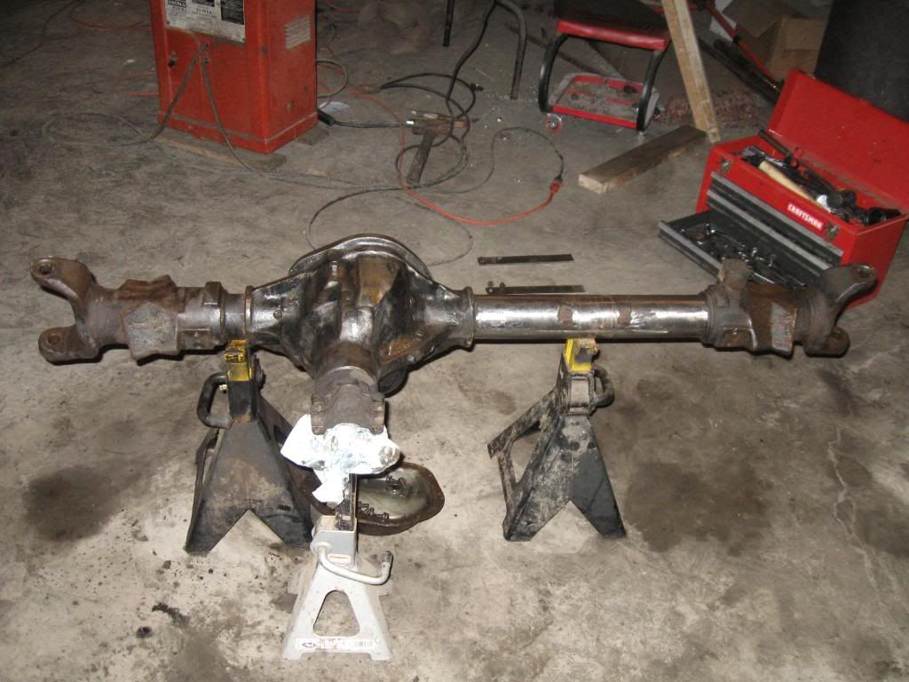

I narrowed it tonight, I'll weld it up tomorrow. It should come together pretty fast after I install the gears/locker.
full width

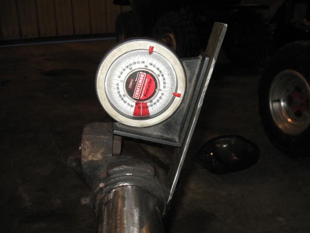

daily doubler build
added plates to measure caster
daily doubler build
made the face of the diff vertical for reference

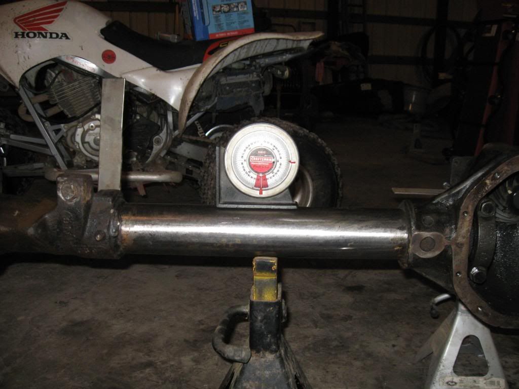

daily doubler build
levelled the axle on the stands
daily doubler build
and measured both driver and passenger side caster for reference
daily doubler build
I also measured the width at 3 different places so I could compare results after I cut it

I'm pretty pleased with how smooth the process went. I hope I can say the same after I try and weld it tomorrow. I've done my research, and spent WAY more than I had planned on welding rod - so it'd better work lol.
