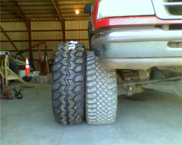

They're 35x12.5 SSR's. Chubby was running a 3 day special over halloween, buy 3 get one free on any tire, any size. I got all 4 to my door for $950. They measure 34.5 unmounted. Seems my 33's have shrunk (measure 30.75 with my truck weight on them).
I was having a hard time deciding whether to get a set of 'real' 33's or go ahead and bite the bullet and get 35's (I'd want them eventually anyways). I went ahead and got the big boys. I figure I might as well get em, and get my suspension built the way I want with the tires I want rather than getting 33's, setting up my suspension, then steppin up to 35's and having to rework everything.
