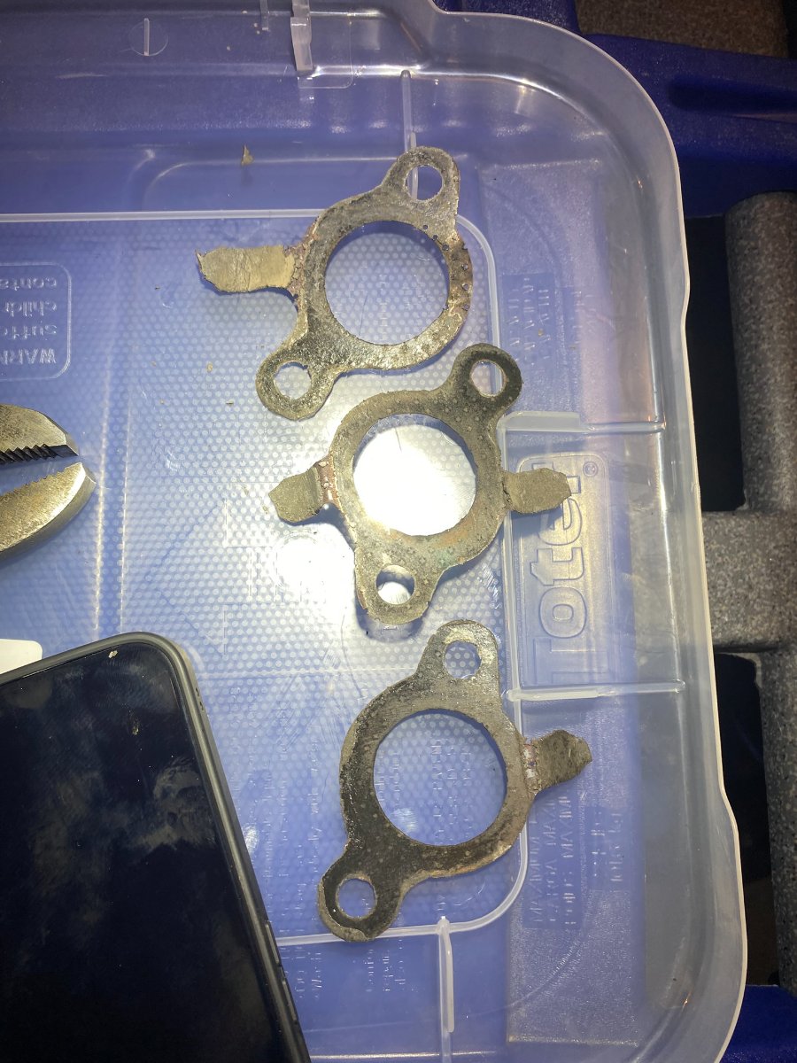

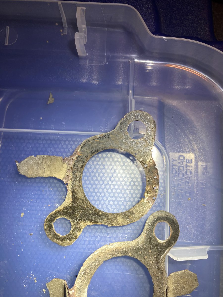

So, I went ahead and swapped out the passenger exhaust manifold gaskets, cylinder #3 was burning out on the backside. Tick is gone, and its not currently throwing codes. Manifold is easy enough to access, will watch and wait on the driver's side - had other chore priorities today; will probably loosen the manifold bolts torque them down 'more better' the next time I tinker. Now I need to figure out where my AC leak is, before summer shows up, haha.
