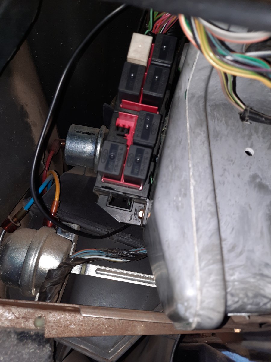

no power to fuses 3,4,7,8 ,24,28,and 33. Bad relay? Also found a relay panel under dash can't find it in the manuals that I have.
Relays?
  • Cruise control not working on 99 xlt
Ok 3,7,33 lights and turn signals
24 start circuit 28 also
Figured it out, cruise control cuout switch on brake Mc. With jumper on switch the pedal still cut off cc. Works in all functions. Can't figure a reason for the MC Cutout.
