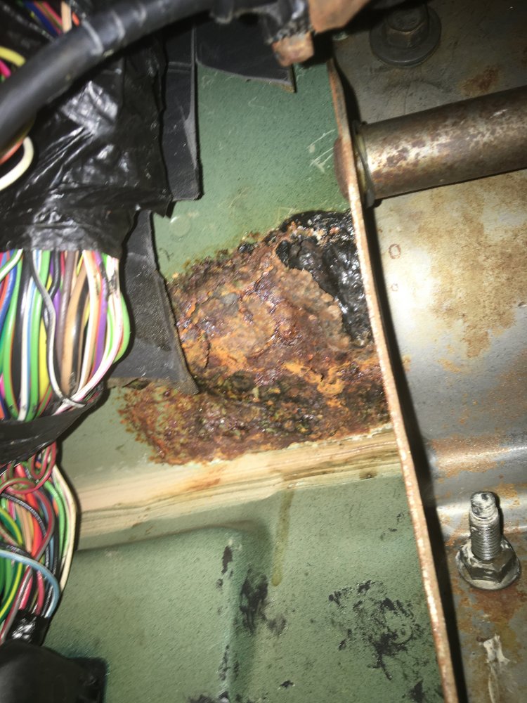

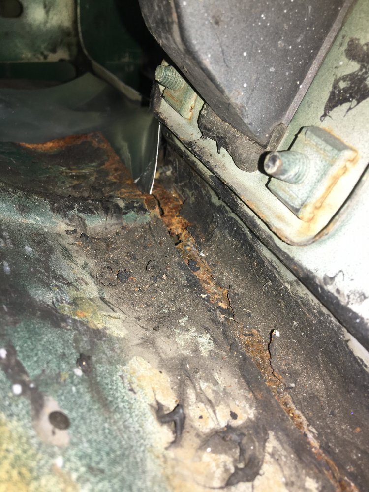

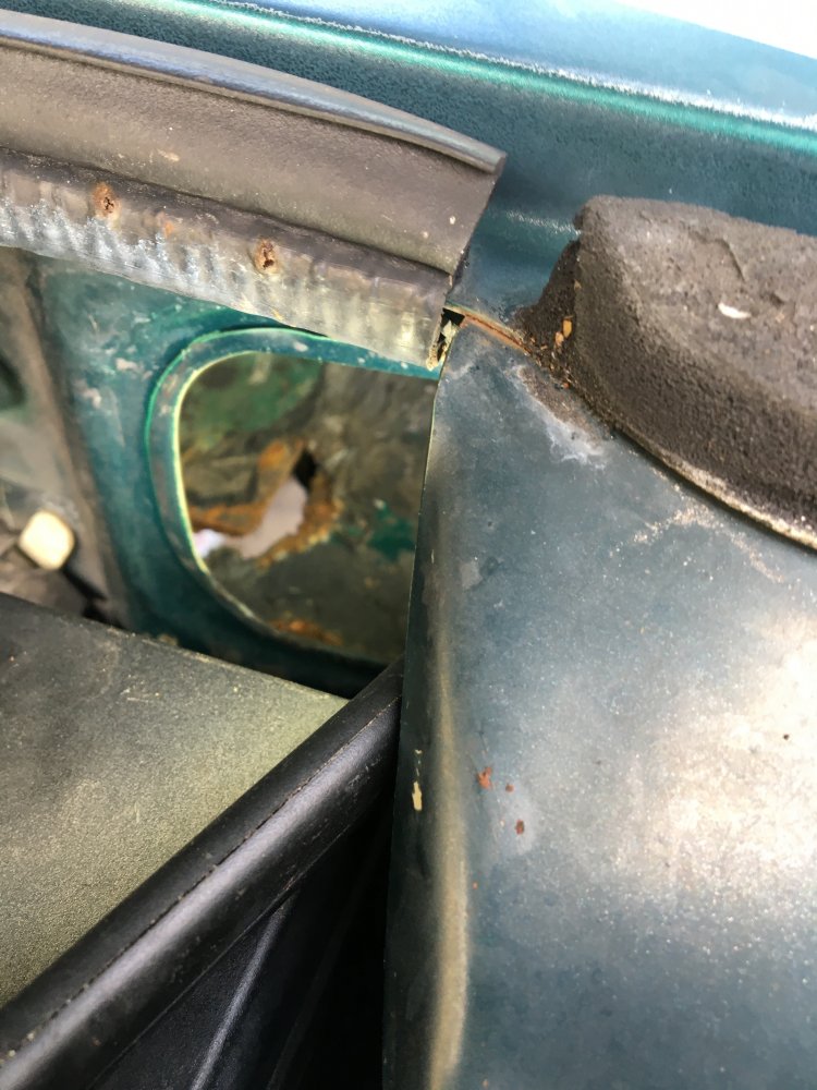

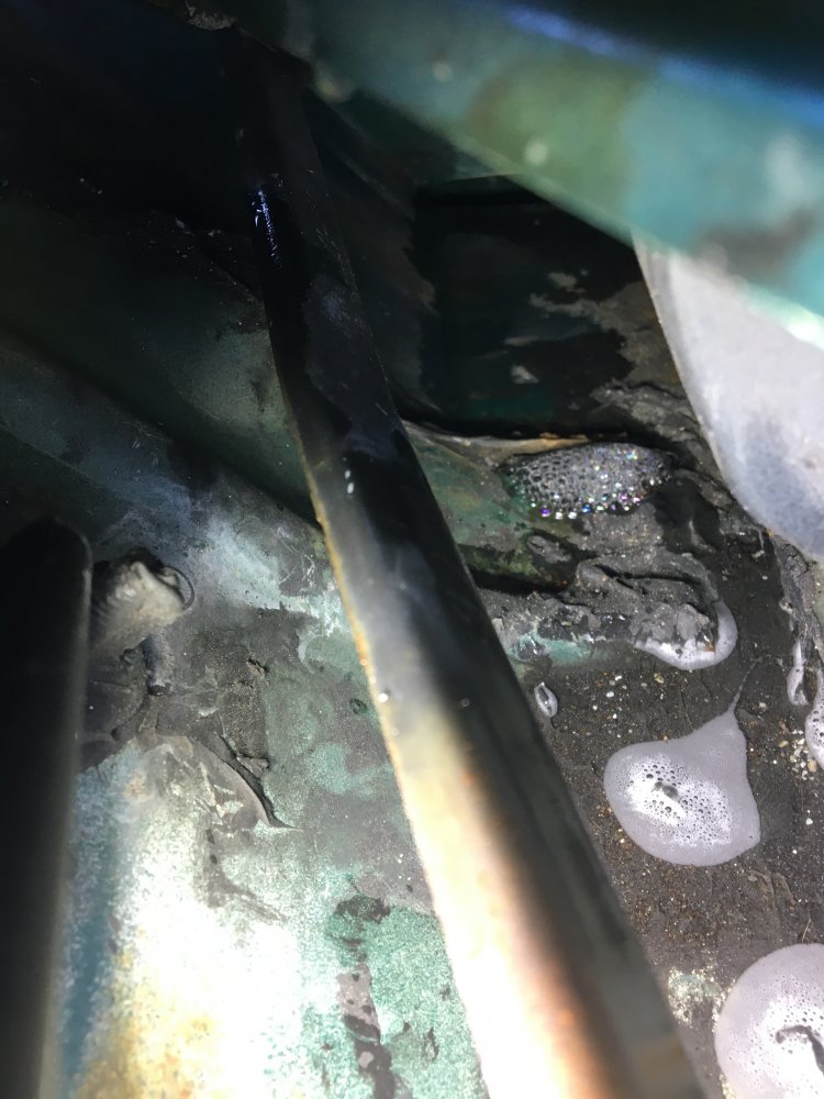

Many a RBV has suffered from the cowl being plugged with leaves. Mainly 83-88 trucks with the big leaf eater slots along the bottom of the windshield. Leaves go down inside there and plug up the drains so water collects and when combined with leaves rots out the cowl which can be an expensive and complicated repair. Leaves contacting the hot blower motor resister is also a serious fire hazard. At best having the cowl plugged up can reduce airflow for the dash vents and defroster. I try to do it once a year and also try not to park under trees in the fall. The process is similar for 89-92 trucks but with the small round holes replacing the big slots in the cowl there is is much less chance of large debris getting trapped in the cowl. Ease of doing this will also vary depending on your engine and options. If you have A/C it is more complicated, different engines fill the engine bay differently too.

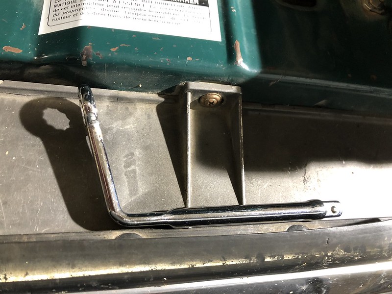

- Something to scoop leaves (I use a distributor wrench)

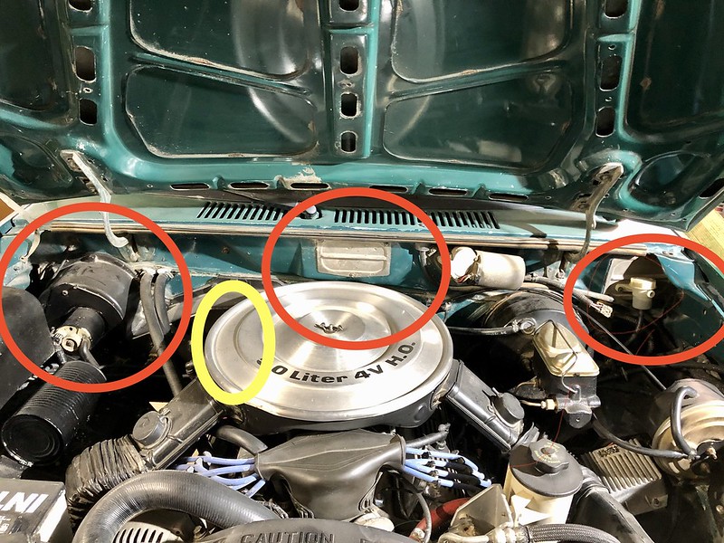

There are three main access holes into the cowl system on a RBV highlighted in red:

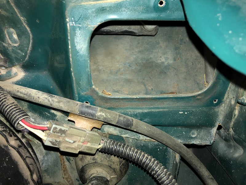

It seems they usually accumulate more towards the drivers side for some reason so I usually start there. If your truck has a manual transmission use the 5/16" nut driver and remove the clutch reservoir (there is only one screw) from the drivers side access panel. Then use 7/32" nut driver to remove the three screws securing the cover itself.

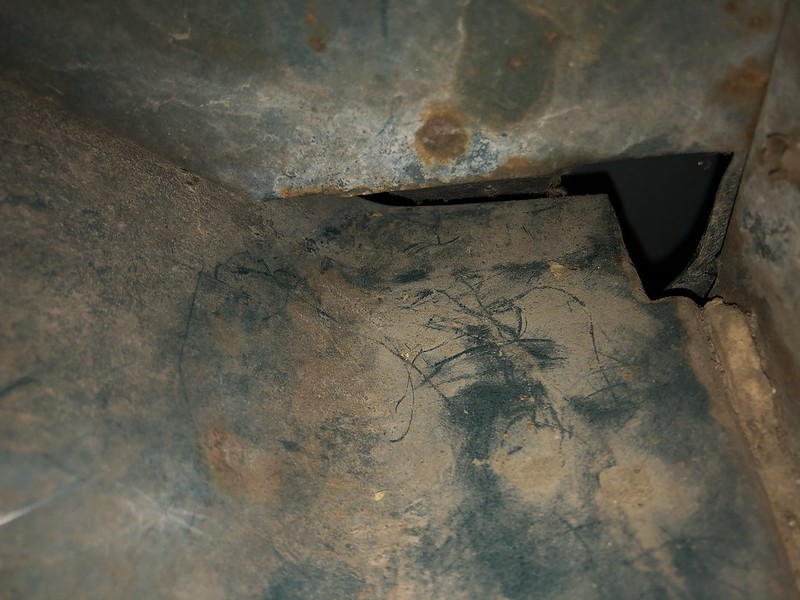

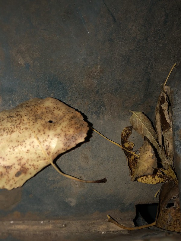

Not much in there this time:
What it should look like all cleaned out, there is a rubber flap on the outside too:

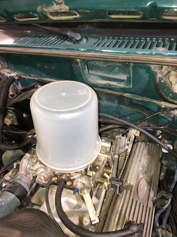

If you have to take anything off the engine to remove the center cover be sure to make sure to cover it so you don't get leaves somewhere you don't want them. I used a dish to cover my carburetor. Use the 7/32" nut driver to remove the three screws from the cover on the center of the firewall above the engine:
There isn't usually much there but it is easy enough to check, a person can also get a feel for what has drifted down towards the blower motor housing too. Once done there reinstall the covers with the three screws (and whatever else you had to take off the engine)

Scoop out what you can (usually the fan chews them up and blows the bits thru the screen into the passenger compartment. This is the backside of the resistor, those wires are resisters that get hot to adjust the fan speed, I have heard of several fires caused by leaf buildup coming in contact with them. If it is really bad removing the housing is simple, disconnect the blower motor resistor and remove the nuts that retain the housing to the firewall with the 10mm deepwell/rachet, watch out as there is a rogue one on the inside of the cab you will need to remove too. My truck has a bodylift so the nuts between the blower motor housing and inner fender are easier to get at, you may need extensions and wobbles to get it done, it really depends on the set up of your truck.

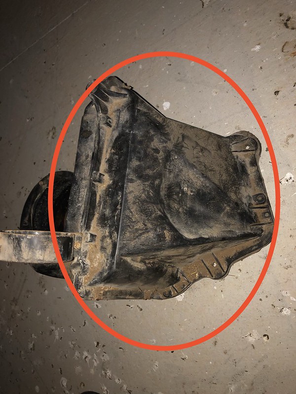

If your truck has A/C now it gets really hairy. So you gotta dig deeper. Air comes into the blower motor housing where it is highlighted in yellow but you have an evaporator that will prevent leaves and debris from getting thru the housing to the blower motor.
Your housing will look like this:
If you have room in your engine bay (mainly 4cyl trucks) you might be able to squeak off the access panel on the engine side of the evaporator housing and clean it out there. Access to the cover is pretty tight on V6 trucks:

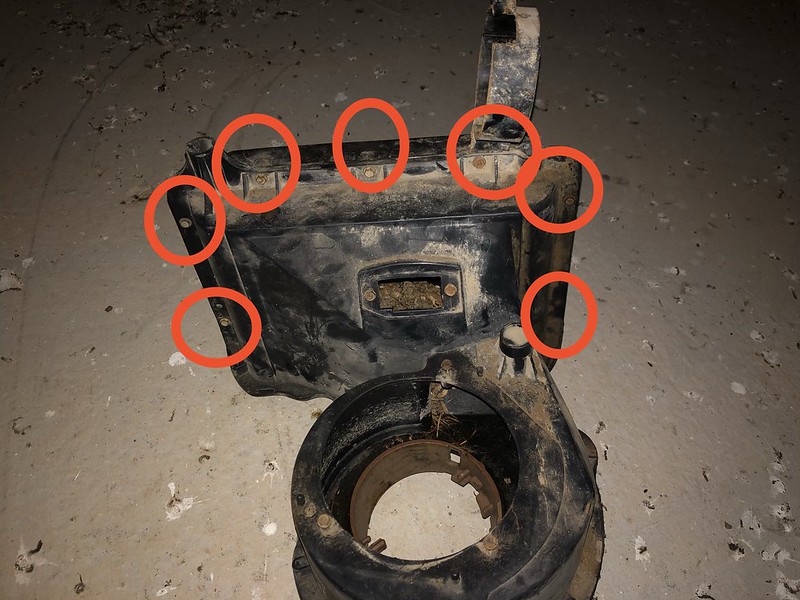

Otherwise you may have to remove the entire housing if you can't get the cover off and then remove the access panel. Mindful of the 30+ year old connectors carefully unplug the blower motor and blower motor resistor. There are nuts all around to hold it on, there is one that has to come off the inside of the cab along the top of the carpet that will drive you nuts if you don't get it off. Use the 10mm deepwell socket/ratchet, my truck has a bodylift so the nuts between the blower motor housing and inner fender are easier to get at, you may need extensions and wobbles to get it done, it really depends on the set up of your truck. Be careful with the A/C stuff so you don't drop/bend/break things. While you have it in your hand you also might check that the evaporator is not plugged up with dirt too. Installation is reverse of the disassembly.

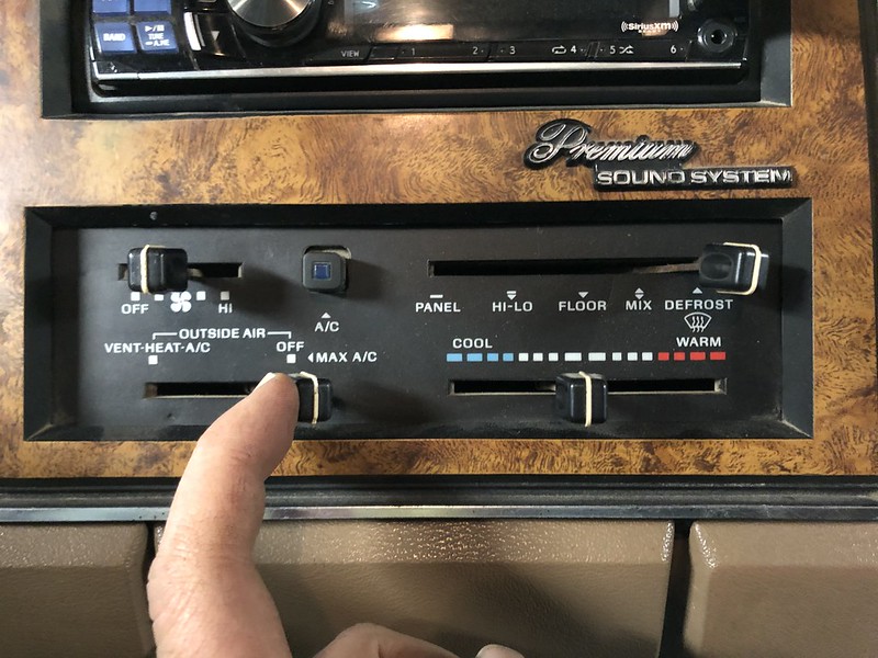

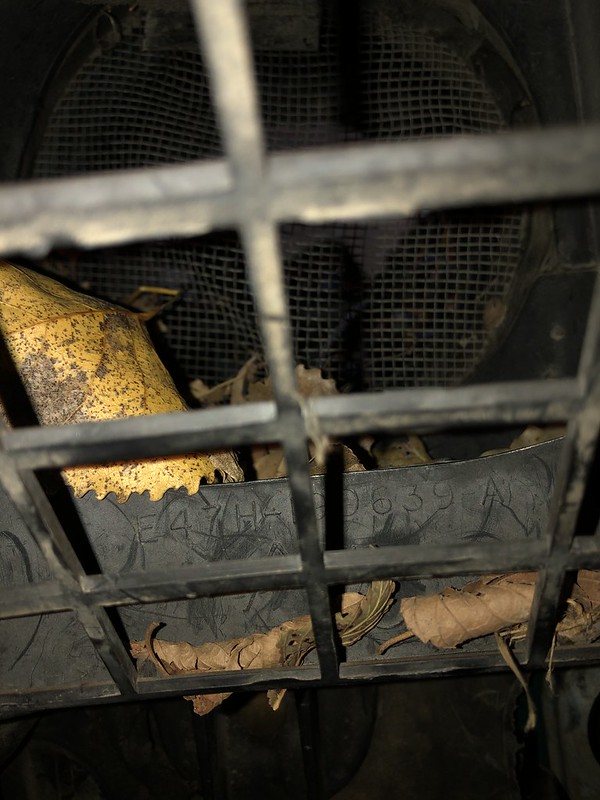

Now how to get at the leaves on the backside of the mesh... set the vent to "Outside Air Off"

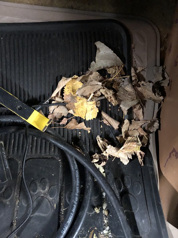

Now get down on the passenger side floor board with your leaf scooping tool of choice, I have ok luck with half a distributor wrench:
There is a black plastic grate down there, with your flashlight you can see the leaves in there, now get to scooping! Go back and forth from the cab and engine sides of the firewall so you can see where you need to scoop.
If you can get an angled attachment for a vacuum that may be helpful too, I don't have one so I can't get the really small bits out.
