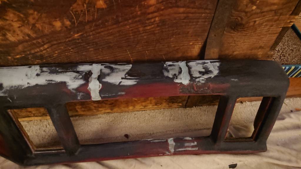

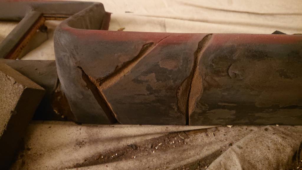

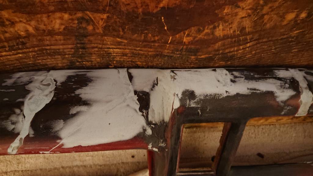

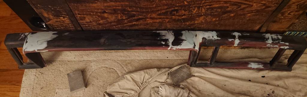

Half assed sand and prep job.
Coverlay Dash Pad 12-112Coverlay Dash Pad 12-112Coverlay Dash Pad 12-112
Sent from my H8314 using Tapatalk

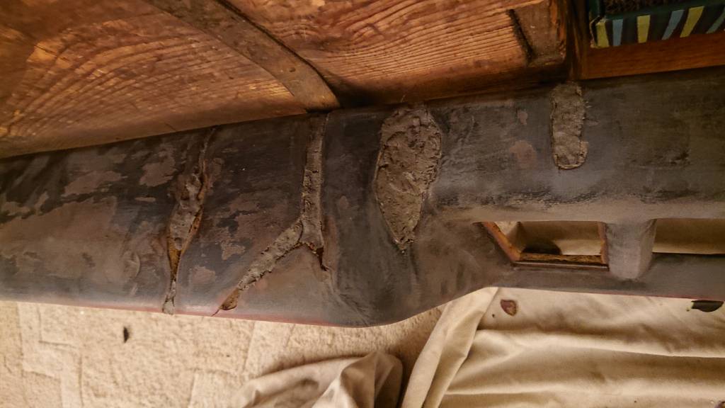

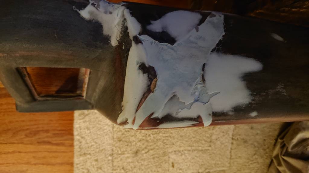

JB crammed in the voids. Coverlay Dash Pad 12-112Coverlay Dash Pad 12-112Coverlay Dash Pad 12-112

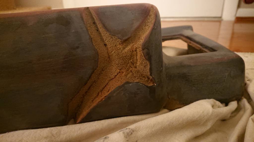

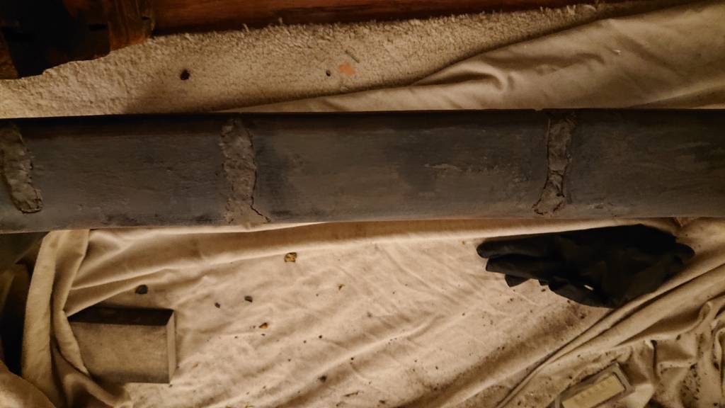

Top shelf body filler. Coverlay Dash Pad 12-112
Long term, you may have a problem with the dash vinyl popping free from that filler material, ending up with hairline cracks, or separations at where the two materials meet. Especially if you're in an area that sees extreme swings from hot to cold. The dashboard fillers remain somewhat flexible over the years, or at least that's what they claim, so they can flex and give with those temperature changes.
Still, I'm staying tuned for more updates on how yours turns out. :icon_thumby:
GB :)

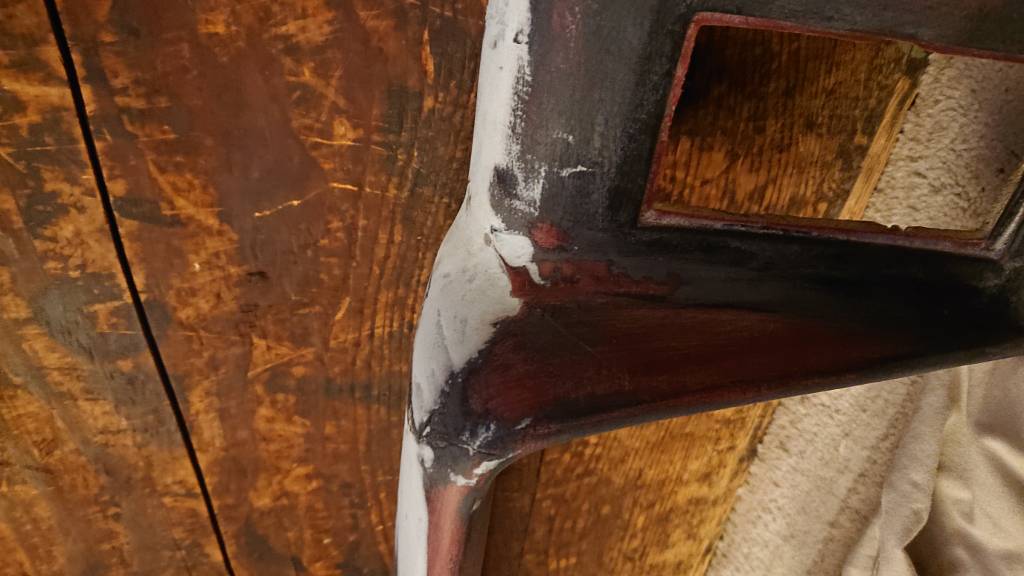

First coat. Coverlay Dash Pad 12-112Coverlay Dash Pad 12-112Coverlay Dash Pad 12-112Coverlay Dash Pad 12-112
GB :)
Oh I don't disagree. Just planning on this being a patch on the ass until I can make provisions to figure something out.
There is a possibility that the re-skin of stretch vinyl can cover the hairlines, etc. Probably not, but still looks better then it did a week ago haha.

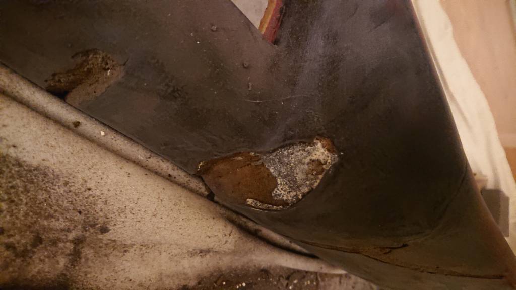

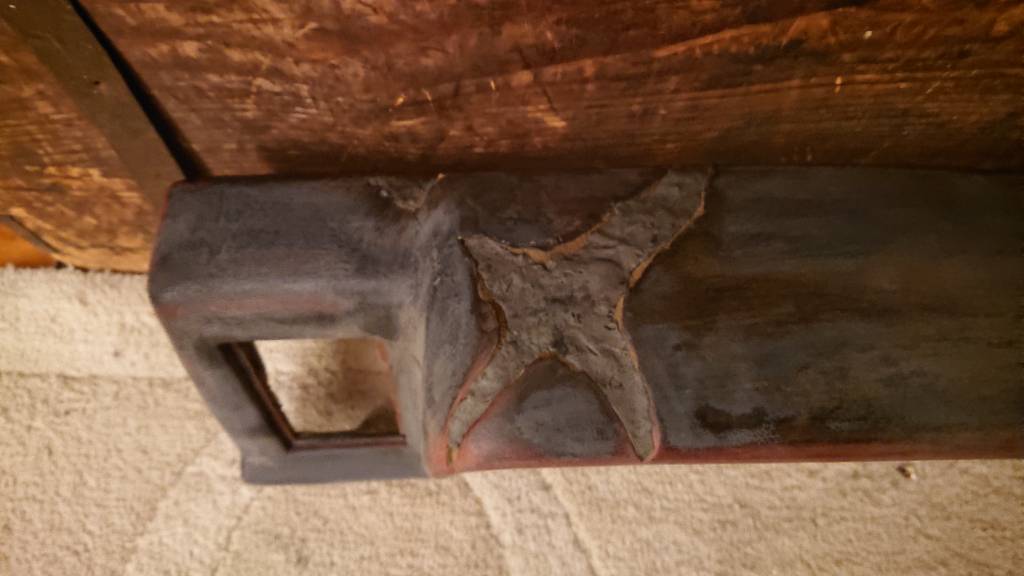

Second coat. Probably won't hold up in the long run. Still looks a hell of a lot better than it did. Coverlay Dash Pad 12-112
You could skin it with fiberglass, and paint it.:dunno:

Well. The vinyl was a failure.
It adhered beautifully to the flat parts of the dash and to the corners. However, it lifted from the inside corners no matter how I tried to adhere it.
I used the loctite 300 spray, tried the recommended maximum adhesion method, and... Nope.
So, now to sand off a lot of glue and start with filler primer. You know. Just to finish the botch job. [emoji58]
