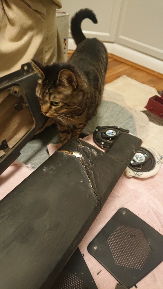

Anyone ever use one of these for the first gen dash pads? Finally got mine torn down. Was going to do the filler work, but the SOB is so dry rotted, there's no covering it with new vinyl without risking it blowing up again in a year or two.
Also. Last guy filled a few holes with plaster (maybe baking flour? Cartel-issued white powder? Don't know what it is.) and brush painted it with Rust-o.
Paint seems to have weakened what was left. End result is remaining pieces shatter when you touch it.
Looked at the coverlay replacement pads, but can't find reviews.

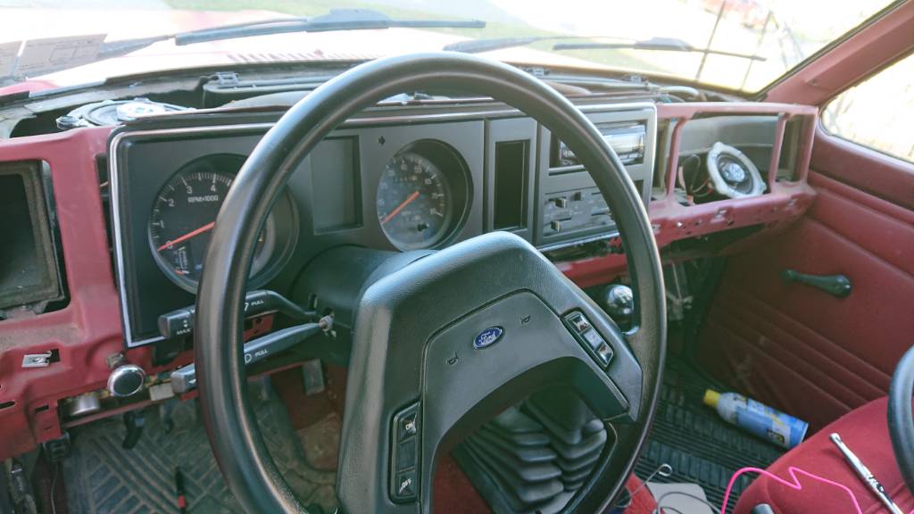

I bought a 1st gen about a year ago and whatever dash cover the previous owner used had to be fastened on using silicone. It's a somewhat rigid, flexible plastic, although it is pretty thin. I don't know what brand it is but I can't stand how it looks and feels, and it's trying to peel up as well.
I was thinking of sending my dash off to have a professional shop strip it down completely and make a new pad using a vacuum forming process, much like how the factory dash covers would have been produced. At one time I had located a shop online that does it this way, but I've since lost track of the business.

Sounds like the LMC glue in cover. Works okish, I see mine is cracking on the top where it goes from the vents to the cluster on the drivers side.
You have to do it just right so it can expand and contract at its own rate... which I am not really sure is possible to do.
Whatever it is, it's a real piece of crap. Not worth wasting hard earned money on in my opinion. I plan to remove it and buy a dashboard filler restoration kit, or having a company redo the dash for me. We'll see..

Thought about doing the repair work to mine and covering it in 2mm foam and vinyldue to mine being so badly damaged. The only reason for the foam would be to avoid future cracks from showing through the stretch vinyl. The original is so badly damaged by a chemical reaction with the Rust-O the last owner used on it, it cracks when you handle it. Also considered using mine as a mold and fiberglassing a new one.
Still. Was hoping a "good" less labor intense option was out there.

Mine is an old, brittle piece of plastic with no flex or give. Why waste "good" materials on it that probably have more flex and give to them then remains of my pad? Going to try something really, really dumb and irresponsible. Or, if it works, freaking genius.
Have some JB Stick left, and "Avant Garde" brand name body filler ($9.95/gallon, with a tube of hardener included lmao), as well as a yard or so of four way stretch matte vinyl and half a can of loctite 300 spray adhesive. Why not try a cheap assed way to fix it instead of just tossing it?
From what I can tell, the fancy assed fillers, cleaners, etc are going to be around the same price as finding and repairing a "good" one the "right" way, so, nothing to lose.
I mean, yinz saw the look on my cat's face. She knows it's crap. We all know it's crap.
