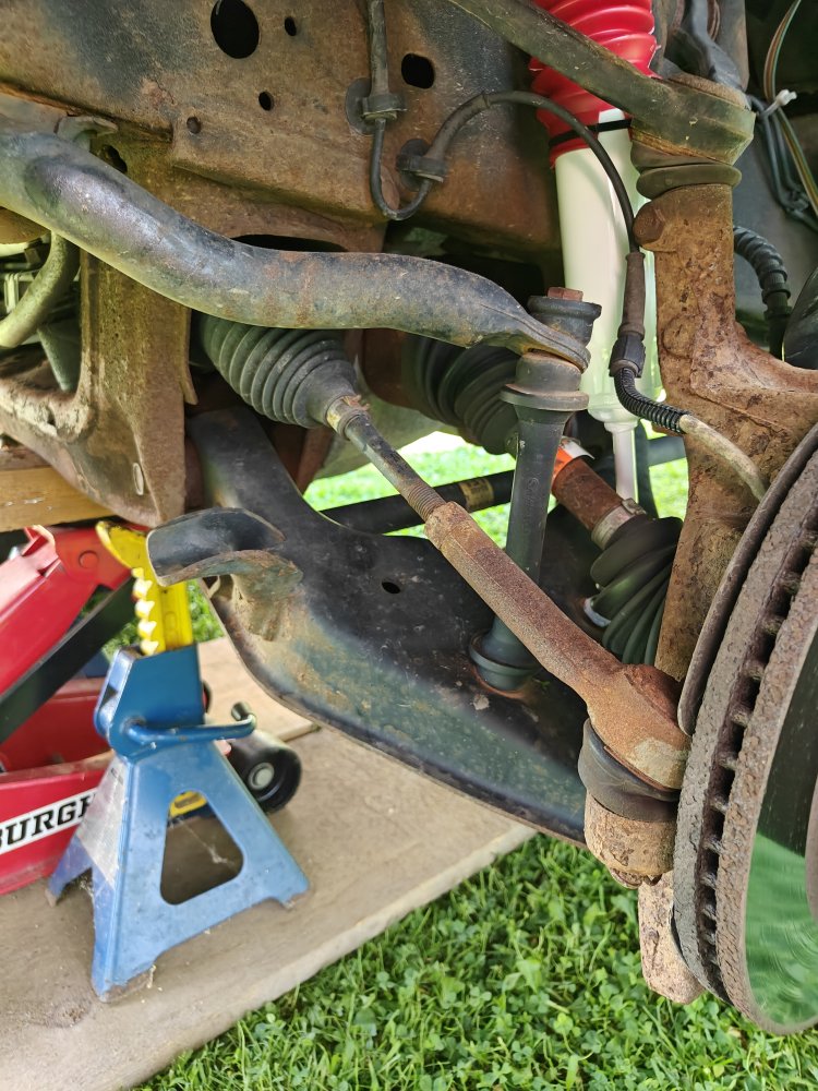

I haven't seen the other thread yet and I don't know what your jackstands look like, but when I need to work on sand or soft ground, I like to use a section of thick (3/4" or more) plywood under each jackstand - at least twice as wide as the base of the stands- so there's no chance of them sinking in or tilting.Which do you guys think would be best for me keeping in mind I'm working on grass and the isn't a perfectly level piece of ground in sight lol.
Maybe I'm stating the obvious, but better safe than sorry.
I also agree that It's probably better to lift incrementally than stress any one corner too much. And use extra stands and jacks as backups. You can never have too many IMHO.
