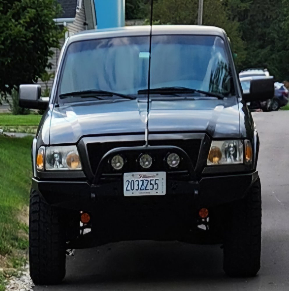

I said I would get a picture of my junk to show angles.
I'm about to put the heavy t-bars in... add a winch... gonna have to move my lights and I wanted comparison photos anyway.
This is with my RC lift keys and one inch over the factory upper limit. Which is one and a half inches over optimal.
Gives you something to compare angles with yours.
Thanks! Yours does look taller than mine from the front but the bumper may be throwing me off. The truck does ride a million times better with the slight drop in the front and new shocks.

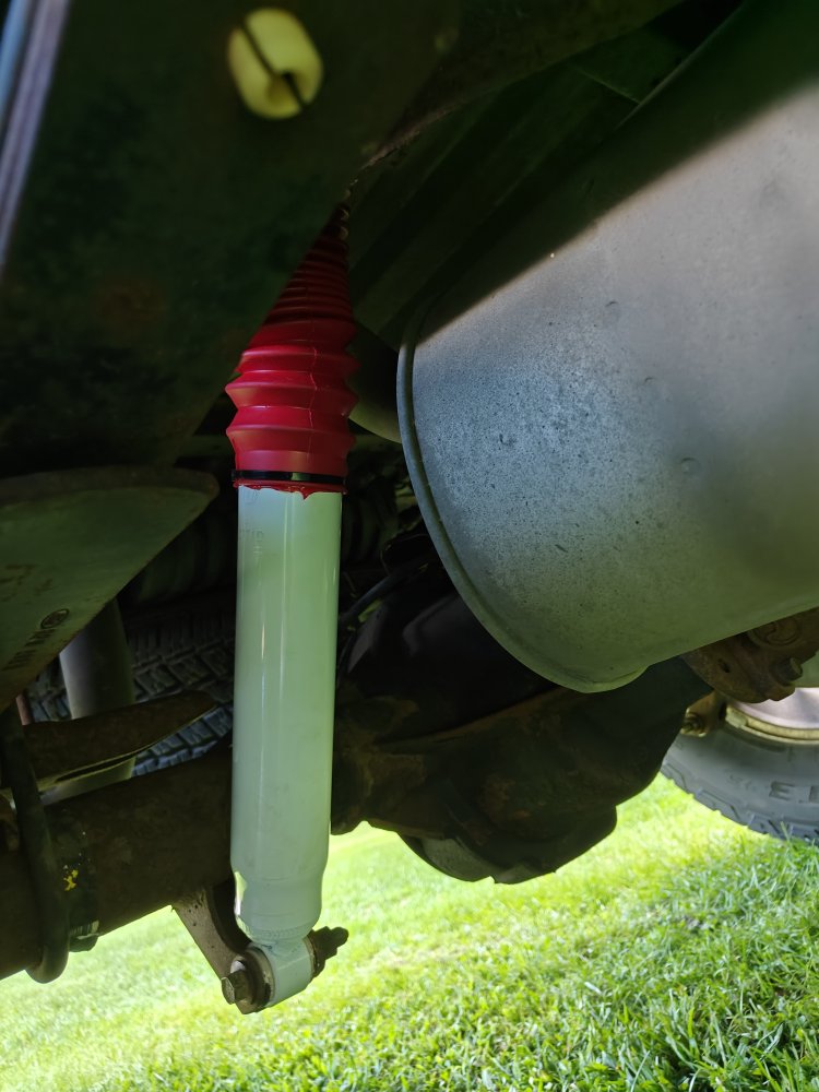

So I did my rear shackles today as well as new rear shocks. As Uncle Gump suggested I got some 6 ton jack stands that worked great.
I ended up jacking up the rear until the tires were only about 6" off the ground, jack stands under the frame (about mid way) and after taking the rear tires off I had enough clearance to drop the axle enough. Nothing to it!

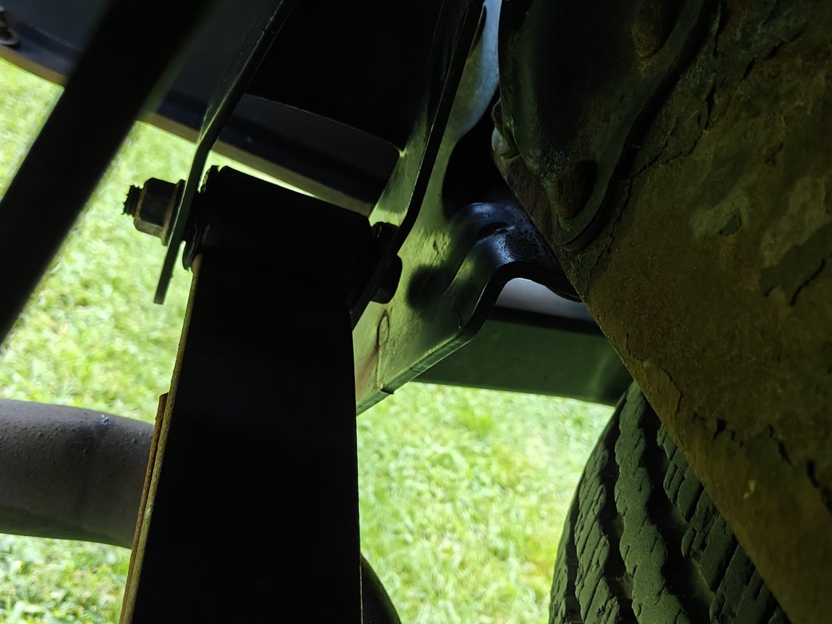

Flipped the shackles as Eric mentioned and put the bolt in the top holes to drop the rear a tad. Also installed the bottom bolts correctly so they don't drag on the hitch assembly now. Truck sits level at around 36" now (ground to fender).
Next weekend I will swap to the new pre keys I got so that I can drop the front to 35" and then should be good to go. Prob another alignment too. I do think that the shackle bolts scraping the hitch was causing a rough ride because it does feel better now. Either that or the new shocks helped but the old ones I took out seemed fine. After seeing the condition of the front shocks I wasn't taking any chances. I forgot to order new bushings which I meant to but can swap those later if needed.

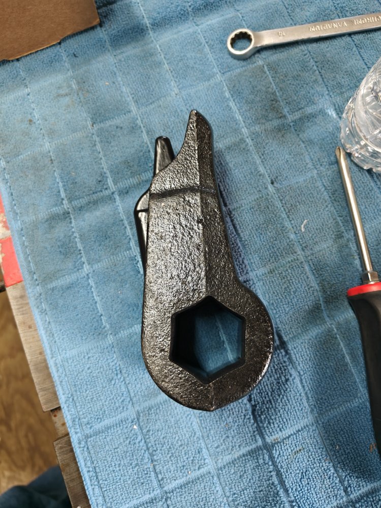

Also a photo to show the dramatic difference between the pre keys and the RC 1.5" keys. It would take you A LOT of turns to get the Ford key to match up with the RC key and considering 4 turns on my truck equates to about an inch in height change!
