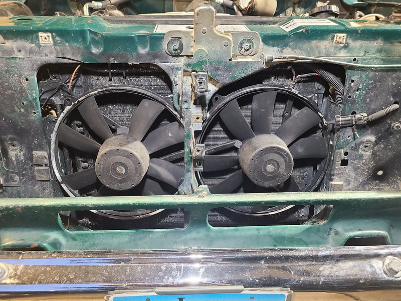

Mercedes c230 Kompressor pusher fans are a direct bolt in on a first / second gen ranger. @85_Ranger4x4 and i both have them. They're the ones in front of the intercooler and rad on the benz. Strip the plastic off of them and direct bolt to core support hole. I used them as aux fans, but never had to turn them on. The windmills at highway speeds was enough for my electric to never kick on.
My experimenting with cooling led me to a single row rad with puller and pusher fans. I had the best results with less rad and more wind.
Big wind + less rows to move wind thru led to a very efficient system.
