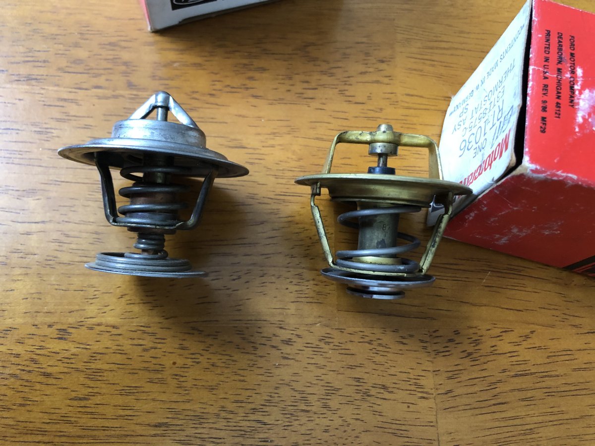

are you talking about the bottom Tstat? are the 2 the same heat tolerances? because the top housing does not need a second Tstat. use this area for the sending unit for a "mechanical" gauge.
I thought only the 2.3l Duratec Rangers had lower rad hose thermostat?
There are different thermostats for 2.8s. The brass one on the right is the part for engines with the lower thermostat.

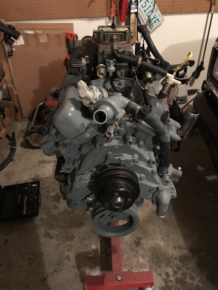

The 2.6-2.8 have a reverse flow style system where the housing is down under the water pump and there is a small bypass hose going up to the top housing. this bottom section is where the Tstat is to be placed.
Yes and no. This was changed midway through the 1985 production year. Later models have a different intake, bypass hose, upper thermostat housing, and thermostat.
The engine in this post does have the earlier location.

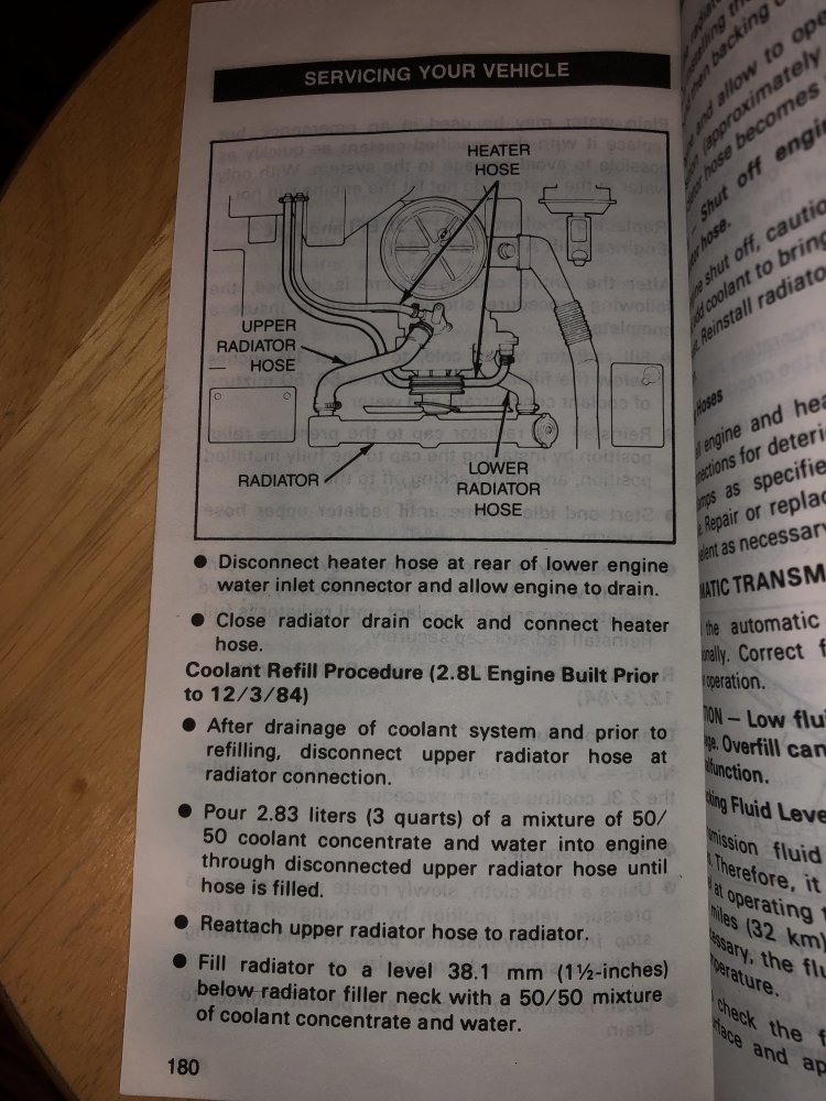

andy, that is interesting, you have something I can read about this?
Lower thermostats would be 180degF to maintain 190degF in upper engine
sorry andy, that doesn't say anything about a top Tstat. coolant enters an engine from the bottom of the block.

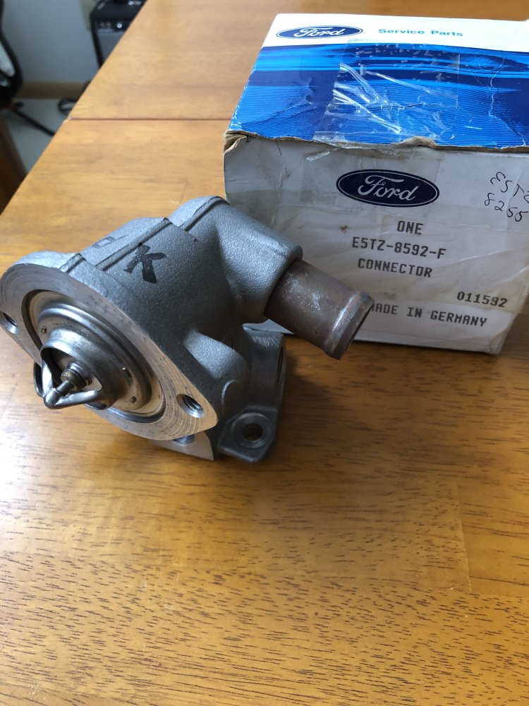

Here’s a picture of the updated thermostat housing and how the setup looks installed.
ok i stand corrected for the "funsies" here is a search on the part number you show....
this to me wouldn't be a common part as ford went 2.9 soon afterwards.
and why didn't you just show me that part and number to start with? i learnt something today. thanks.
but i would venture not many have this part in thier truck. and what did they do down on the bottom of the inlets Tstat? vacant hole?
Shows as Upper on B2 and Ranger 2.8l
