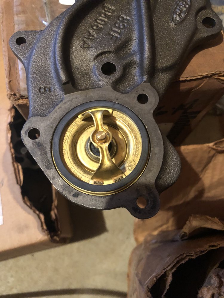

There are different thermostats for 2.8s. The brass one on the right is the part for engines with the lower thermostat.
I have a lower stat on my B2 and had no idea it used a different style thermostat.
I believe I replaced the original and don't remember it looking like the one you have pictured.

OK, back to cooling issues. I honestly have no idea what the issue was. But, I did get an o.e. t-stat from @AndyB. (thanks again!) and installed it. Before installing, I verified that it opened at 188* F. I followed the special 2.8 coolant filling procedure (and did the first time, too). This time I took the truck outside and let it idle waiting for the t-stat to open by observing the coolant level through the radiator opening (rad. cap removed). It eventually did open as the coolant level dropped dramatically. I witnessed the electric fan cycle on/off twice. So, something changed but have no idea what.
I also checked the t-stat that I removed (Motorad 192* from Rock Auto). It also opened when it was supposed to. I see no issue with either t-stat. The one thing I did notice was that O-ring, that goes between the flat gasket and the t-stat (I believe it's there to hold the t-stat in the water pump) was not seated properly. See below. It looked like it had collapsed a little (kind of resembled a Pac-Man shape). I suppose it's possible that it was restricting water flow from the radiator into the water pump/engine?
Anyone want/need a new t-stat? Motorad part: MOT 234-192. LMK.

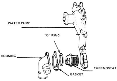

That o ring seal is a problematic design. 20 years ago I found an aftermarket one that was larger in diameter and thickness, it would stay in place on its own.
Factory parts in this picture, no idea how to keep that ring in place while tightening it down.
