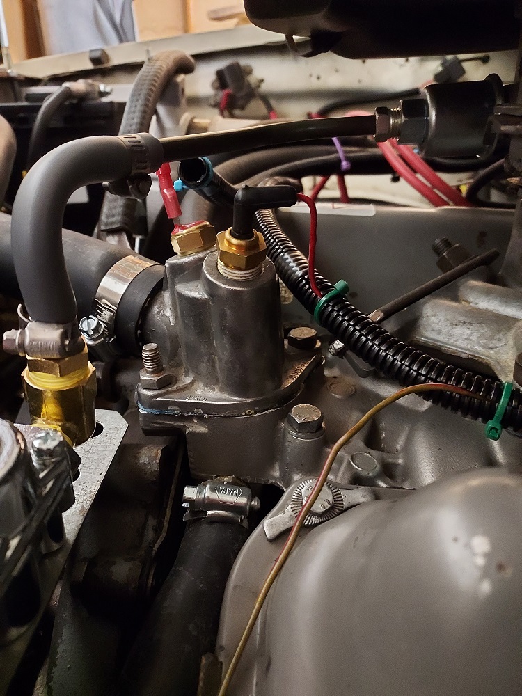

I may have created some confusion (my bad) thru ignorance; my water neck has the coolant gauge sending unit and the electric fan sending unit (the switch to complete the circuit to turn the fan on). It does not have a t-stat to regulate the passage of coolant.

Upper water neck showing the two sending unit switches (that I originally referred to as 't-stats'):
The near one (on the right) is the sending unit for the dash gauge. The far one (on the left) is the switch to actuate the electric fan. The other difference between my 2.8 and AndyB's 2.8 is that my coolant bypass hose goes into the intake manifold while his connects to the water neck.

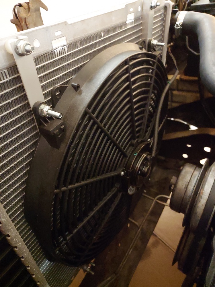

Here's the electric fan in question:
I have the fan supported by two pieces of aluminum angle (3/4" x 1/2") which are in-between the fan and the radiator core. I'm wondering if the fan shouldn't be right up against the core itself but I'm not a fan of those thru-the-rad-core zip ties that come with these kits.

I guess it's possible that I have air trapped in the water neck where the two sending units are. That's the only thing that would make any sense. ??

I am here to tell you that I've played the electric fan game and lost. I bet I tried 3-4 different styles and brands of automatic temp switches and none of them worked right. The one I have now was supposed to be adjustable and I had it dialed down to about 160 degrees but eventually it just started activating the fan whenever it felt like it. I ended up just putting it on a bypass switch and remembering to turn it on when I drive the truck.
The previous fan wiring kits I got had constant relay failures and one of them got so hot that it melted the power wire from the battery and the fuse itself but didn't pop the fuse. I am not a big fan of aftermarket electric fans, I have yet to find a setup that works like it should.

I also don't have a real issue with going back to a mechanical fan either. But, I'll have to find one as the old one was cracked, in several places.

If we think about what the thermostat does, it opens or closes to allow water to flow either through the radiator or the bypass. I think a 180° lower hose would be normal if the thermostat is closed and coolant is flowing through the bypass circuit.
I think the upper water outlet coming off the intake is a good place for a temperature sending unit, since you’ll always have coolant flowing there, whether going into the radiator or through the bypass.

Temperature readings and thermostats and that are all fine to check out, BUT, what are the OHM readings from the sensor at the various temperature readings?
Since this looks like a single wire, I would assume it closes a ground to energize the relay, so, I would make sure the relay is wired correctly and maybe you can test the sensor simply by attaching a beeping voltage probe by sticking the pointy end into the (+) battery terminal and clipping the other end to the male 1/4" connector sticking up. If you do not get a beep and a light, then maybe there is not a good ground to the housing. Maybe just running a ground wire directly to that bolt sticking up clamping the housing would solve the problem.
Maybe you need a switch that closes a ground to turn the fan on vs. one that sends a reading to a gauge.

I will need to check this when the engine is cold and after it's up to temp. Good idea!
I believe the sending unit for the fan simply completes the ground when the coolant reaches a specific temp (200*). I've tested the ground many times. It's seems to be very good.
You kinda lost me here. I have two sending units. The fan does run but seems to come on when the water is below its activation temp (200*). The gauge sending unit seems to indicate that the coolant temp is high (dash gauge caveats apply here). I can hold onto the upper rad hose when the fan is running (engine @ temperature), it sure doesn't feel like 200*. The lower rad hose is much cooler, right around 90*.
