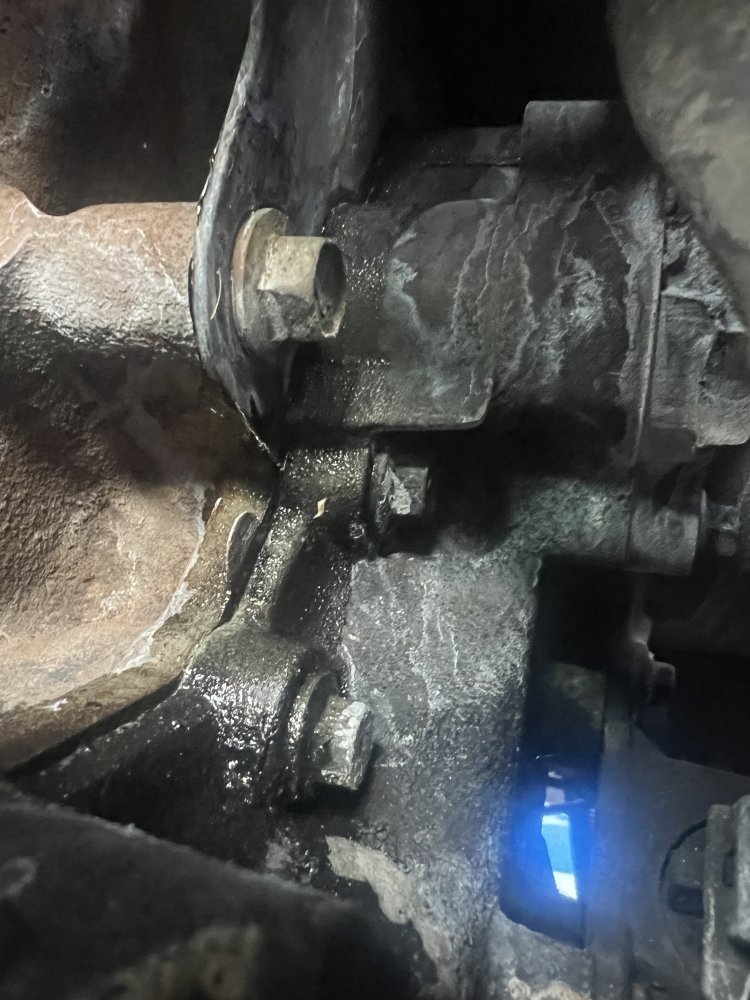

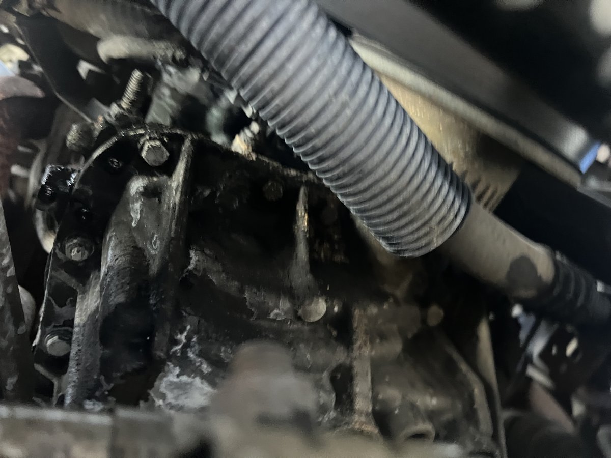

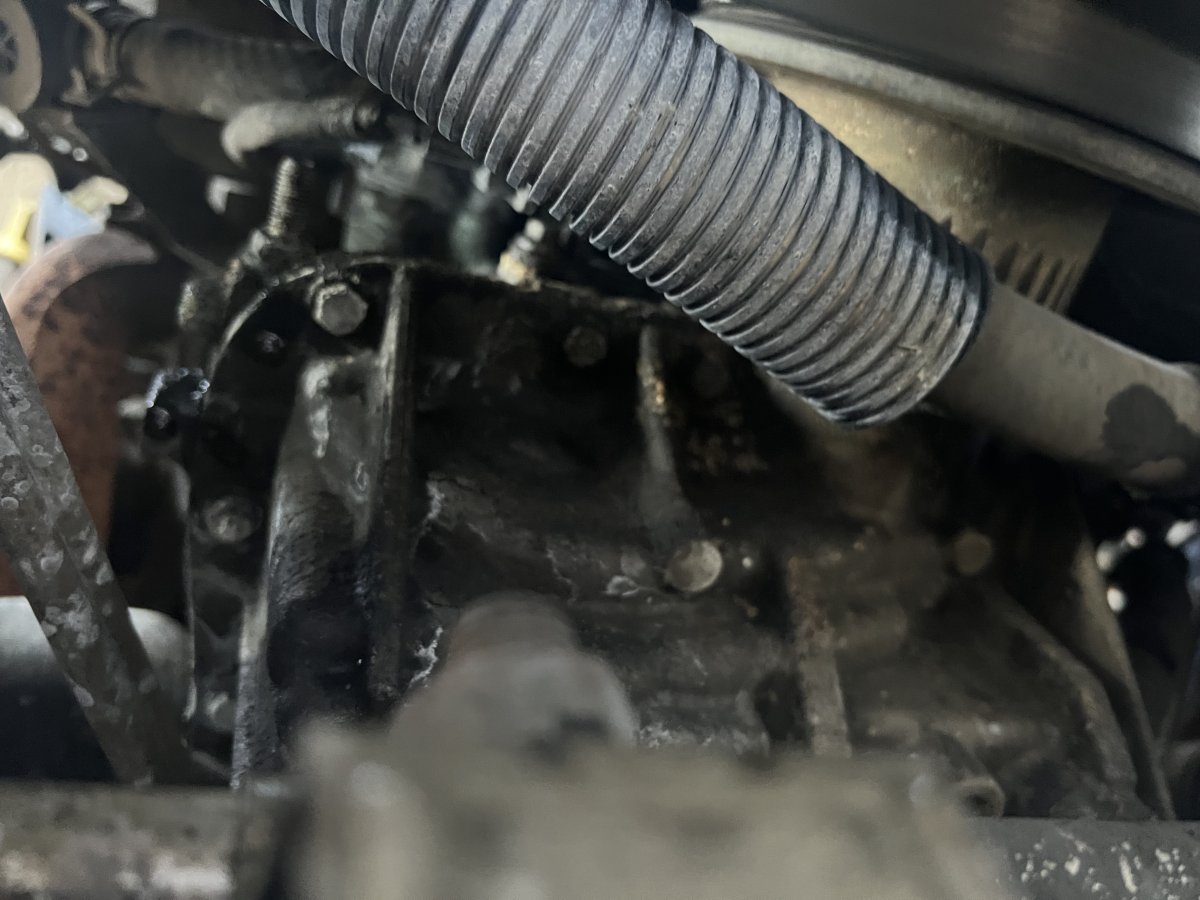

So it is a 4.0l 2003. Leak is about 1 drop every second while running and coming from the passenger side. I got the Pittsburgh pressure leak tester and it worked about as good as anything else from my boys over at Harbor Freight which is to say the cap wouldn't fit because of a defect. Knowing my luck it is coming from the water pump, but I figured I'd let the experts here toss some ideas. It is not the radiator and does not seem to be any of the hosing associated with the radiator. Appreciate any insights! This would be the second Ranger where I had to replace the water pump because of a leak :rolleyes:
Unrelated, but looking for the coolant leak I found my vacuum leak instead! HA! Guess who's gonna be sitting with AC actually blowing on me now :cool:

For anyone curious, after searching this forum and the google machine my bet is the thermostat housing as I can see potentially a very small amount of coolant around the seems of it. When I get the replacement pressure tester I will know for sure, but I feel mediocrely confident that is probably the issue.
I'm thinking of getting this part, but allegedly it doesn't fit a 2003. It looks the same though? https://www.1aauto.com/*/i/1AEMX00432
I'm having difficulty determining where the photos are showing the leak in the picture. At the back of the engine by the transmission?
In anycase, the plastic thermostat housing does have a tendency to leak over time as the plstic gets old and brittle. A few of us swapped that out for an aluminum one made for the Ford Explorer. Being that the t-housing sits right at the front of the valley of the engine, I suppose it could leak into the valley and eventually run back.
Before you spend the money, see if you can clean any dirt and grime off the engine so you can better see where any leaks maybe originating from. The passenger side is more difficult because of the evaporator housing. A mirror may help or looking at the engine through the wheel well instead of underneath or over top.

For anyone who is wondering I got another coolant leak tester and it was the thermostat housing by a land slide. It leaks like crazy when put under pressure.

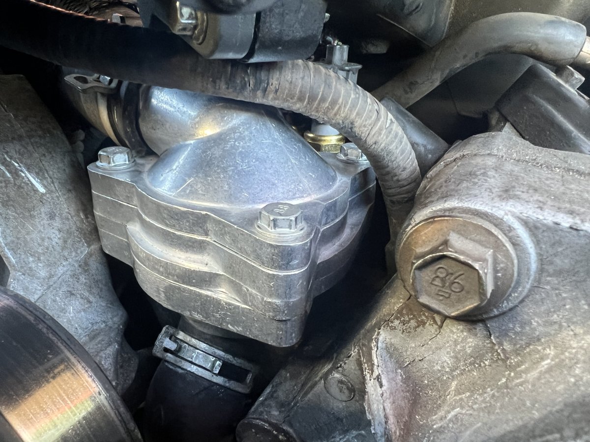

For anyone who happens to come by this post in the future here is a picture of the finished product. Here are some notes. The sensors that came with the part from Amazon worked fine. I have a Ranger 2003 4.0L engine so do with that what you will. To take off the very back bolt towards the cab you can just push the electrical wires towards the radiator and use a socket on it in order to get it off. None of my bolts were seized, but that is a common issue.
My lower hose leaks a little at 7 psi so if you can you may want to replace that one since it is short and with the temp hosing off will be a easy replace. I just slapped another hose clamp on it and called it a day, and to be entirely honest I am not entirely sure what the system normally runs at while operating so it may be a non issue. Good luck!

When I replaced mine with the aluminum housing it didn't come with any sensors so I just used my existing sensors. I second the idea of replacing the small hose. Mine wasn't leaking but it was a bit brittle so I just threw a new one on to save me the hassle down the road.
