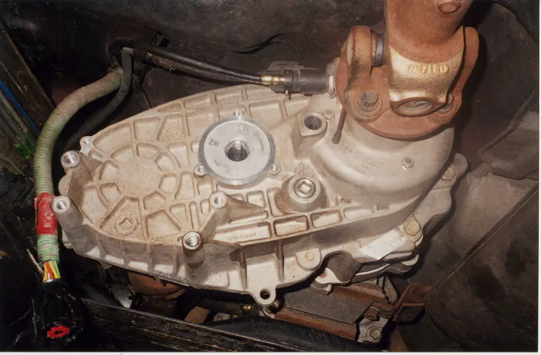

confused on where fill hole is on trans case
fishon79
Dec 2, 2008
13
vancouver wa
90 and 94
Ive read and looked at all site info for a 1354 borgwarner transfer case.I see 2 plugs on rear of transfer case both are about same level. One is behind the damper the other amongst the area where the motor wiring (plug) is. where is the fill hole. Stupidity is pain full when your neck is strained from looking. Please help
The one near the shift motor is the fill plug.
Yep, the one at the shift lever is the fill hole and the other at the bottom behind the damper is the drain.
