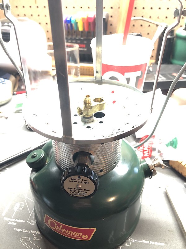

Not sure what to do about my F. I've got the burner assembly and generator removed but I cannot get the cleaner assembly thing off of the valve below it. I want to tear the whole thing down and give it a good cleaning but it's seized together well enough that I'm afraid I'm going to destroy it if I go any further.

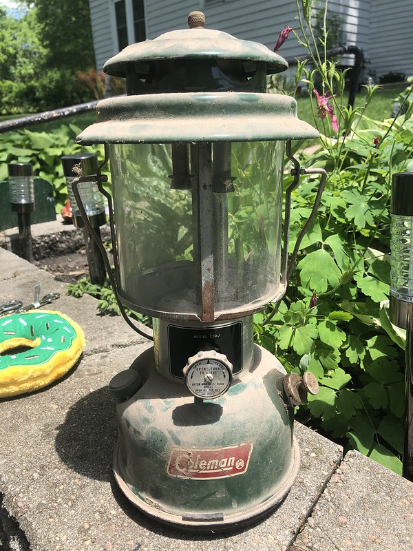

Here's my little family... the H's are from the 70's and the F is a 63 IIRC.

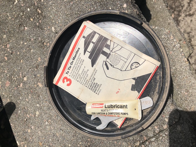

I found this stuff in my garage that goes with my first lantern, the H.

I got a special wrench the other day to tear down my 220F, I am pretty sure it has a partially blocked fuel tube. I can get decent fuel flow for awhile but it fizzles out. I think the lantern draws fuel faster than the fue can get thru the blockage so it goes out, then as it sits more fuel can get back in the fuel tube.

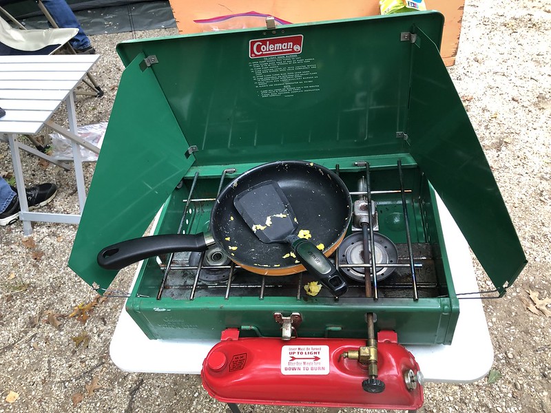

Mine cooked breakfast twice and heated water for dishes at the roundup. It didn't miss a beat, I still have yet to add fuel it since this thread started.
