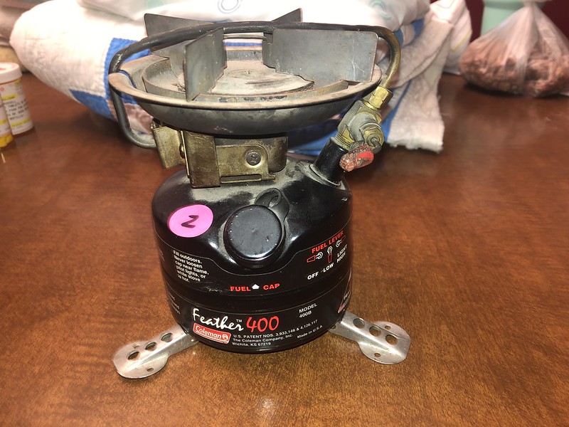

We were going to visit a friend in Lincoln and found a garage sale on the way. Since @fastpakr thinks my stove is too big I snatched up one of those little lunar lander looking super small/compact backpacking stoves. Yep, for $2
Made 5-97. They REALLY cheapened up the pump thing. I suppose it still works but I like the metal clip better than the plastic twist lock thing, I see the new ones are still like this. I don't know what I am going to do with it but for two bucks it looks like fun. I like how we have to have an arrow pointing to the pump...

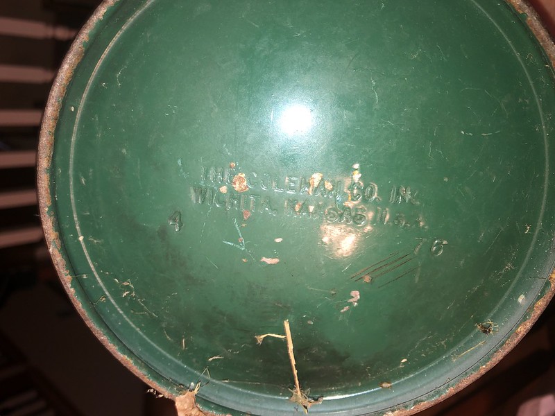

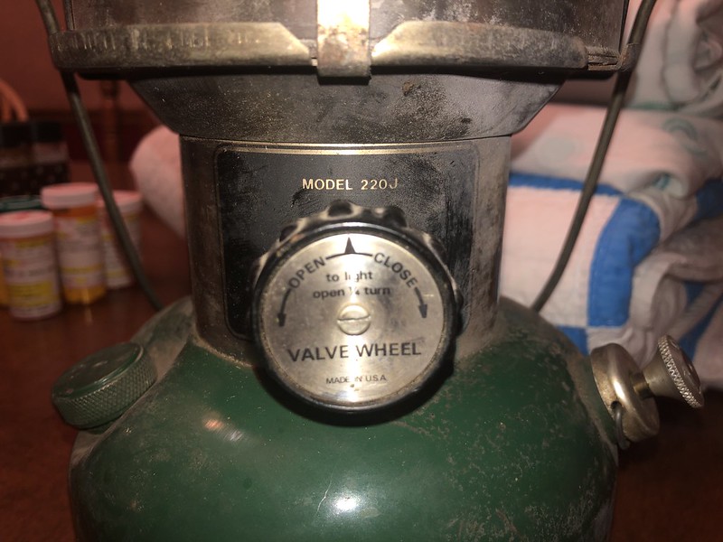

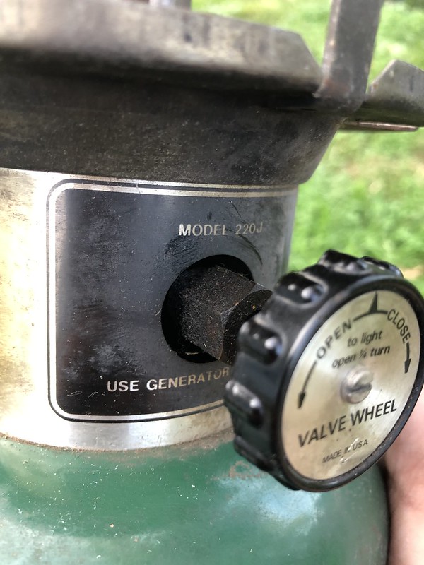

And for a whopping $3 I snagged a user lantern that I don't have to worry about getting scratched. A 4-76 220J so it isn't a model I already have too. It is kind of sooted up, it might need some work.

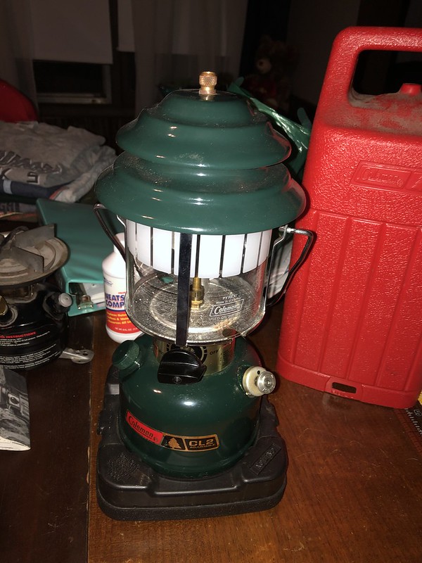

Well that got me in the mood so I got to looking on facebook marketplace and found this:

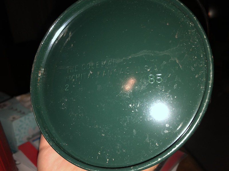

2-85 288 CL2. They had kinda started going downhill then (although they got a lot cheaper made after this) but it was made the same year and month as my Ranger which is neat. And it might have been used once, it is like brand new. They were asking $20 but took $15.

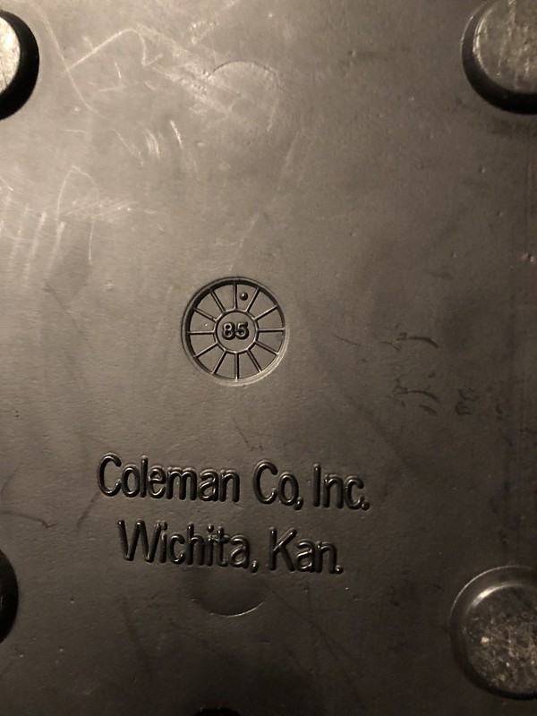

Case is period too, I think January of '85.

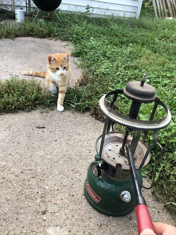

Well the two project ones both make fire anyway.
What is that hissing noise?

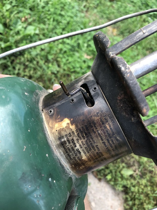

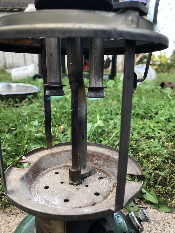

It was gusty but it was trying. Lots of yellow flame but it had no chance of heating the generator with the wind and no globe. It actually smelled like burning old gas, like unleaded kind of gas. Gonna put fresh fuel in it before the next run, it doesn't smell like normal gas in the fount though, so maybe it has turned.
Then I noticed like smoke coming out of the collar. I think it was actually fuel vapor but that could explain the crispiness around the collar. That was a mission kill, I turned it off after that.
Also got moist around the packing nut for the valve.
Ok, so that one is going to need the burner frame taken off and the lower plumbing checked out. The air tubes will be easy to check for obstructions at that point too.

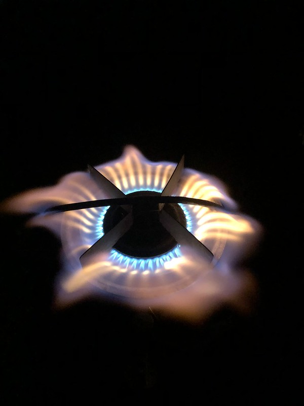

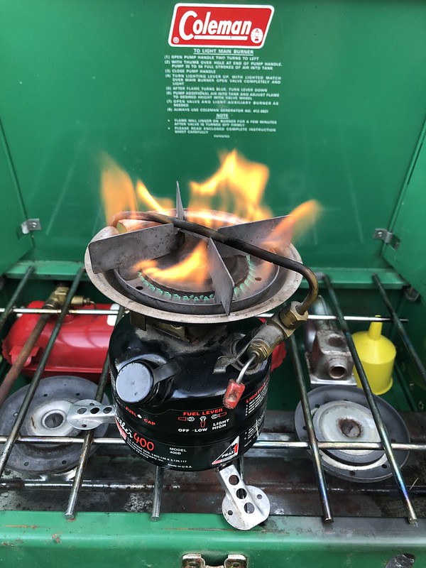

Stove ran a little yellow, better on simmer than full blast. Stupid kitten wanted to play with it too. I think it needs taken apart and cleaned too.
Tried it again after the wind went down. Did the same but really pretty in the dark on simmer:
About half of the stoves and lanterns I've gotten have had loose fittings. In some cases almost completely unscrewed like someone was messing with them before. Found quite a few leaks that way, right away. SOP for me now is to make sure everything's tight now before firing up a new piece.
I should have done more, especially with the lantern.
Tore the stove down, nothing wrong with it. Going to clean the regulator and try it again in calmer wind conditions.
