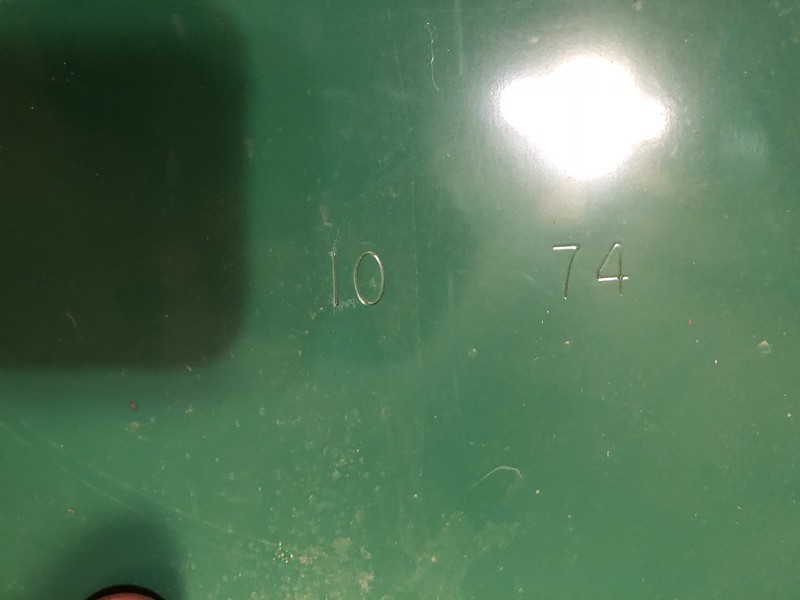

Way older than I thought it would be, dad said he bought it around '80-81 and theorizes it must have sat on the shelf awhile since it was made in late '74. I thought he got it in the 90's.

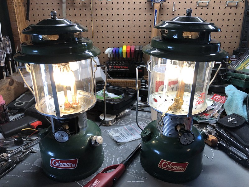

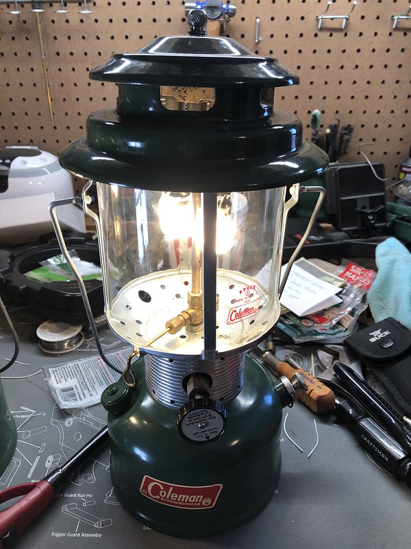

Well gee that was fun, I remember I have a lantern a customer gave me. He got it in a box of junk at a garage sale and doesn't camp. I reluctantly took it, I have an LED one and didn't really think I needed a gas one but it was in too good of shape to let him throw it away. Its been sitting under the workbench in my garage for 2 years. After the stove last night I was intrigued to see if I could get the lantern to work too.
By some weird chance it is almost the same age as the stove, a little over a year older.
This one wouldn't pump so I smeared a little 5W-20 on the leather piston cup. Builds great pressure. Grabbed some new mantles at Shopko for $4 and gave it a try.
So I am 2 for 2, I didn't even change the fuel and am into both of them $4 and a dab of oil.

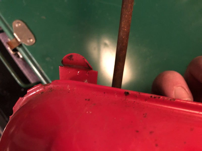

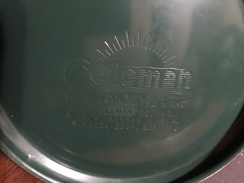

Most Coleman stuff has the month and year stamped on the bottom of them (and the fuel tank tabs for the stove) which makes aging them easy.
I guess birthday lanterns (made in your month and year) are kind of a big thing so now I kinda want to track down one of those...

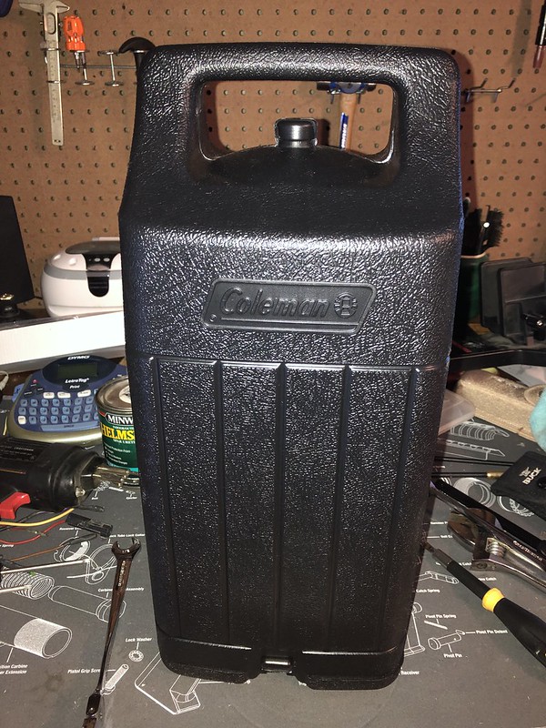

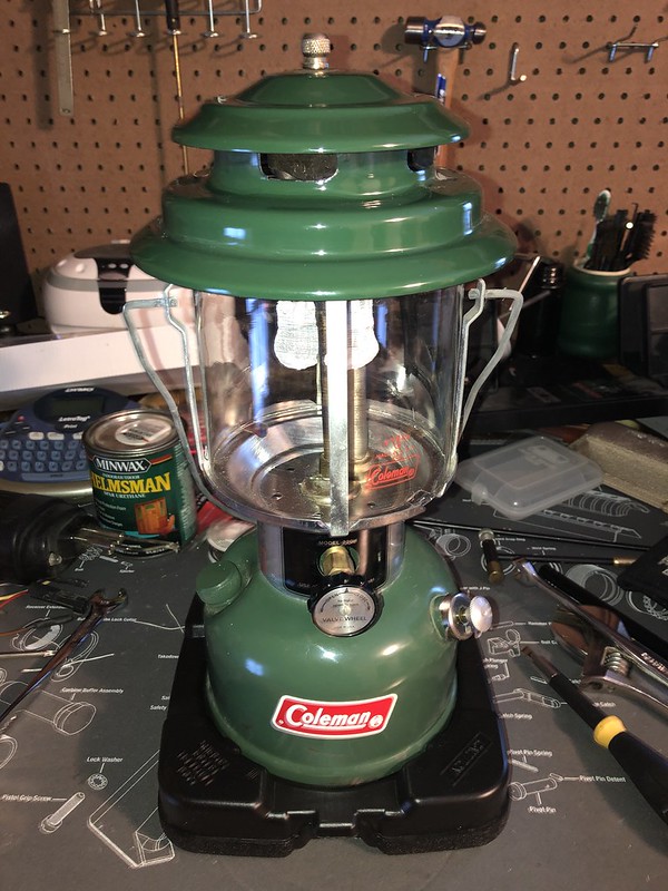

Picked up a case to protect my rather delicate looking lantern.

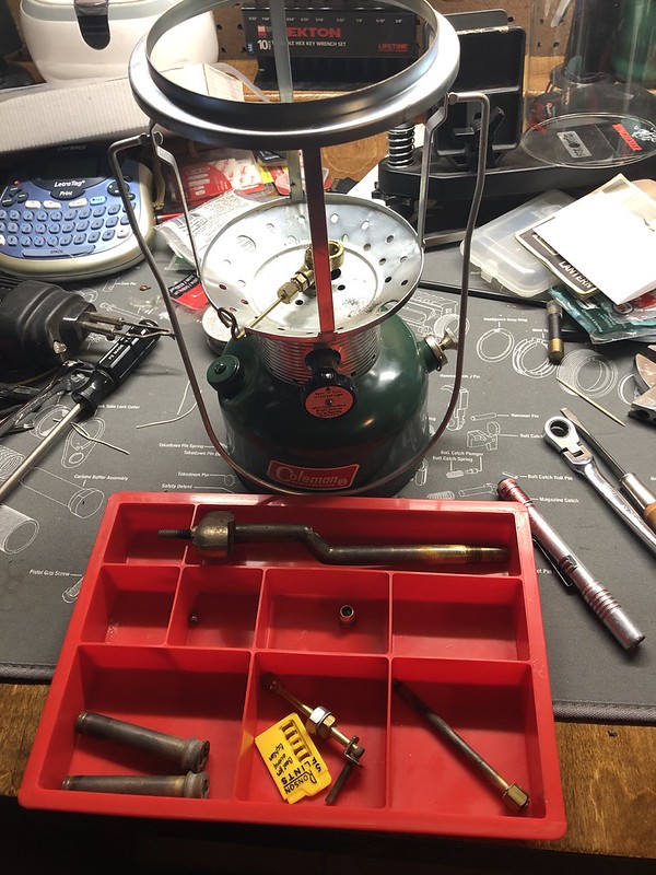

Well I did a thing Saturday...
Made in April of 1965.
It had been sitting for awhile so I checked to make sure the air tube was clear. Also had to oil the leather cup.
