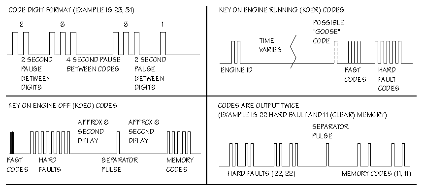

TYPES OF CODES.
NOTE: Some people have problems distinguishing the different codes. READ THIS SECTION CAREFULLY.
There are drawings of the code formats at the end of this section.
FAST CODES.
Fast codes contain the fault information output in the normal slow codes but are output about 100 times faster.
These are the first things output on a Key On Engine Off test.
HARD FAULTS.
Hard faults are problems that the computer has located RIGHT NOW. Examples are a sensor out of range or a broken wire (open circuit).
Hard faults are the FIRST set of slow codes output in a Key On Engine Off test. BEFORE the SEPARATOR pulse.
In a Key On Engine Running test, there are ONLY HARD FAULT codes. These are output right after the fast codes.
SEPARATOR PULSE.
The separator pulse is a single pulse that indicates the END of hard fault codes and the BEGINNING of memory codes.
It will show up as a code 10 on most digital testers.
MEMORY CODES.
Memory codes are problems that the computer has noticed in the past. If for example there was a loose wire to a solenoid that only lost contact while driving but was making contact while testing the system there would be NO HARD FAULT CODE. The code would show up IN MEMORY. The same would happen for a sensor that only went out of range occasionally. Memory codes come out AFTER the separator pulse.
NOTE: The computer will erase the memory after a certain number of engine re-starts if the problem does not repeat itself. The number of re-starts varies from 20 to 80 depending on the year of the vehicle. The later models keep memory longer.
ENGINE ID.
The engine ID in a running test is a series of pulses equal to one half the number of engine cylinders. A 4 cylinder engine ID is 2 pulses, a 6 cylinder ID is 3 pulses and an 8 cylinder ID is 4 pulses. A diesel ID is 5.
GOOSE CODE.
A "GOOSE" code (also called a dynamic response test) is output during an engine running test. This is a single pulse to signal you to quickly move the throttle approximately 1/2 way down and release. NOTE: Not all engines give a "GOOSE" code.
CODE FORMATS.
Codes are output as a series of pulses. The following charts show the (approximate) timing of the various code pulses.
NOTE: Two digit codes are shown. Three digit codes have similar timing. It just takes a little practice to distinguish between two and three digit types.

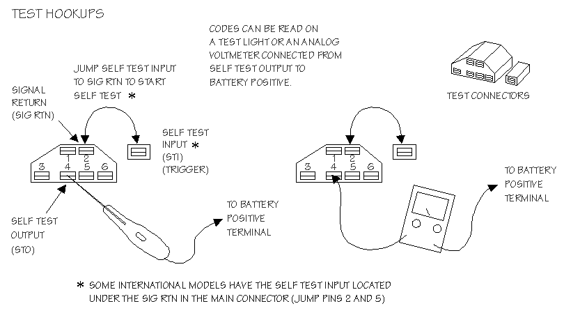

HOOKUP.
See figure below. EEC IV vehicles have two connectors for self testing the system. They are located on the firewall or the left or right front fender. The large connector contains the self test output (STO) and ground (SIG RTN). The small pigtail is the self test input (STI).
Code 543
1. Make sure engine is fully warmed. If in doubt, run engine at 2000 rpm for 2 minutes.
2. Turn ignition off and wait 10 seconds for system to shut off. Make sure A/C is off and transmission is in Park (automatic) or Neutral (manual).
3. Hook up light and jumper (or a tester if you have one). Turn key to ON (do not start engine).
4. Fast Codes are output (ignore fast light flashes).
5. Read hard faults.
6. Separator Pulse.
7. Read memory codes.
8. See code explanations and check components as necessary.
Use FIRST CODE OUTPUT and retest after any repairs are made.
