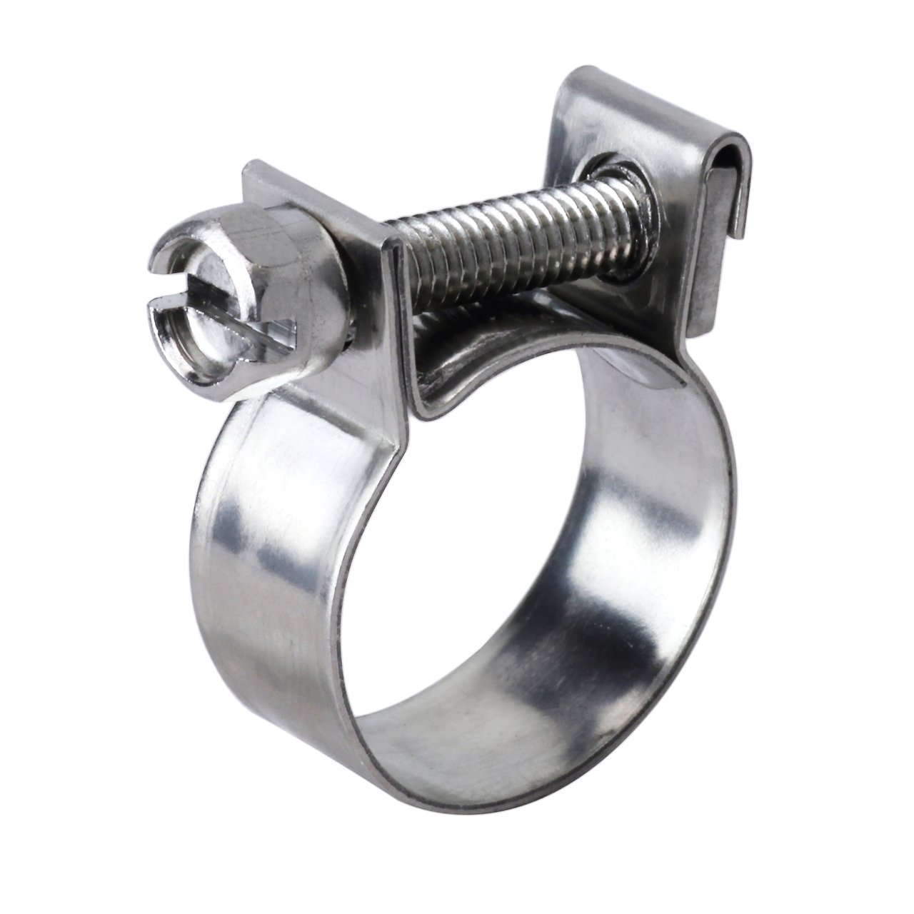

You could even use regular rubber fuel hose, just make sure that you get stuff rated for ethanol and enough pressure. If you use regular fuel hose get the clamps made for EFI, they are a little different than the normal worm drive hose clamp and hold better with the pressure.
