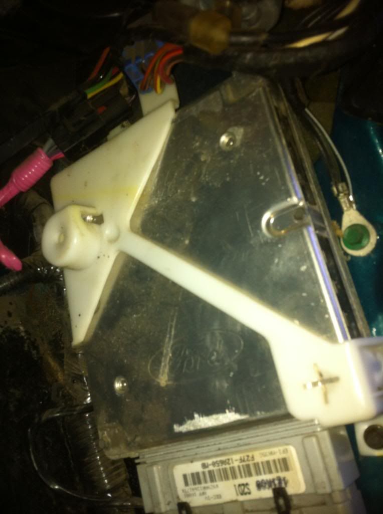

There is no relay in there. All the switching in the computer happens with transistors.

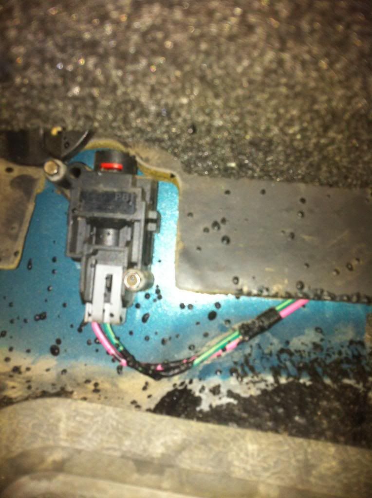

Exactly what i'm afraid of, whatever it is is on its way out, no doubt- I took the panel off and here is what I see:

What is the pink/green wire device? Its passenger side by your left foot
That bottom picture with the pink/green wires I believe is the fuel pump shut of switch which is inertia activated during a collision to stop fuel delivery. Someone correct me if I'm wrong.

The fuel pump cutoff switch I don't think makes any noise, if it is its faulty. Does this thing click even say sitting in your driveway? If so that would be a good time to pull that cover off the kick panel and have a listen. Its kind of hard to find noises when you are driving down the road.
