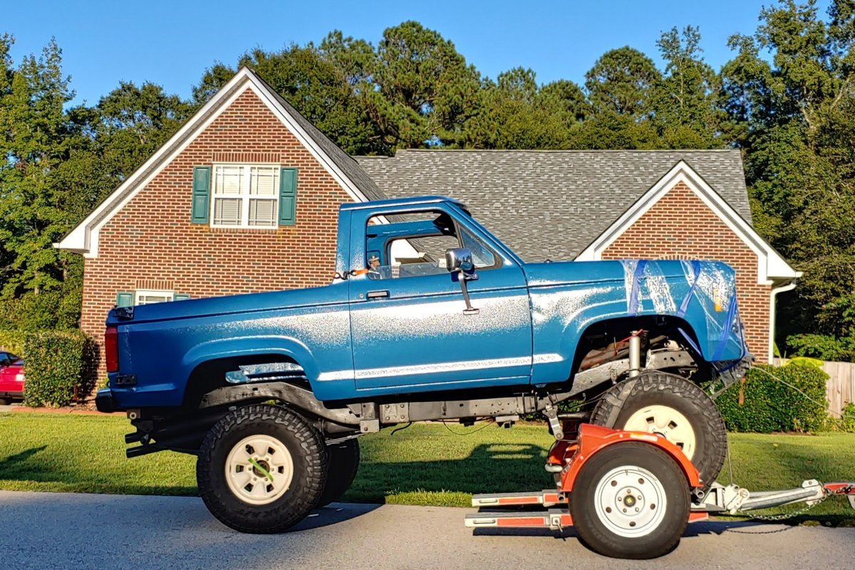

So I temporarily bolted my trailer winch to the front bumper to load it on the tow dolly. I need to buy a dedicated winch for it, any recommendations?

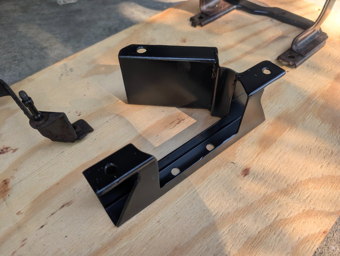

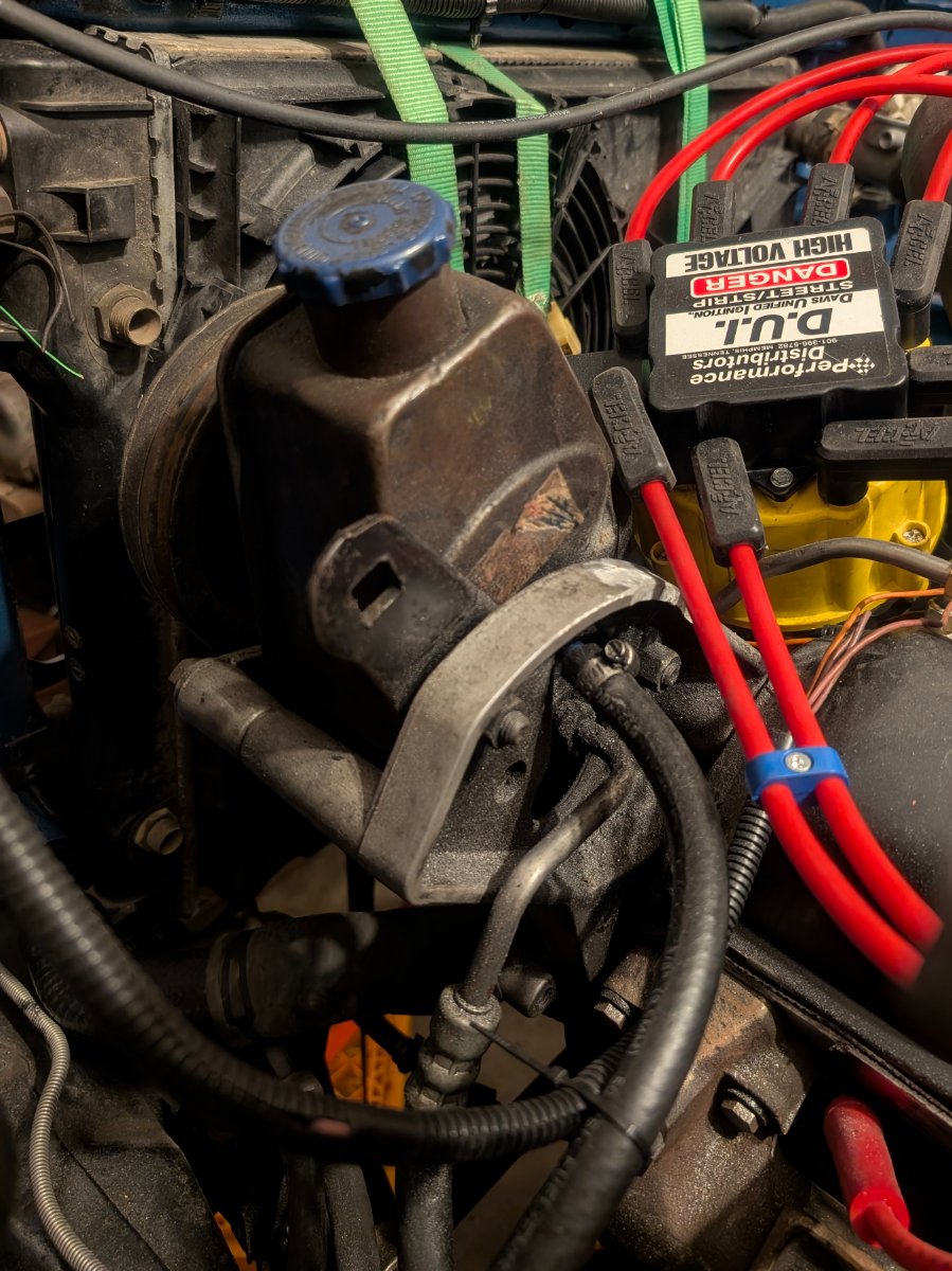

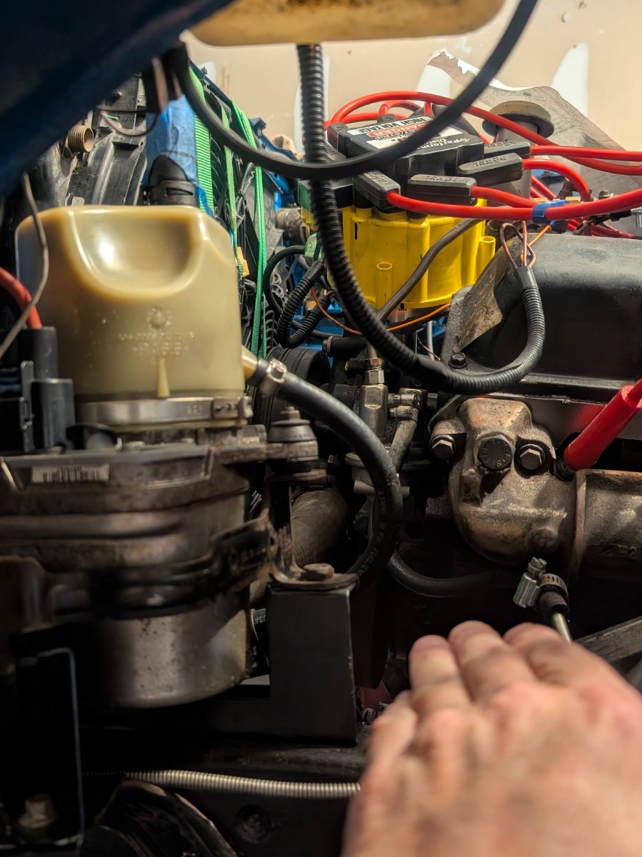

I made a bracket to mount an electric power steering pump onto the frame rail. The old belt driven pump was in the way of the new HEI distributor cap.

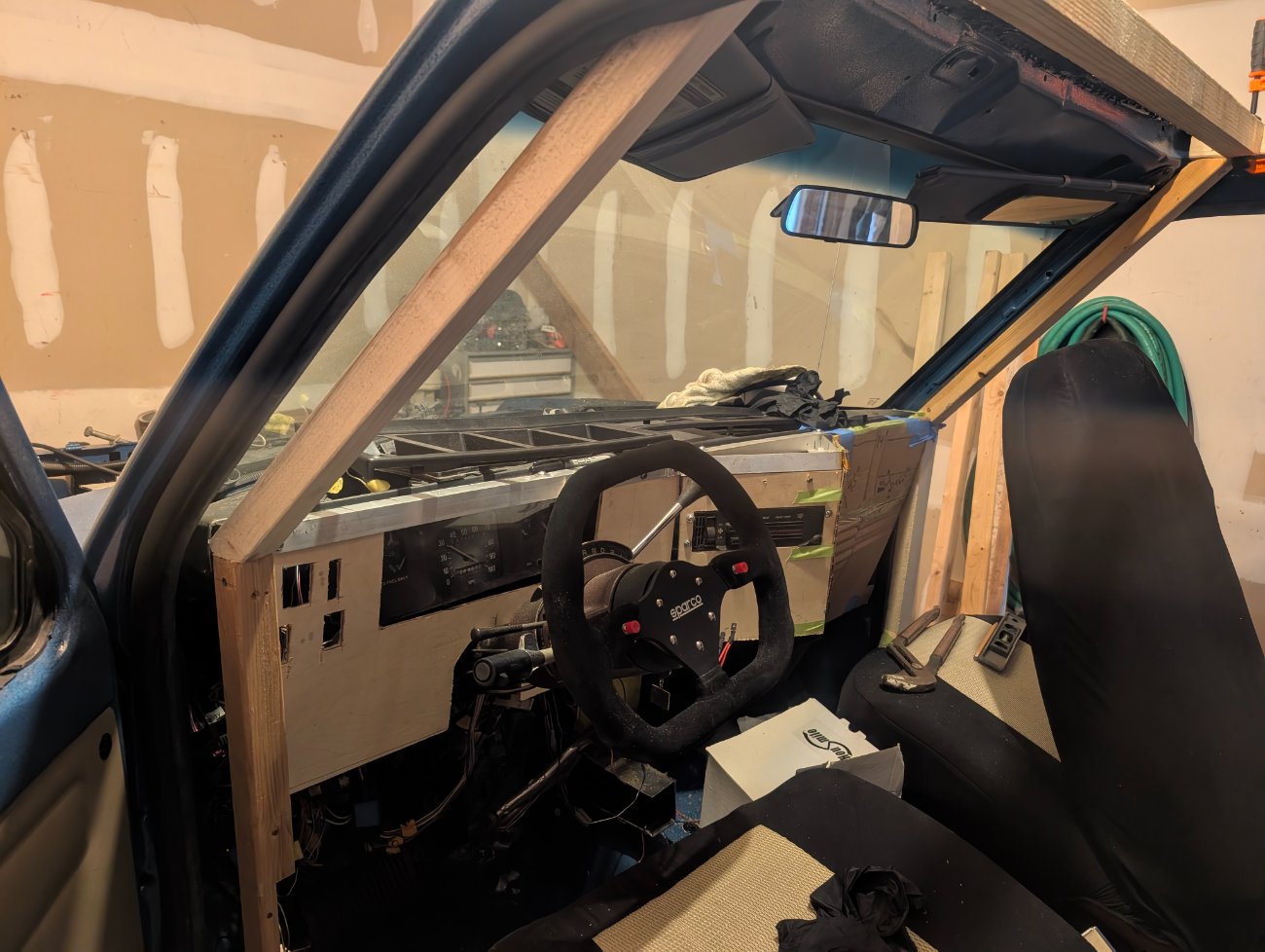

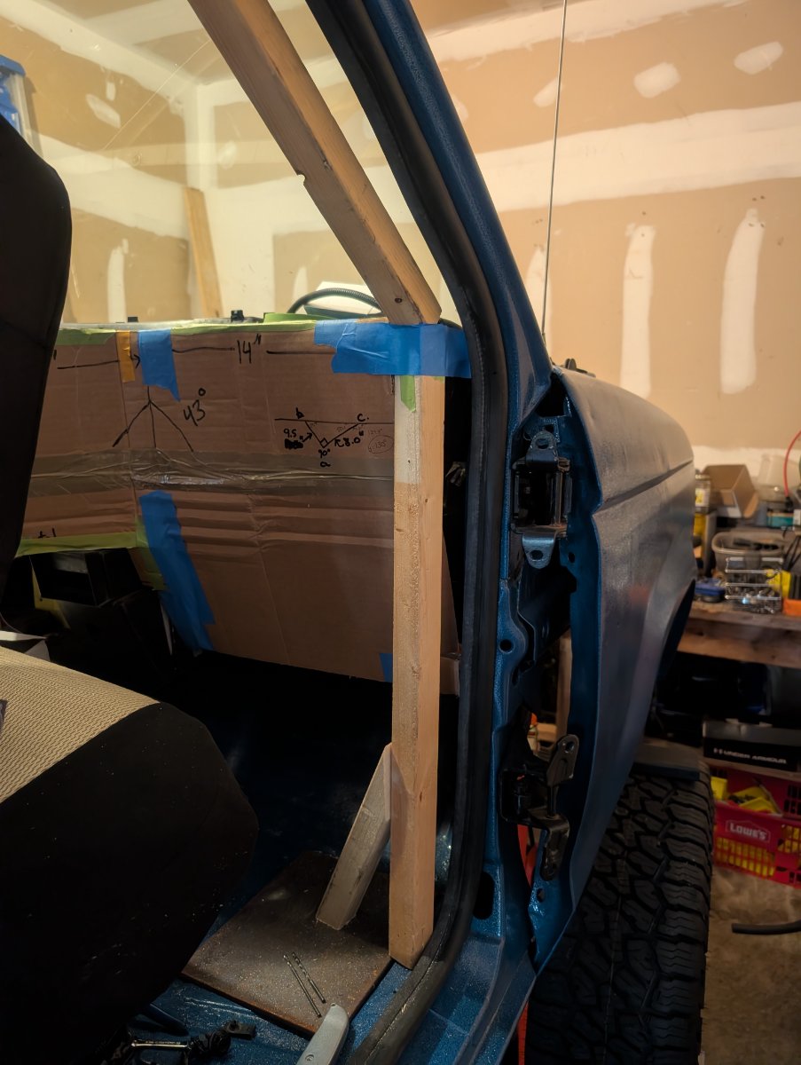

Also, I hated the dash... so the mock up of a fiberglass dash begins. Also, the mock up of the roll cage.
