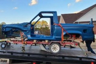

Chopped Top B2 on Wagoneer chassis

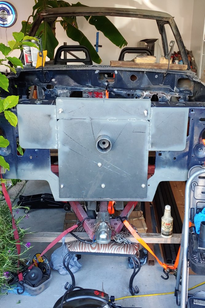

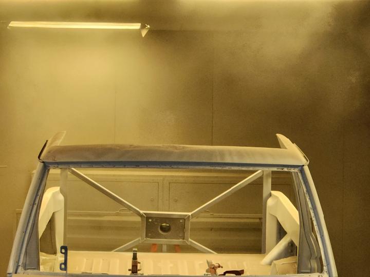

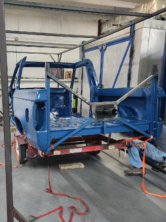

I built a rotiserie to hang the body on so it could be powder coated.

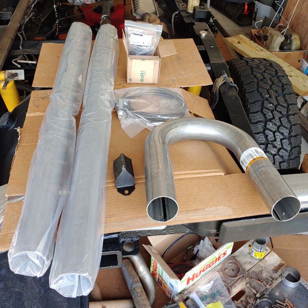

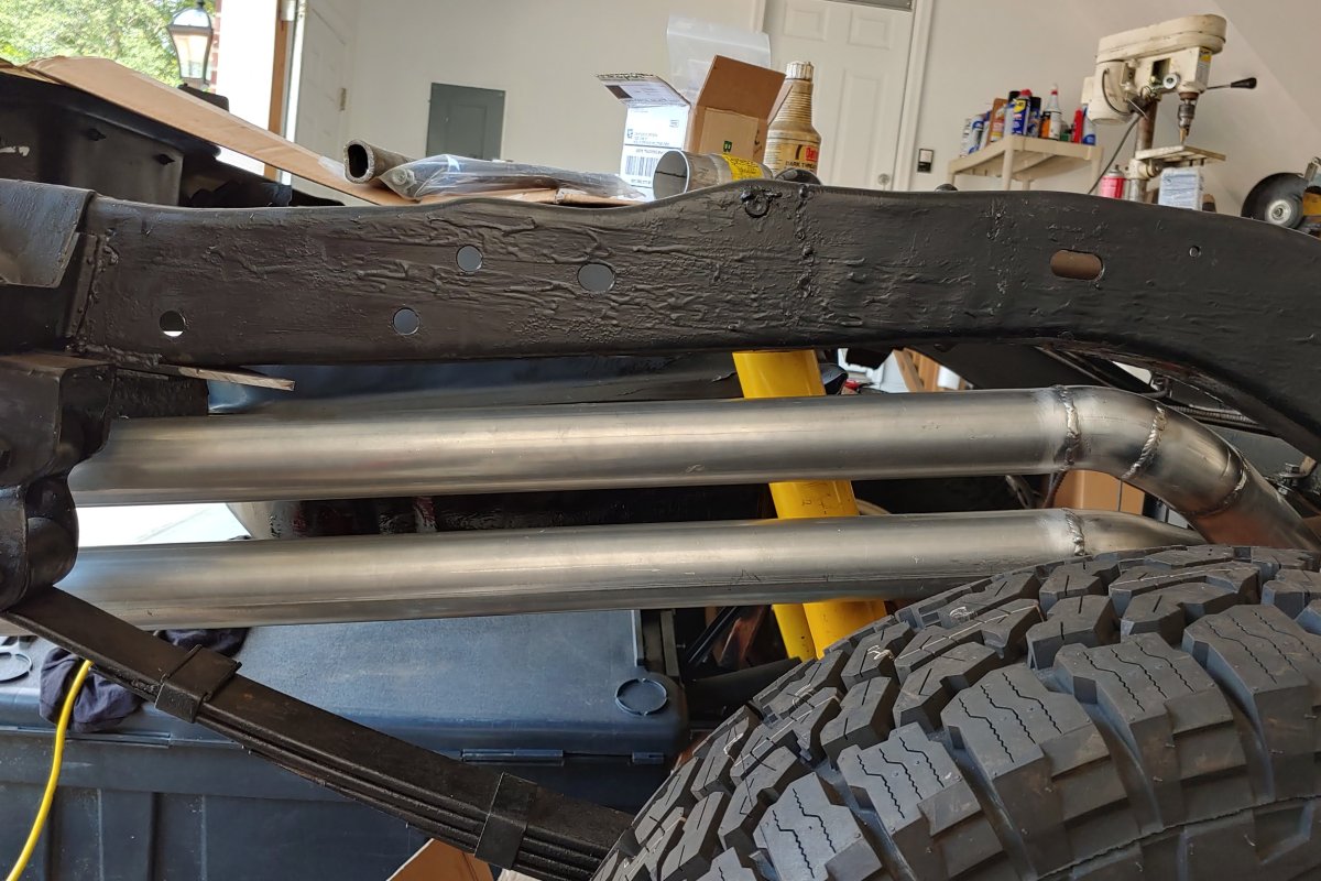

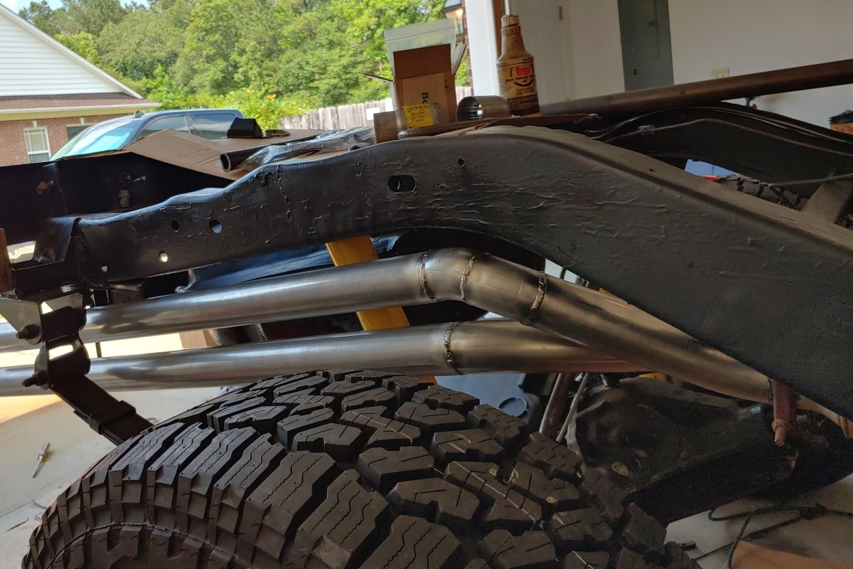

Bought some tubing and made an exhaust.

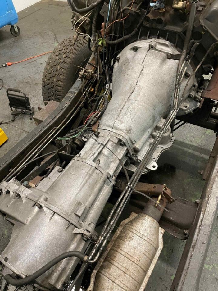

I had the entire chassis, engine, suspension, drivetrain dry ice blasted. Not worth it :-(

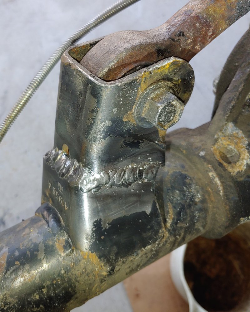

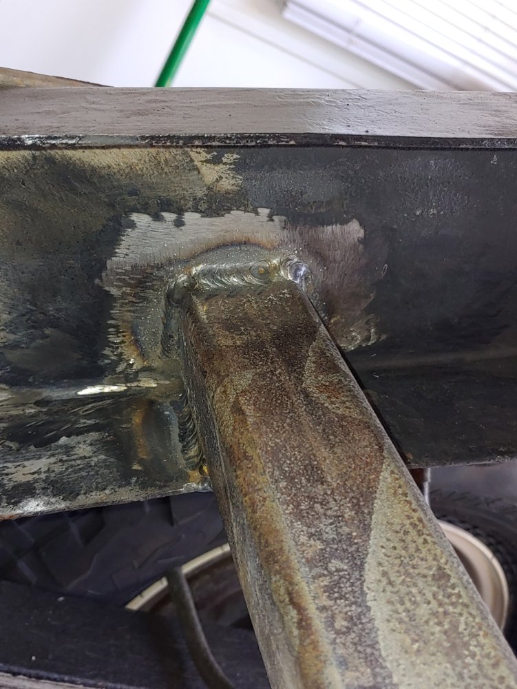

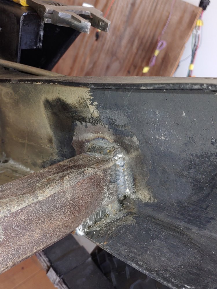

Needed to cut and move the track bar mount to accommodate the 6" lift. And welded in a new cross member in the rear.

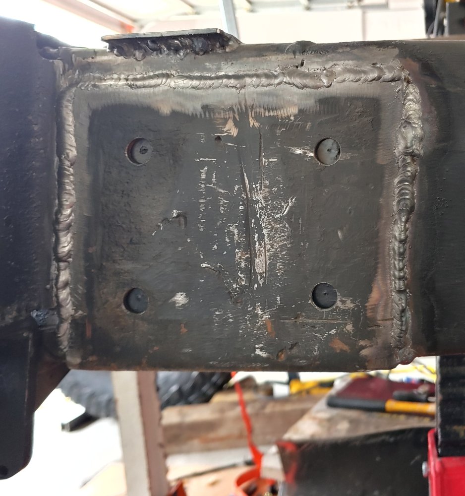

Picture of the plate welded over the welded seam where the frame section was spliced. 14mm bolts will go where you see the holes.

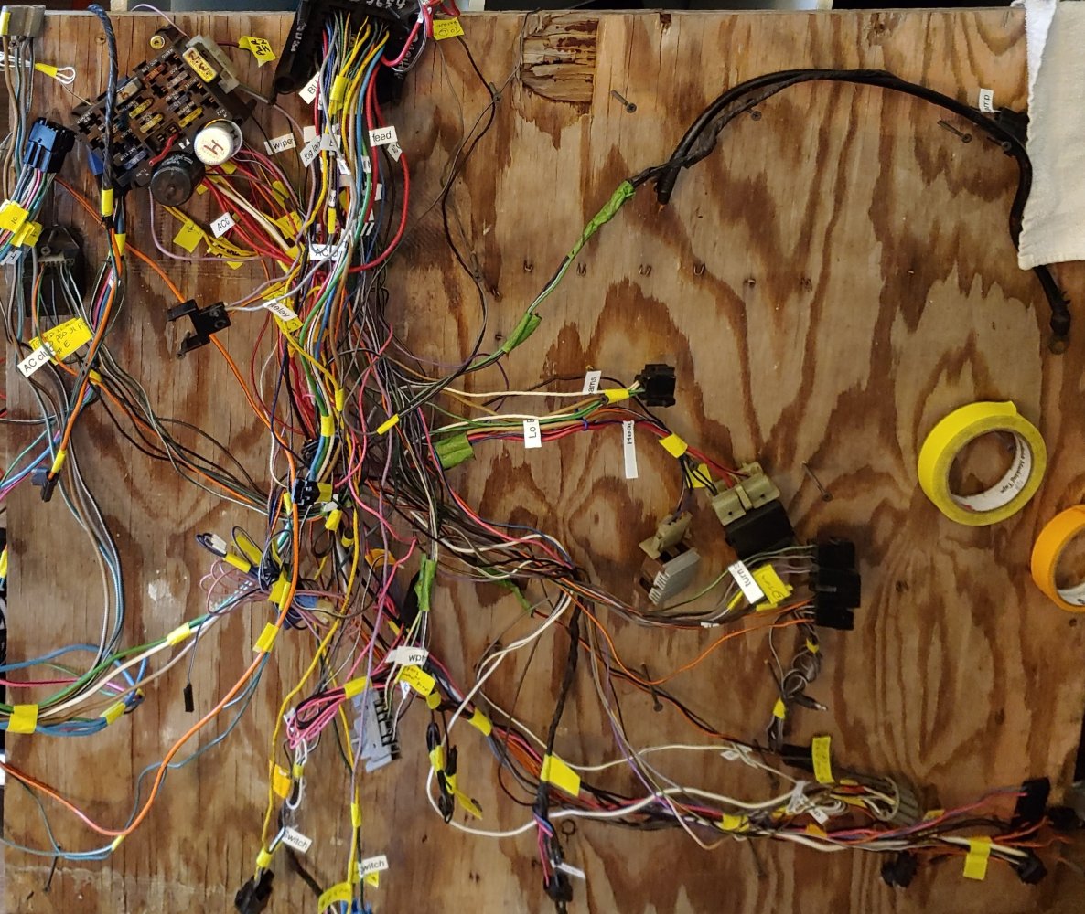

Sorting out the wiring harness.

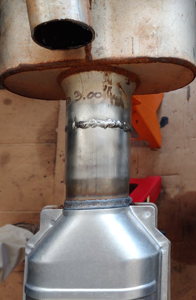

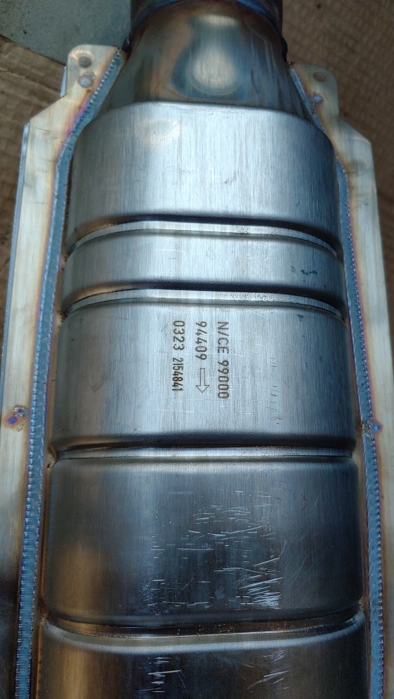

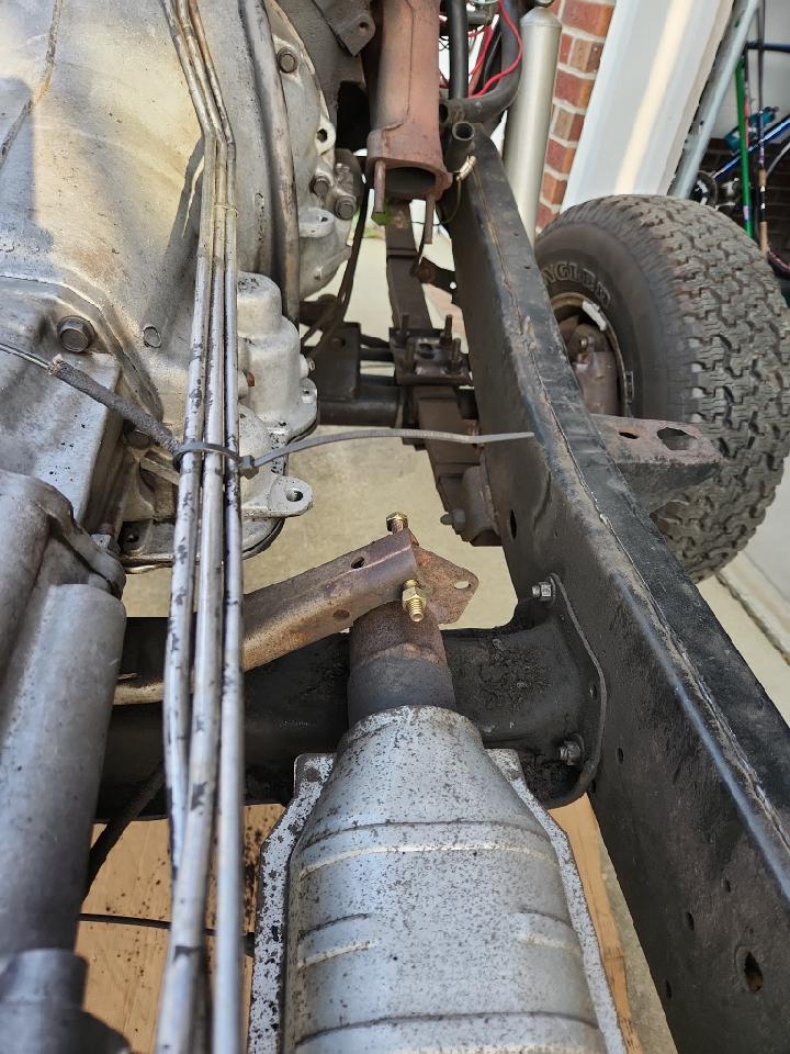

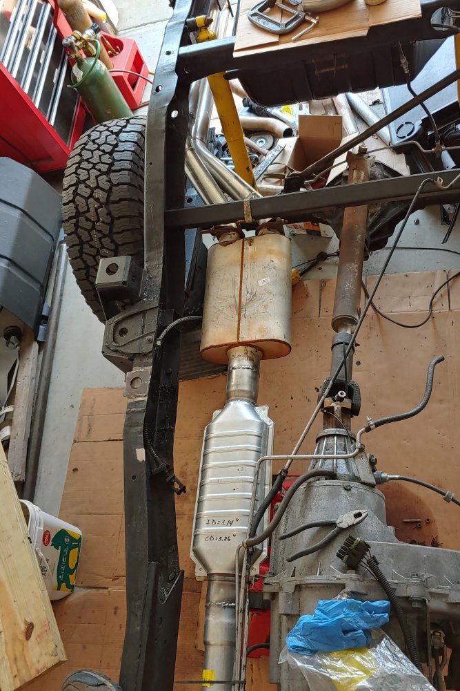

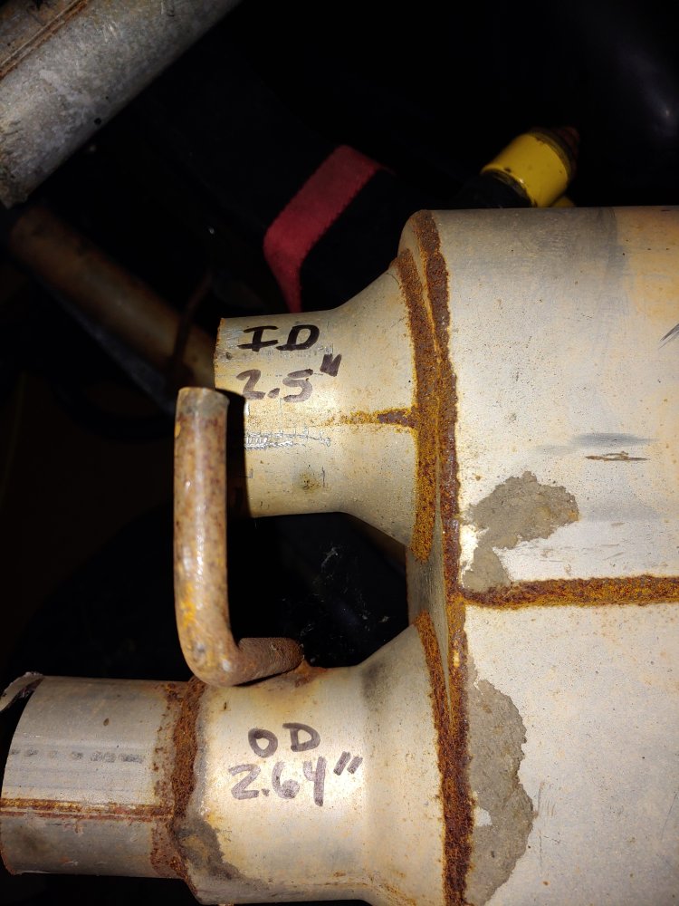

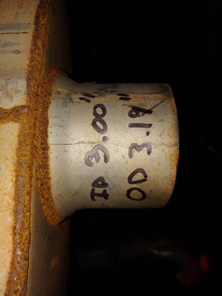

Muffler is 3" in, two 2.5" out. A new 3" CAT was installed too.

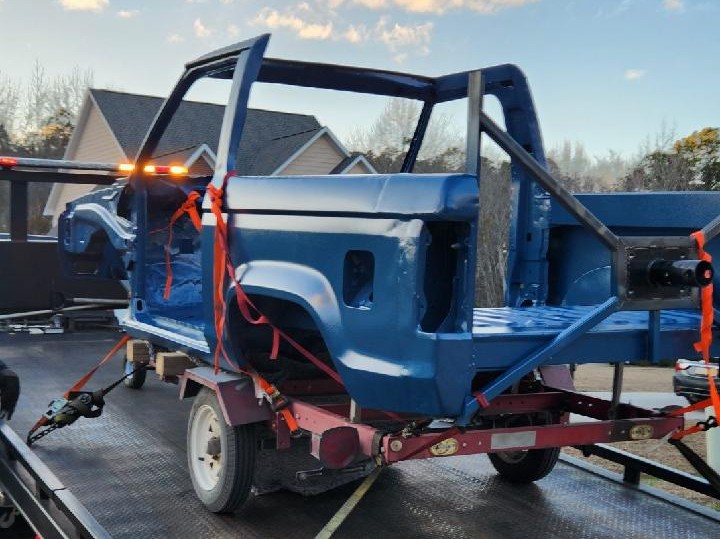

Another view coming home.
Why did you consider dry ice not worth it?
I have a very rusty pinto I'm going to be working on. Was considering ice, soda, and sand. I don't have personal experience with any. My racetruck was sandblasted but not the body panels.
I had watched some videos where the underbodies of a Porsche, an Audi and an old Ranger were dry ice blasted and I was impressed. Those cars had a lot of grime and crud that didn't wash off in the video but came right off with the dry ice blasting so I was excited to have it done. Not even half the crud was removed from mine and it still looked like crap. I believe I could have rented a steam blaster and got better results for a fraction of the price paid getting dry ice blasted. As far as rust, dry ice blasting will NOT remove rust. For that I would recommend the soda blasting. Sand blasting can easily warp body panels if not done properly but will remove a lot of material really fast. It will also create a LOT of heat so be careful.
