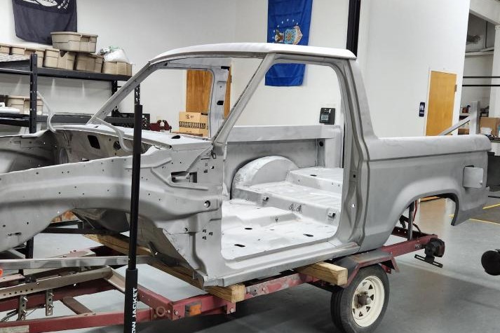

Chopped Top B2 on Wagoneer chassis

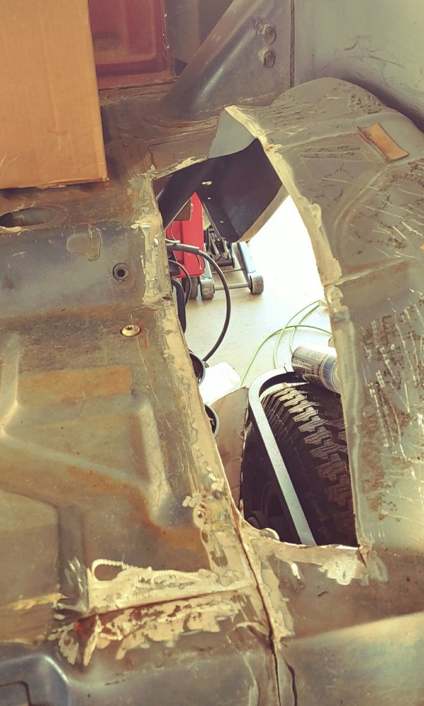

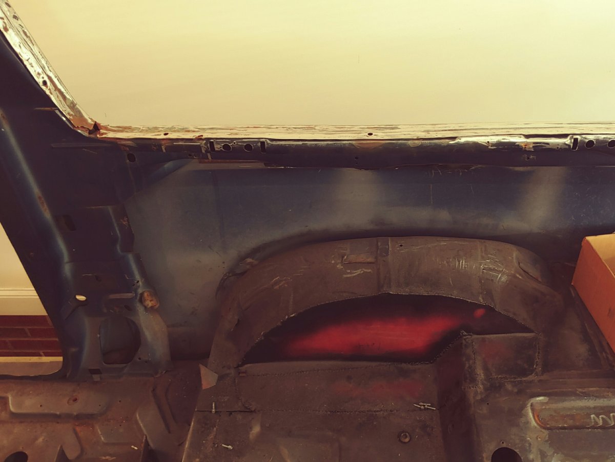

Wheel wells narrowed. Originally to fit a Ranger bench seat but we decided to leave it open. It's going to be a two seater now with a wider bed interior.

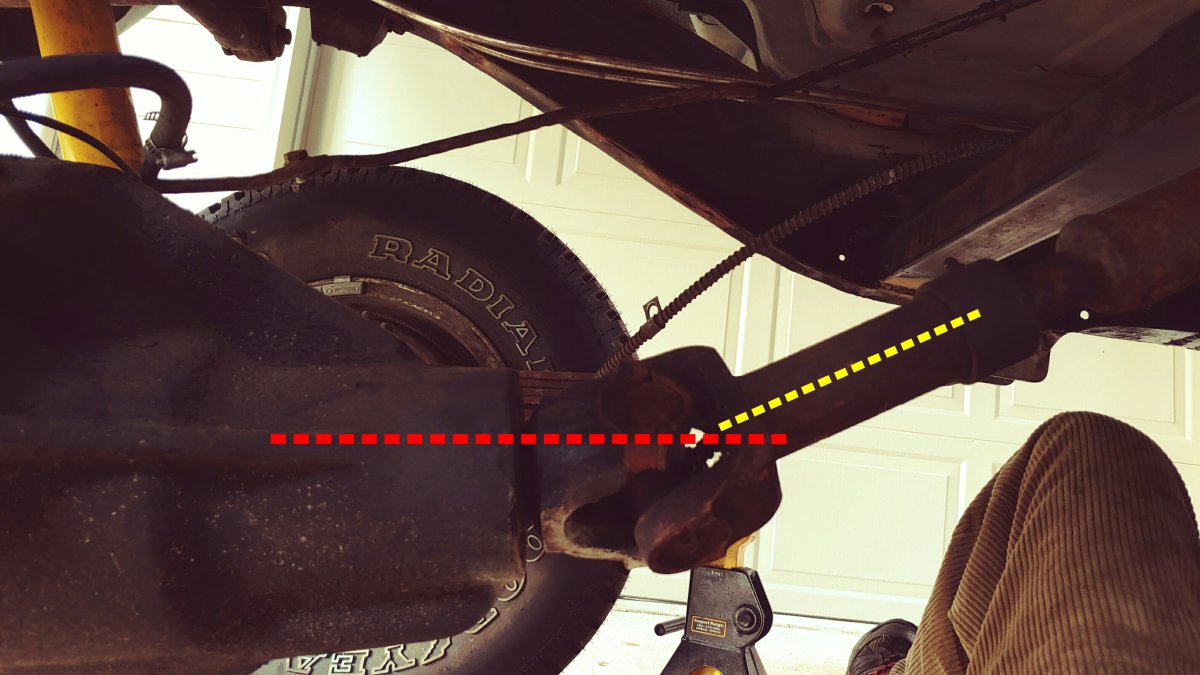

The shortened wheelbase posed a problem with the drive shaft angle. Wedges we're put between the axle and leaf springs the fix the angle. (the wedge rotated the differential, moving the universal joint upwards.)

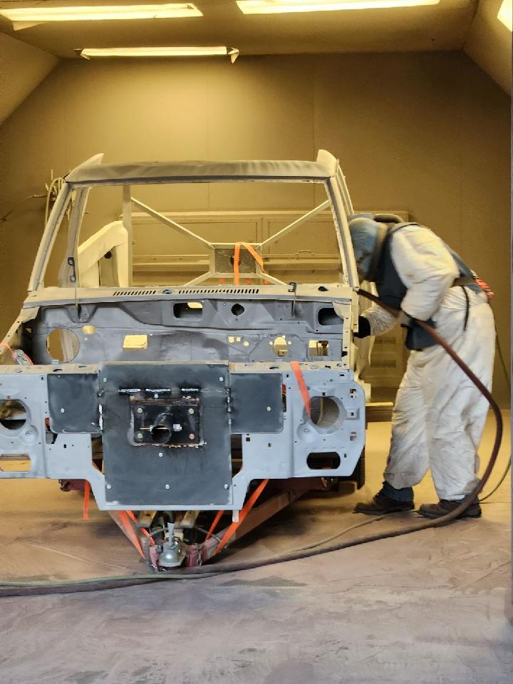

So as it sits now, all body fabrication is complete, it's time to get it powder coated. I'm thinking the original blue and tan... But silver or black would look nice too... what's your thoughts?
So as it sits now, all fabrication is complete, it's time to get it painted. I'm thinking the original blue and tan... But silver or black would look nice too... what's your thoughts?
Keeping the original colors would be cool. But. I've had a black Mustang sine August 18, 1990- it looks great when freshly washed for about 5 minutes before dust settles on it. I bought a new 1999 silver Taurus that looked great when I waxed it and still looked good after driving it 2 weeks including rainy days. Are you building something to polish and show or is it going to be a driver? My NH state truck orange Ranger is almost as forgiving as silver, too.
This will be a weekend driver, light off-road, beach vehicle. It'll be driven up at Uwharrie once or twice but not regularly. It'll have SCUBA gear in it at the ocean more than driven on the trail.
Silver... with woodgrain to pay homage to the Wagoneer!
A Bronco in Wagoneer clothes?
