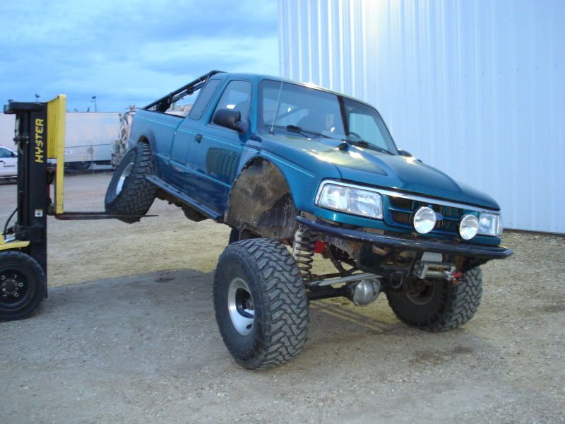

'Our' trucks looked good...... now they just collect dust! haha....
