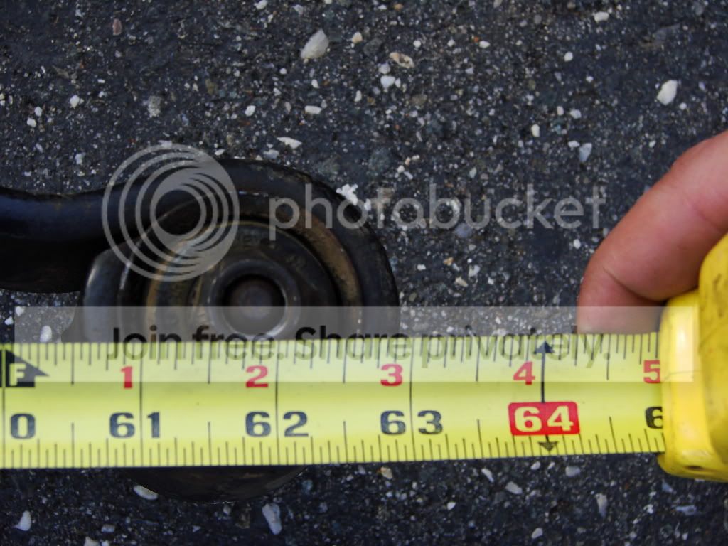

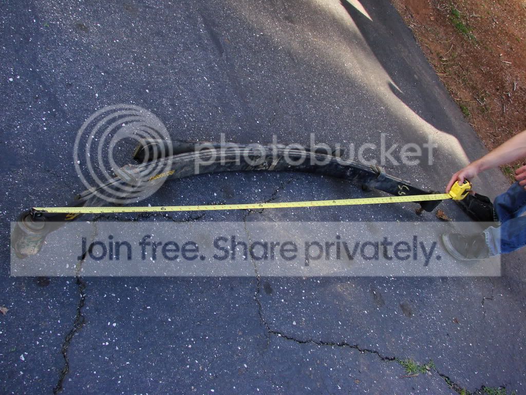

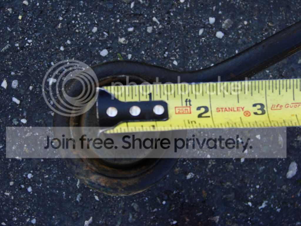

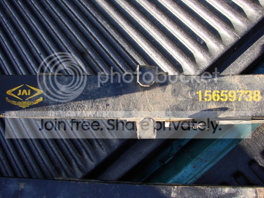

Finally had time off work to post this.. I got these off of a Chevy 1500 4x4 the other weekend for only $25 a pack. But they are not the original ones [I'm assuming]. They look they are just replacement ones. They have "JAI 15659738" on them. I looked it up and didn't come up with anything.. Hopefully they will still work for this swap.. I am a little worried because None of the leafs at the JY measured 63".. Most were like 57" or something.. These ones are 61"and 13/16", but once under pressure they'll probably lengthen a little. Unless I'm measuring these all wrong they are not 63" 'eye to eye'.
Here's some pictures.

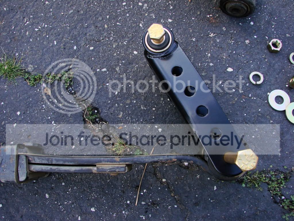

The Bellteck 6400 shackles, and 9/16" x 5.5" grade 8 bolts.

You're good, they are measured as if flat.
Richard
That's why they are also known as 64" springs.
Mine and all others I've seen in the j-yards have measured 64". I have another set out back for my 98, they measured 64" too.
I always use a seamstress tape to measure anything not flat or straight.

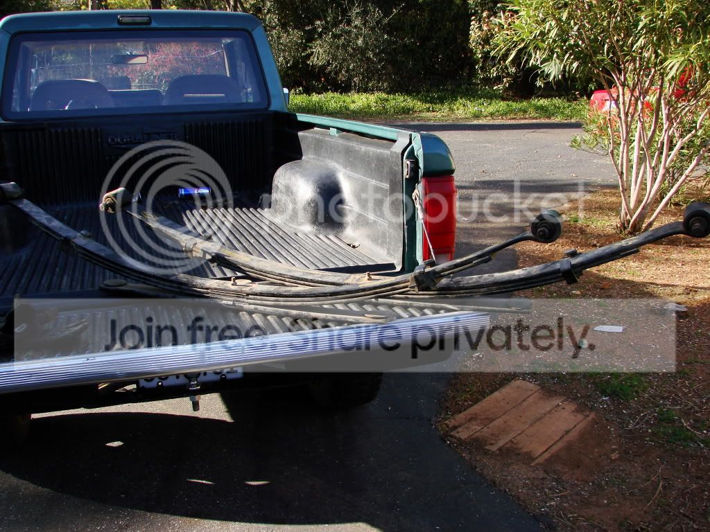

my new leaf pack, just for the record....64" chev main, chev 2nd, chev 3rd, chev 4th, ranger main minus eyes, ranger 2nd....all re-arched to 15"

I wonder why the ones i measured were no-where close to that. And I'll have to measure mine with a seamstress tape also, see where it's at that way. Has anyone heard of the brand i have?

Those look awesome man! where did you get those 'clamps' [don't know the actual term..] to hold the leafs in place?
