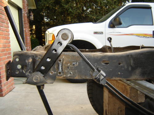

i'm aware of the front clearance issue with the supercab/bed wount in the front. Some say no mods to the bed (rear shackle end) but i just crawled under and it looks like it'll interfere hardcore. the picture below (stolen from another TRS forum) shows it sits above the frame, and my bed sits on the frame. suggestions? angle grinder and welder? i'd like to see what some other people have done.
There will be no interference with inverted stock shackles...

I built a crossmember to lower the shackle mount. This was for changing my ride height but could be used for extended shackles;
Richard
