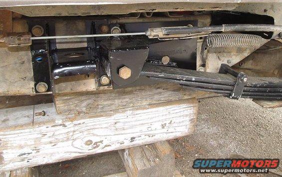

There will be no interference with inverted stock shackles...
If you re-use the STOCK shackles and hangars and rotate them 180 degrees and re-use the existing bolt holes there is no crazy measuring.

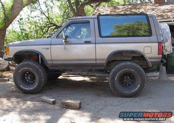

I just bought a set of Pro-Comp Chevy springs to go under my BII (pt# 13211, 3.5" lift).

7" of that length is ahead of the axle (everything I've read says they are 6"), leaving the last inch on the shackle side. The center pin is also NOT centered front-to-rear, it's offset right about ¾", so apparently they do have a front and a back (I read at least a few posts saying they were the same front & back, they are not).
Normally none of this would be an issue, however in dealing with the cramped space next to the BII's middle body mount bracket, it all became apparent when things weren't ending up where I was expecting them to.

Lift with the Pro-Comps came in about 2" above what the Skyjackers provided (or about 5" lift).

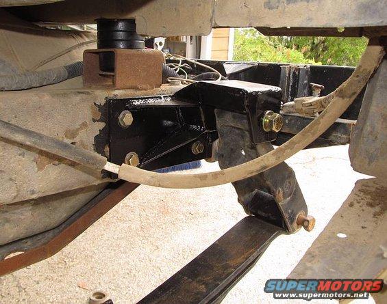

move front spring hanger forward 6" but don't invert.
You may have to move the rear hanger back an inch or two but DO invert. A longer shackle will drop ride height but give more articulation. 2" longer shackle lowers ride height ~1". Take a look at your shackles now, they point down to the spring eye. Imagine them reversed and you can "see" how they can droop more.

Move the front hanger into the old holes that are furthest forward? And I totally missed not inverting the front hanger, my goof. I guess I was really focused on the rear hanger. I wish I had my truck to look at, but it is six hours away up north (im in college). Can you give me a rough estimate how long stock ranger shackles are?
