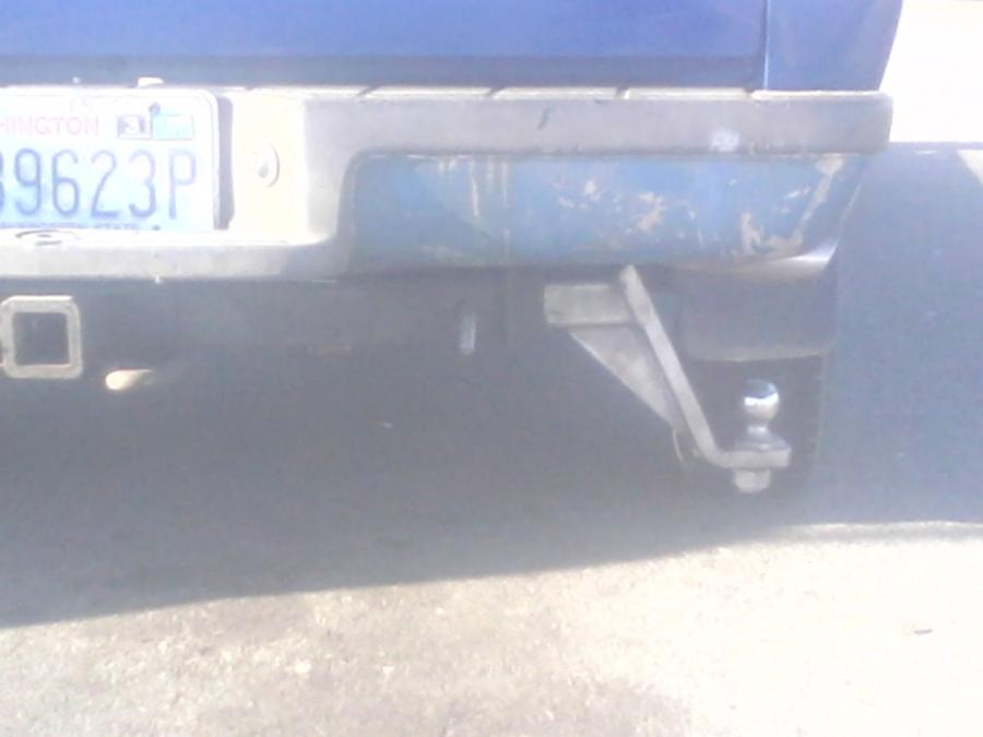

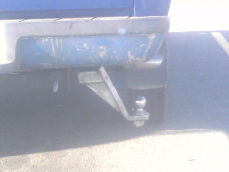

hitch storage so you or anyone else wont smack the hell out of there leg as they walk behind the truck. I drilled a 5/8 hole thru the cross tube that extends beyond the frame mount flange to allow for storage when the receiver isn't being used.

1 that makes me chuckle a little. Nice idea. Just looks strange.
2 I like the hitch as "protection" if someone is to rear end me or get to close in parking lots.
Other than that, it's a great idea. Sure beats it rattling around or laying in the bed not locked when you live around Memphis.

Yeh I under stand the protection ,but I will be making a very stout 4x8 rectangular tubing w/3/8 thick wall. 4" tall & 8" deep. & it will be atteched to frame using 3/8 2x6 I-beam material
