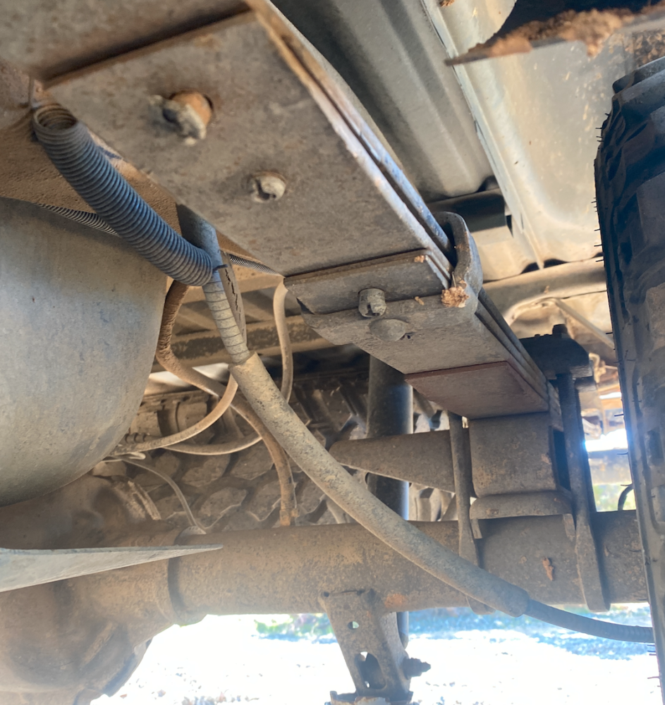

I see in the picture below that truck (if it's like yours) has a interesting bolt on bracket on the bottom for the shock mount. I think I would unbolt that and modify it so it was 4 inches higher and then just use the stock shocks. Also don't forget about your brake lines, you can lower them and re-bend the hardline to make them fit.

That lower mount on the pic above is stock on a Dana 28, they had double shear where the D35 is single shear on a stud... can't really move it up as it's just 3 holes drilled in the radius arms with a bracket on the outside...
