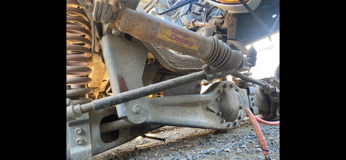

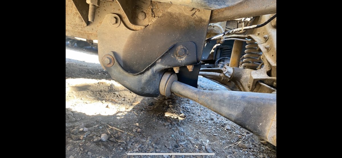

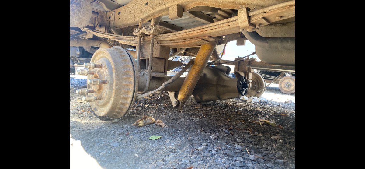

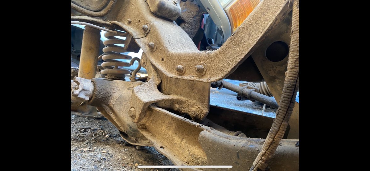

So I stopped by a local wrecking yard that has a lifted ‘86 ranger and snapped some pics of the hardware. Curious if any of you are able to ID this kit. The shocks say rough country but I’m wondering if this is the one this website warns everyone about because of potential damage to the differential with the poorly made drop brackets. The owner of the yard said he’d want around $200 for all the components. There might be some wiggle room on price when he better understands the components I’d be taking. I believe it’s mainly just the drop brackets for the radius arms, front coil springs, shocks all around, blocks in the rear, u bolts, and maybe a pitman arm and the camber bushings? Looks like it also has a steering dampener I supposed came with the kit as it also says rough country. Am I missing anything? If this is one of the more expensive kits then it’d be worth the effort of prying everything off even at $200 but I don’t really feel the same way if it’s just a $5-600 kit new. Here’s some pics if anyone can help me with an ID and if it seems complete:

However cheaply made it is, that will be the better way to lift it than just using spring spacers or taller springs. If it ends up having the cheap brackets, you could probably beef them up if you had a welder.
  • Like
Reactions: gaz
Yeah that looks like a Rough Country kit.
The main problem with those kits is the drop plate extension used to drop the OEM bracket for the passengerside axle beam. It is possible to modify it, but is bit of work (and does require a welder and a gusset or 2 to have it remain sturdy)

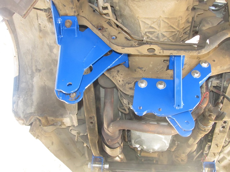

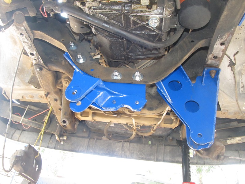

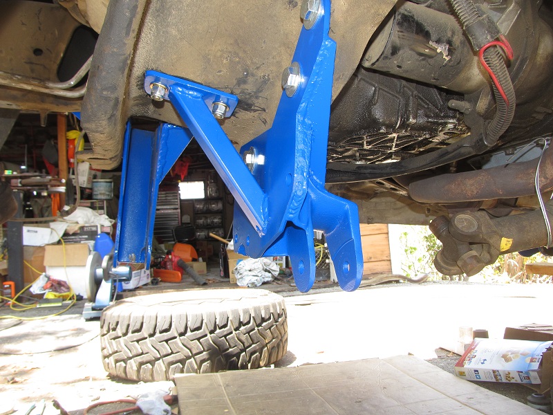

A friend of mine bought an Explorer Sport with said kit on it a few years back... Rather than ditch it, we beefed up the brackets, cut the offending part off the drop extension & OEM bracket, put on a set of extended radius arms, new steering, and XJ springs, and it actually turned out pretty well.
A few pics of the modded brackets:
That modded bracket looks very similar to the Skyjacker bracket. Actually looks heavier.
That's kindof what we were going after when widening the bracket for the driverside axle (the design of the STX Highrider bracket came into play too). I've seen another kit that had a similar (but less robust) brace for the passengerside axle bracket, though I don't remember what brand it was.
I think I'll go grab the rough country lift kit from the yard tomorrow and maybe I'll make some modifications to the drop bracket. If the shocks on the truck are shot does anyone know what my options are for buying new ones all around with the 4" lift? Do I need to buy some new rough country shocks specifically or do I have other options that will reach? And more importantly it sounds like with a 4" lift I should move up to 31" tires. Would I need to re-gear if my truck has the F7 axle? Apparently that would be the 4.10 limited slip. Thanks
