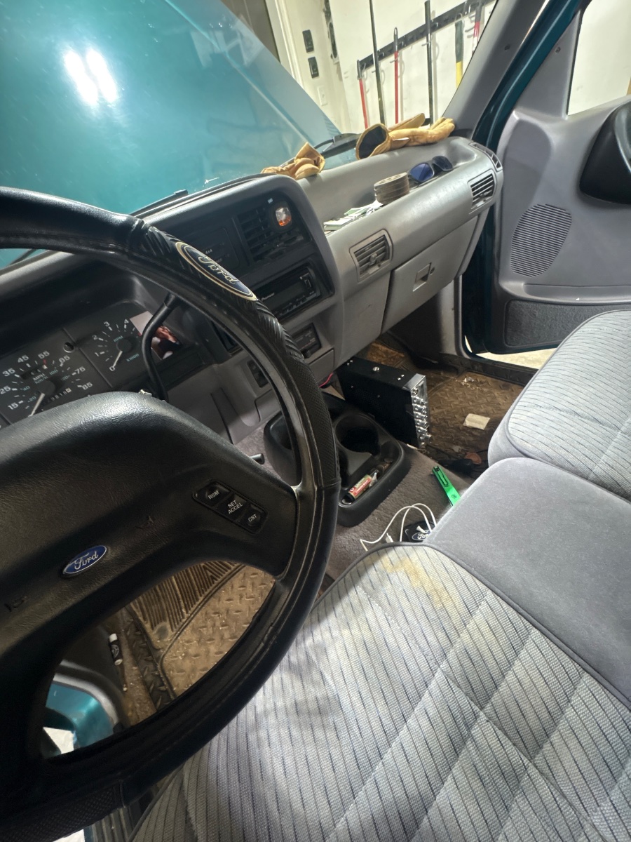

Well guys got the cb in an my antenna on I’m not sure people can hear me? I don’t know I never get a response back

With the exception of “skip” conditions, range, even with a 102” whip, is relatively short unless you use illegal means to increase power. Add in that a lot of truckers don’t respond or don’t have a radio on anymore and that a lot of ordinary folk aren’t using CBs anymore and sometimes there’s just nobody in range to talk to.
Back in the early 2000’s, like up to about 05-08, there was often groups of people chatting on the CB at times. A lot of truckers used CBs and would typically respond at least to questions about conditions if you asked it right (Hey there Southbound/Northbound/Eastbound/Westbound, what did you leave behind you?). That sort of thing. Nowdays even asking like that often results in silence and I’m suspecting it’s a lack of CB radio use rather than people being difficult.

Your transmitting range is likely reduced without having the antenna's SWRs tuned. You can hear others, but you're not able reach them with your radio.
You could try parking at a truck stop, or just close to an interstate, in order to get closer to other CB radios to see if you can get a response.

Also, you can often receive from someone running a linear amp (illegal) or the like but not be able to talk to them because they are out of range. Used to pick up transmissions from Mexico and stuff, they would hog a channel and usually the channel above and below would be unusable because of the bleed over from the power they were putting out.
