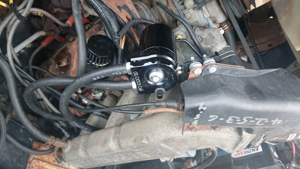

Installed catch can under the throttle cable bracket. Figured out that the lightweight filter foam that comes in 100mL antibody/serum shipping boxes is the exact same size as the "filter" canister on the "out" side of the Amazon can. Cut off a slice and stuck it in. Fluffed up a stainless steel pot scrubber and put it in the body of the can. Plumbed can backwards so that the pcv went into the "out" side of the can, and the "in" side attached back to the pcv port in the plenum. Hooked up backwards so that the engine vacuum would draw through the filter on the driver's side via the pcv, gasses would flow into the stainless media, then foam filter (hopefully blocking stainless steel shrapnel from entering the throttle body), then exit the can into the pcv port in the plenum.

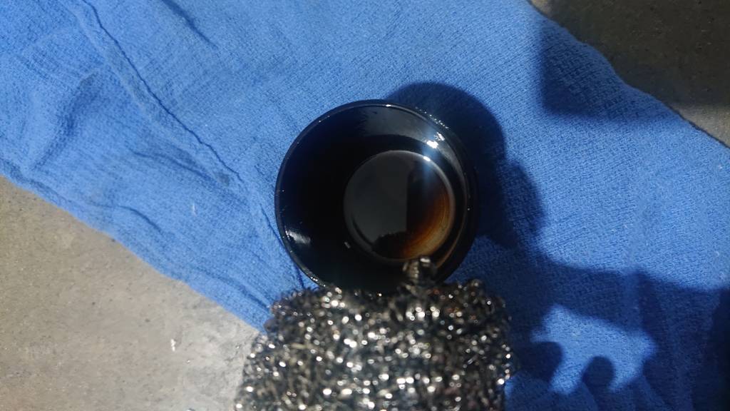

I DID NOT clean anything. Just hooked up the can. Went for a drive. ZERO ping. I mean zero. Nada. Zip. Zilch. Idle usually was at 1000-1100 when the engine was at temperature. Now sits at 800-900, and all hesitation and roughness is gone. Exhaust smells noticeably different. Noticeable new "pep" when pulling out from a stop. Checked the can after 50-ish miles. The media smells like a fraternity couch was thrown into a volcano, and is oily.

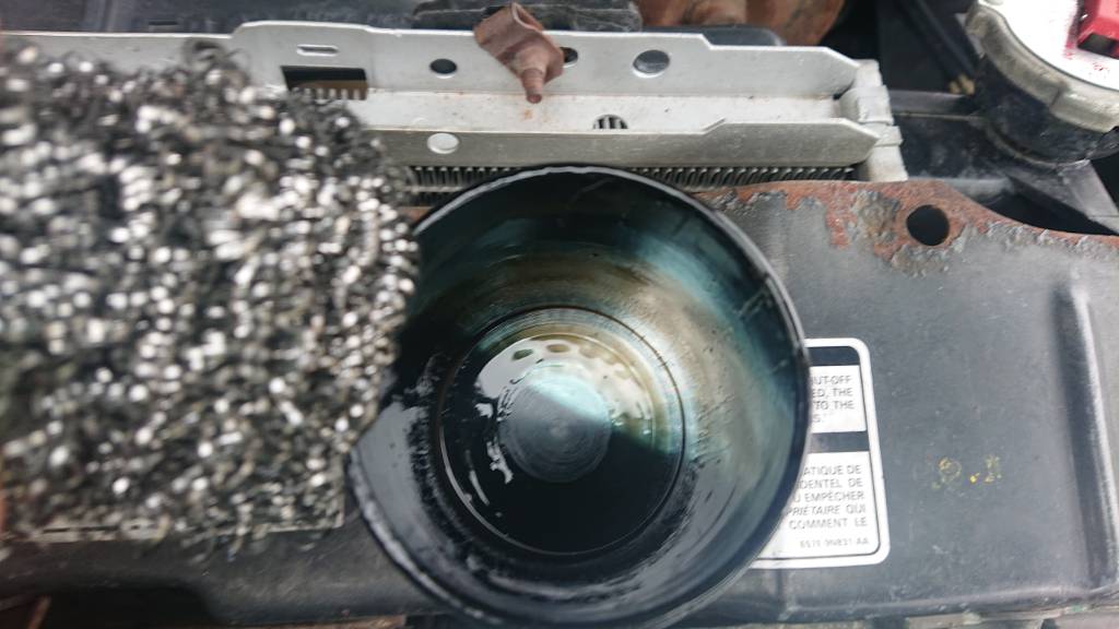

Photos are of the crap amazon can, the backwards plumbing, and inside of the oil catch. The stench is indescribable.
Oh, something else worth noting - my truck would roll white/grey steam rather heavily, maybe 2-3 times as much as one would expect. Made me think I had a cracked head, but does not look likely. It no longer steams/smokes any more than any other vehicle. _20190213_094404.jpegDSC_2254.jpegDSC_2258.jpegDSC_2259.jpegDSC_2256.jpeg

Im not 100% behind your reasoning for running it backwards since it should be baffled to function in one direction anyway.
On a better unit, I'd absolutely agree with you. This one is not baffled, though. What they call a baffle is two screw together cheese grater style discs, which I popped a filter between.
