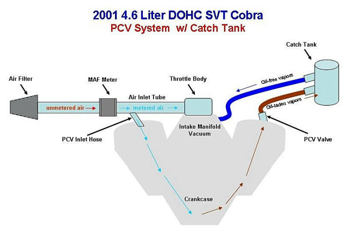

With no vacuum source, crankcase air isn't being actively sucked out of the engine and into the catch can so it wouldn't do anything that a regular old fashion breather cap could.
And if you use a breather cap on the catch can with the pcv system as it should be. All you've done is create a vacuum leak...

I agree. Without the PCV system operating, only the blow-by would be escaping into the catch can. And if you removed the breather and PCV you would have to plug the PCV port at the throttle body. In the end, I think PetroleumJunkie412 has it right, with the catch can spliced into the PCV hose between the PCV valve and the throttle body PCV port, with the breather intact.
This was the best diagram I could find on how a catch can should work. It should be installed as a sealed part of the system, under vacuum from the pcv side. I've seen people use 2, one on the fresh air side but this makes zero sense because that is incoming fresh air, theres nothing to catch... but the main point is, it's a closed system. Introducing any kind of breather in the mix creates a vacuum leak. The air through the catch can, and the pcv must be metered by the maf sensor.
