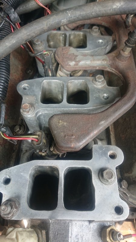

I would advise in not using the valve breather, and to just stick the pcv hose on the "in" side, and "out" side to where the pcv currently connects.
Also, which engine are you running? May not hurt to check intake for sludge/carbon and clean the crap out of it. My old upper looked ok, but when I pulled the lower, it has at least 1/8-1/4" of soot and sludge caked onto it, with two injectors at least partially blocked.
Also interesting to note, even running Mobil one with zddp additive like I do now, I still get synthetic oil sludge in the thing.
