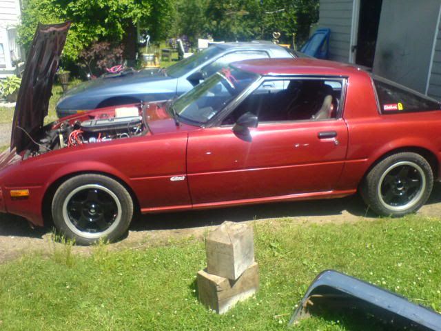

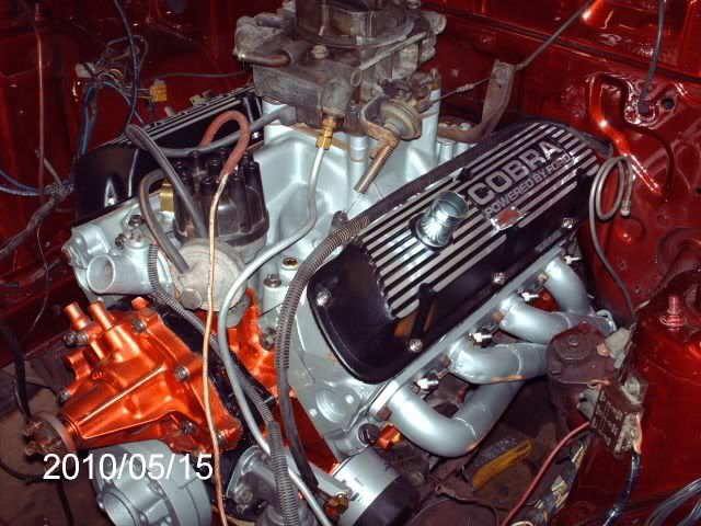

Oh, and two birds with one stone: Carbed Explorer engine in '85 RX7 :)

You can carb the Explorer engine if you choose.
