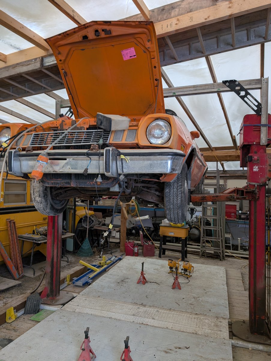

Finished it over lunch. Going for a snooze now...

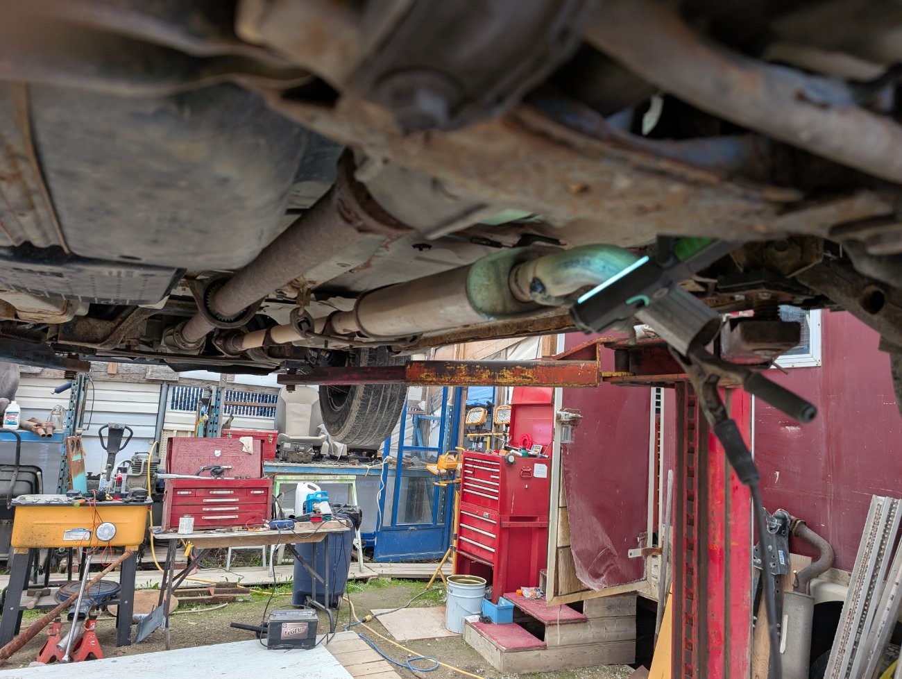

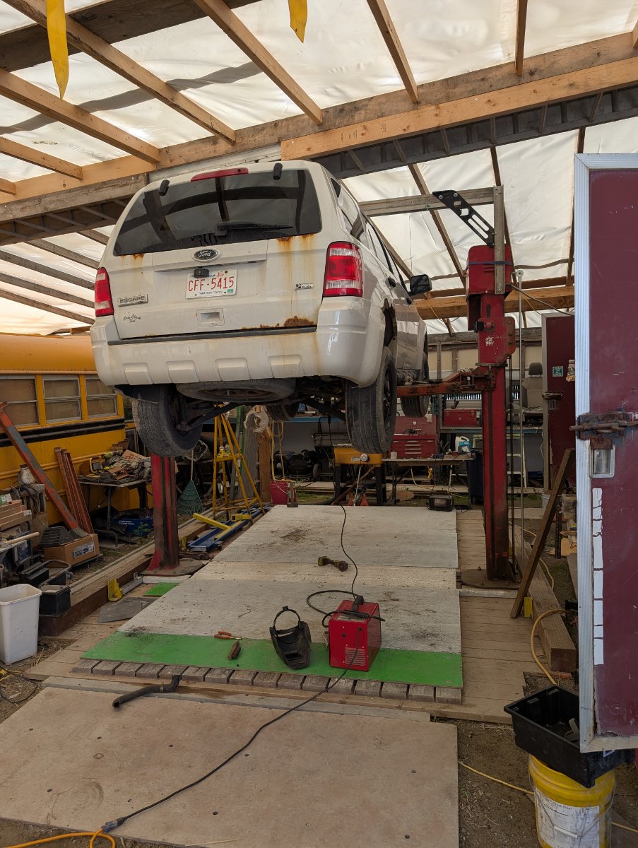

for sure its easy to die with these fawgin things.
especially working with vettes

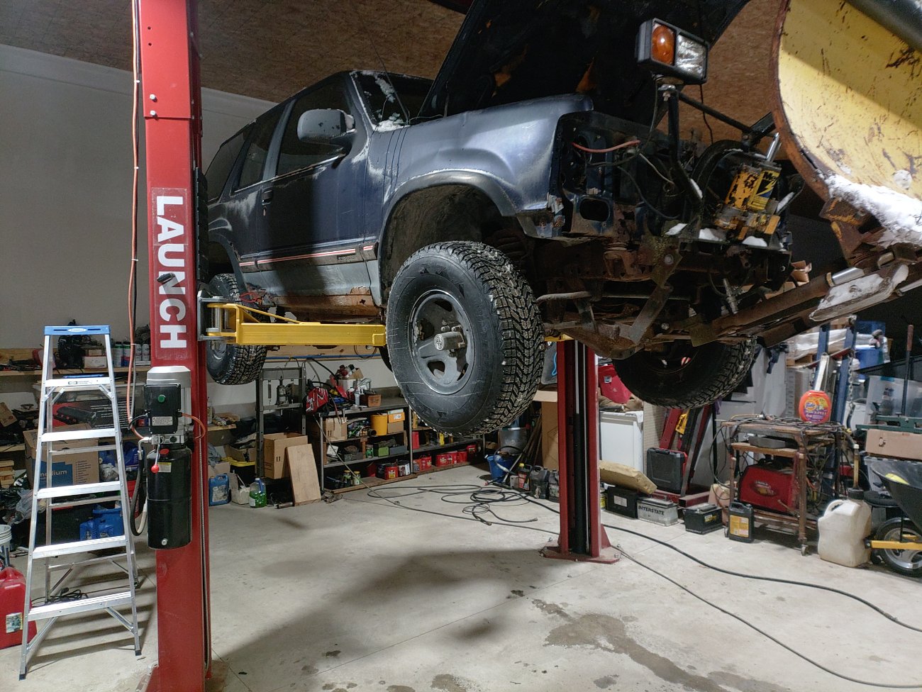

looks pretty good though....the 12k and 9 k have those spreaders but i dont like the 9 k...its tweaky...
the explorer was iffy on it with the plow.

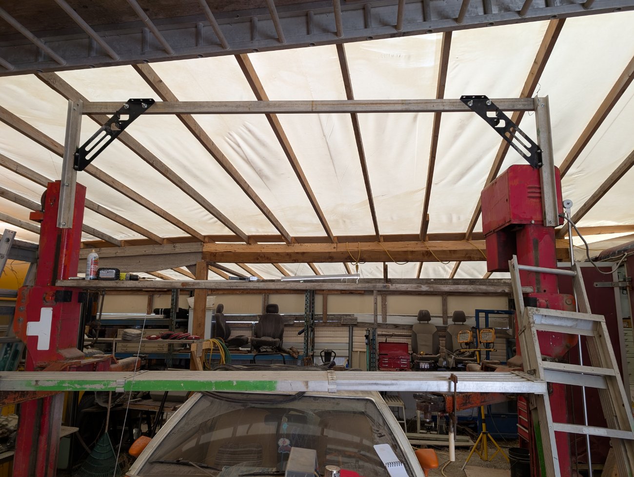

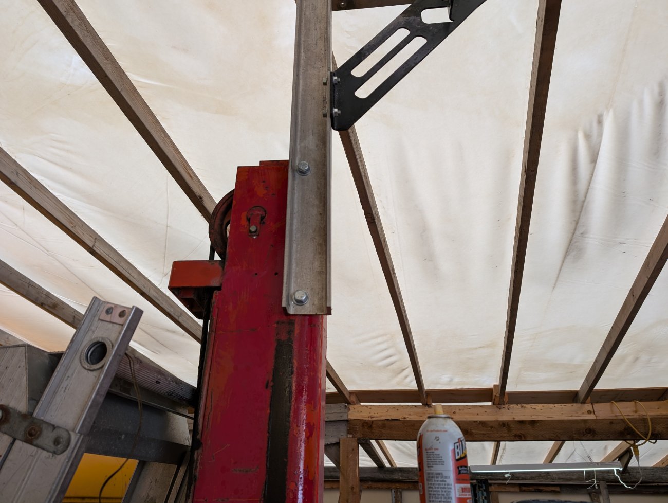

It's more like a flat plate. Your seems burlier.
Still...maybe line stake it too....
I told young Bob we might tie them into the ceiling yet.

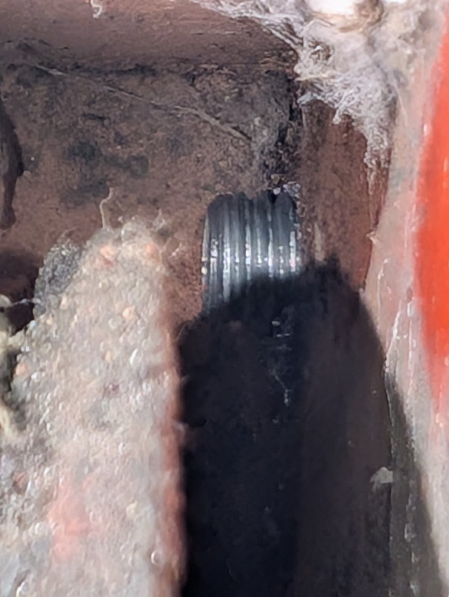

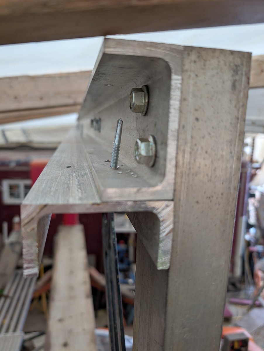

The last pic is of the end of the bolt after it passes thru the wall of the lift. It was tough tapping. I was worried I might break a tap.
@bobbywalter The wall of the lift is almost 1/2". It is well built. It's also an antique, iirc the company shut doors in the late 70's.
yes....it is burly unit you have there..
and your spreader is better than the one the l9 came with...
