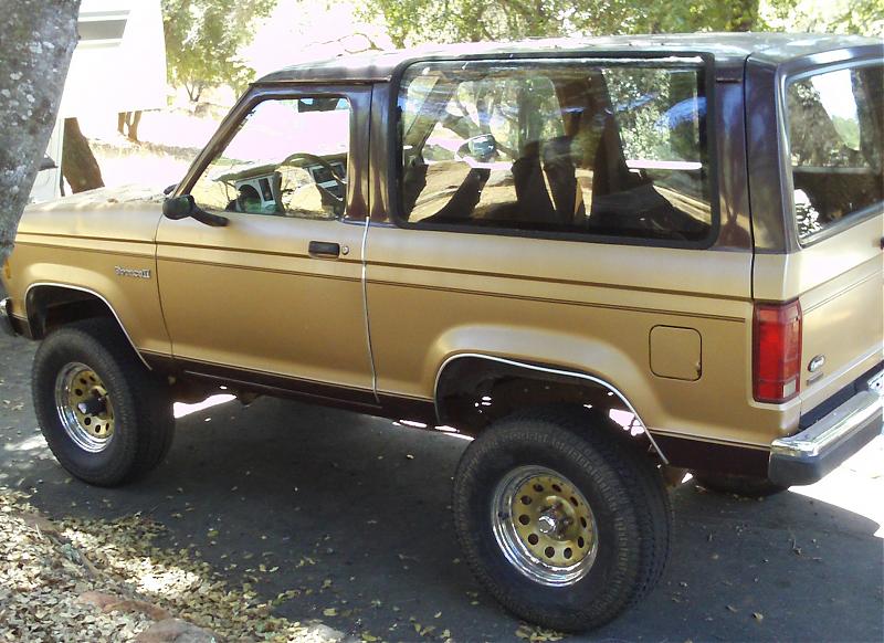

Can you tell if this is body or sus lift?

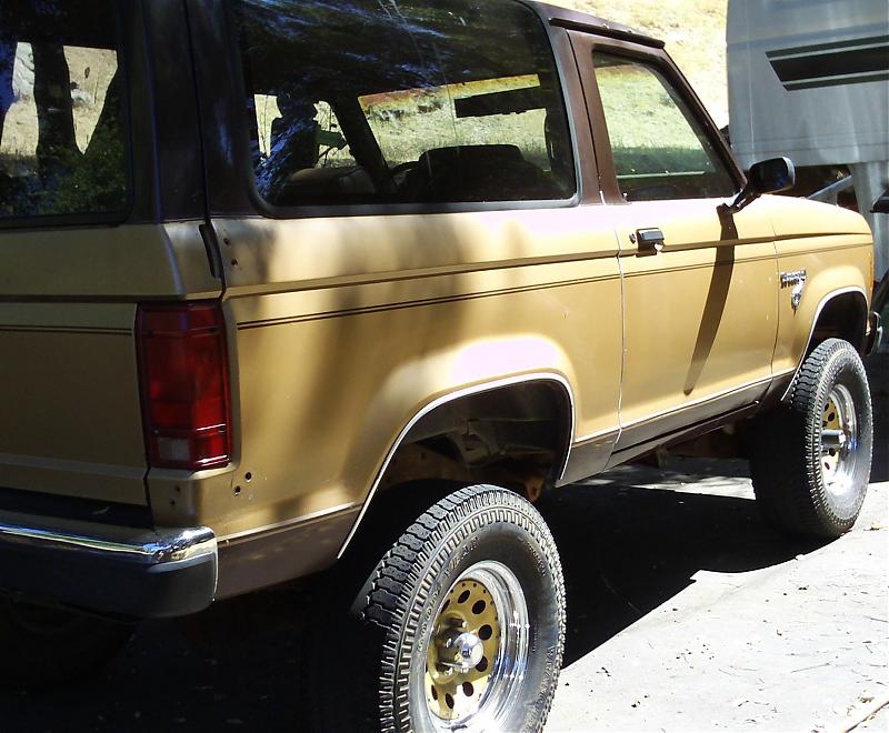

I just bought this bronco, runs great, have tire rack for back, previous owner said it was lifted 4" but not positive whether it was body or suspension. I looked it over quickly but didn't pay much attention to the lift on it. Was more concerned with operability, etc. Anyhow, I left the B2 at his house until I could trailer it vs. driving it because of valve gasket leak causing it to smoke a bit. Sat for 4 months. Didn't want to start a fire so trailer is better option.
This is an 86 B2 4x4 5sp
body or suspension lift? I know the pics don't show the undercarriage, I will post thos on sunday but let me know if there is any indicators just by looking at these pics. Thanks

That's a body lift. Unless it's smoking tremendously, a typical valve cover gasket leak is perfectly safe to drive.
Looks like a suspension lift to me. The radius arm crossmember is really far from the frame, indicating drop brackets. And it doesn't look like there's a gap between the body and frame.
Get a pic of the underside of the truck and we'll be able to tell you.
Maybe you're right. Been a while since I owned a B2, but I didn't think you could see that much frame under the body through the rear wheel well.
it may have a small body lift and a spacers and blocks but better pics will help
Yeah, it doesn't look like a bodylift to me, it's most likely suspension.

I'm with the crowd saying suspension when you toss some underside pics up we can all take a stab on how they went about lifting it.

update
It is a 4" Skyjacker suspension lift. Blocks in the back unfortunately. Will get the springs soon. If I were to buy springs from skyjacker for a 4" lift, would I need the factory blocks for the truck? I don't have them, so should I buy the 6" springs?
Will post pics soon.
you will need the 6 inch leafs to remove the factory block so yes buy the 6 inch leafs. its better to have no block anyway
There is no block on a BII. Get the 4" springs.
