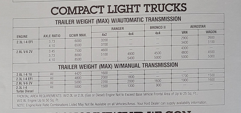

Can I tow with 1st gen ranger?
Circa 1985, same story...
Side note, it is amusing a BII is rated to tow 1k more than my wife's 2022 Bronco...
So an automatic lima can, in theory, outpull a manual 2.9?
lmao. right.
I see they dont even bother listing the 2.0
I doubt they put the power suckomatic behind the 2.0L, they were only like 70hp, don't think it can handle the parasitic load of an A4LD... plus all the 2L rangers had like no options...
Pretty lame that just because people can't drive makes a more capable vehicle less capable legally... I've towed 3k with my turbo ranger and it was fine, I mean I got like 11mpg or something dumb but you'll get that...
It's kinda funny towing the same trailer behind different vehicles... my HFT trailer behind the Geo Tracker I had it noticed, ranger not so much, F350 can't see it and it doesn't know even loaded with wood or something... trailer the Ranger doesn't like, explorer doesn't notice much and F350 doesn't care... The Explorer notices my ~3300lb boat but the F350 doesn't care...
Sorry. I didn't read the first page.
that picture is much easier to read.

Interesting, I could see that... I've been running a centerforce on my '90 for years and I replaced it when I rebuilt the trans but I didn't need to... I think the weights on the fingers help... but I don't make any power until 3k so that helps in that respect too...
