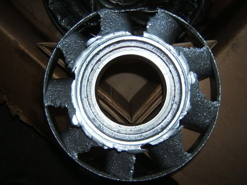

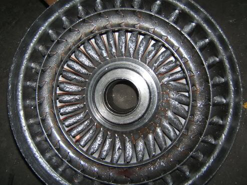

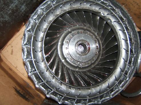

Yup... look at the inside of this torque converter.
30895
30896
30897
That looks strong to me!! :icon_rofl:
