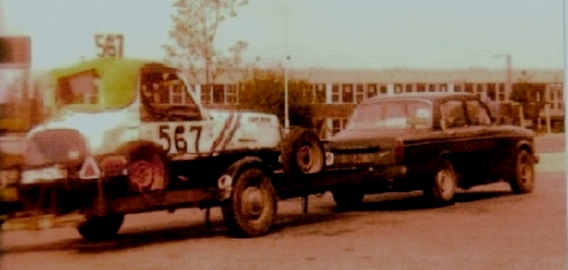

Try this on for size--little car, little trailer:
That isn't a little Ranger on the front of that thing, a travel home probably a little more forgiving on the weight balance than a 4 cylinder Ranger. At least without the side rails shown on your first trailer he could actually get out of the car. A properly balanced car trailer will pull better than a unbalanced lawn mower trailer that is tetering back and forth on the axle loading and unloading the rear of the truck. My dad's single bale hay cart does that, it ain't fun getting the crap shaken out of your truck over 20mph every time the stupid thing hits a bump.
