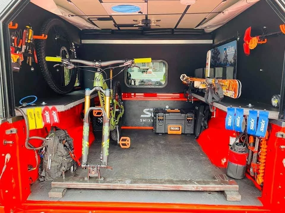

The Project M isn't a slide in... it's just a blank topper with a pop top. Weighs 377 lbs.
56980
I sure do like it... not sure I $10K like enough...
